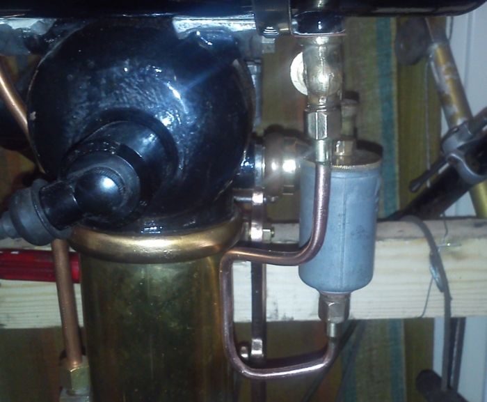

Any chance you can make up some of the fuel pipes Stelios? I note that Villiersparts (George?) now have the spigot nut: http://www.villiersparts.co.uk/carb.html
Motor looking good. What type of tank strap are you going to use?

Hi guys,

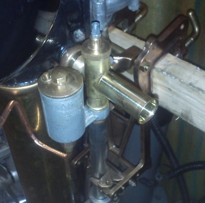

I would have done a proper presentation of my SD but I am waiting for a tap to make the carb trumpet.
No problem to make some pipes of any kind if you like Hugs
The straps will be as close to the original as they can be. I have found the type and they are already holding the tank.

Has John run out of the trumpets?

No I don't think John has run out of trumpets. Just my tension to try to make everything by hand. In case I fail I will get one from John.
OK I will try to make some fuel line this weekend to see what I could achieve.

A copper trumpet would go well but not authentic... hint hint

I chopped a tiller arm so I hope to be as close to the original as it can get!

All the parts are available to make the fuel pipes out of copper pipe, including ferrules etc. works out about £10 or so using the correct brass ferrules and nuts. The Later AC and AD had a different shape nickel plated pipe.

Wow nice bit of work Stelios. I like the way you hold the trumpet for tapping
