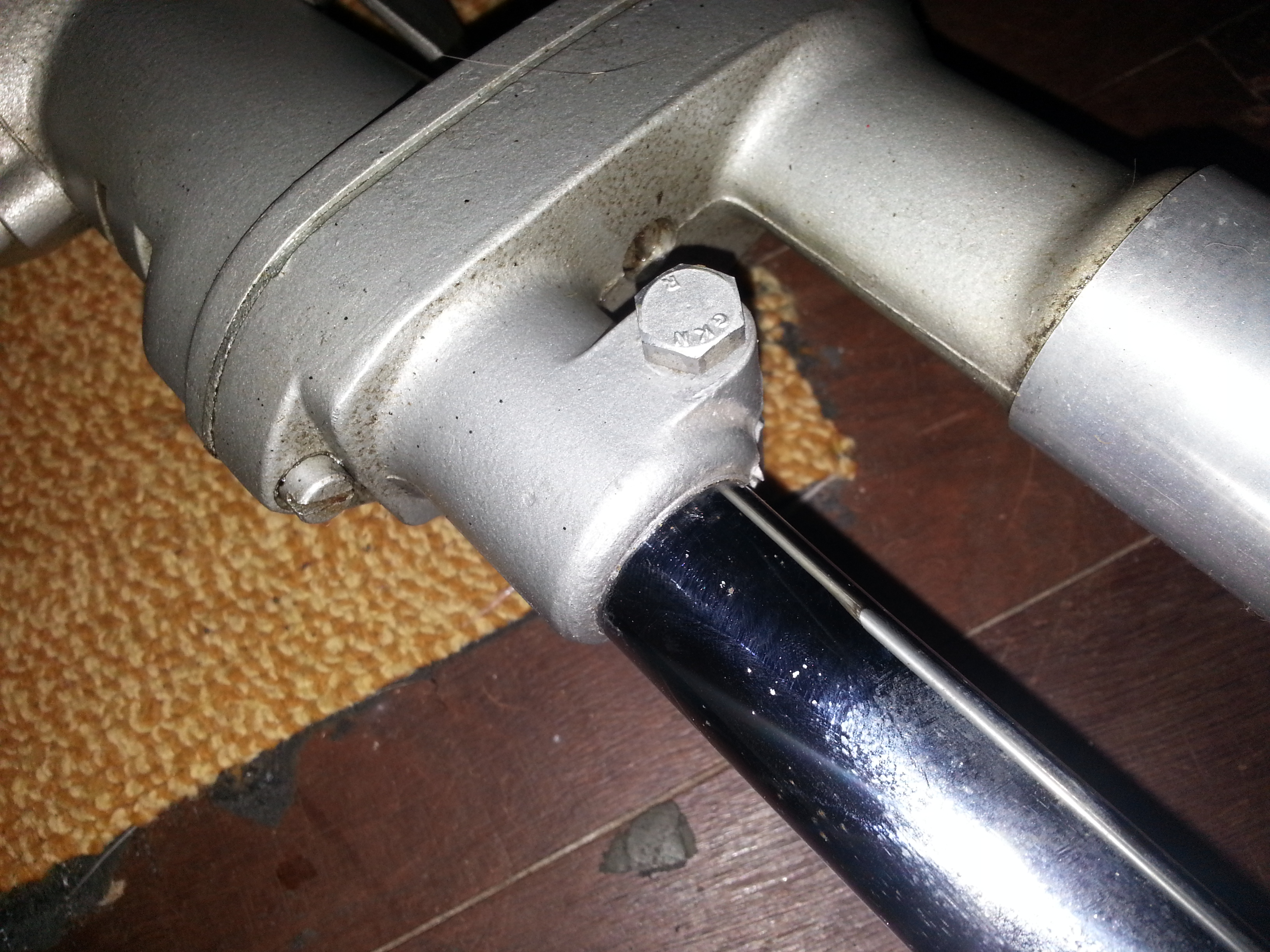

Just a caveat to anyone who gets the drive tube re-plated. I have had a few done, and used to supply a sketch of the tube to the platers, emphasising that the lower 2.1/2 inches should not be linished (abrasive belted), as this operation prior to plating can easily take too much metal off the diameter, to the extent that that it is no longer an interference fit in the water pump casting.

RickUK wrote:Just a caveat to anyone who gets the drive tube re-plated. I have had a few done, and used to supply a sketch of the tube to the platers, emphasising that the lower 2.1/2 inches should not be linished (abrasive belted), as this operation prior to plating can easily take too much metal off the diameter, to the extent that that it is no longer an interference fit in the water pump casting.
I fell fowl of "Deaf Ears" when I stressed that requirement.
http://www.classiccargurus.com.au/Vinci_Chrome
I ended up using brass shim stock to get the clamping required. You can not see the shim stock but I know it is there.
I use the motor very rarely and check it every time..........
Also there are rust pits coming through....... I think that they chromed over the thing in one hit. No Cu or Ni or....even a care at all.
Never going back to Vinci Chrome again.............too arrogant!
BnC[/color]
