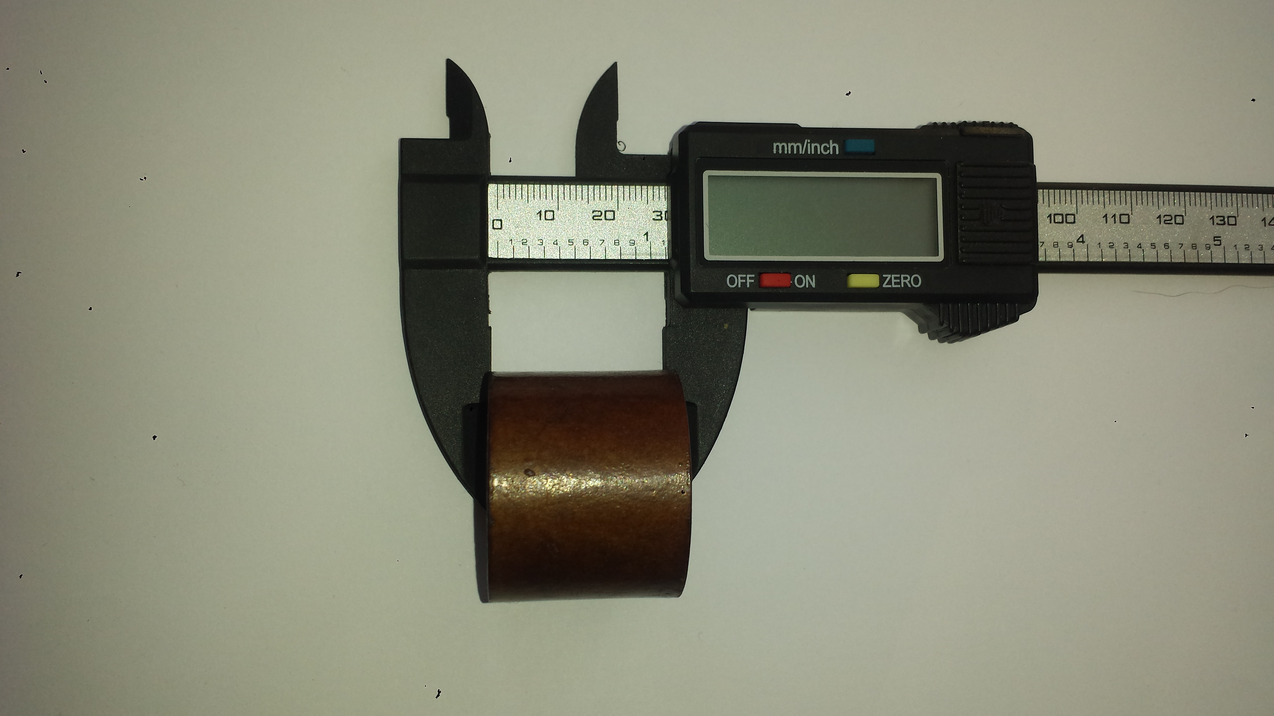

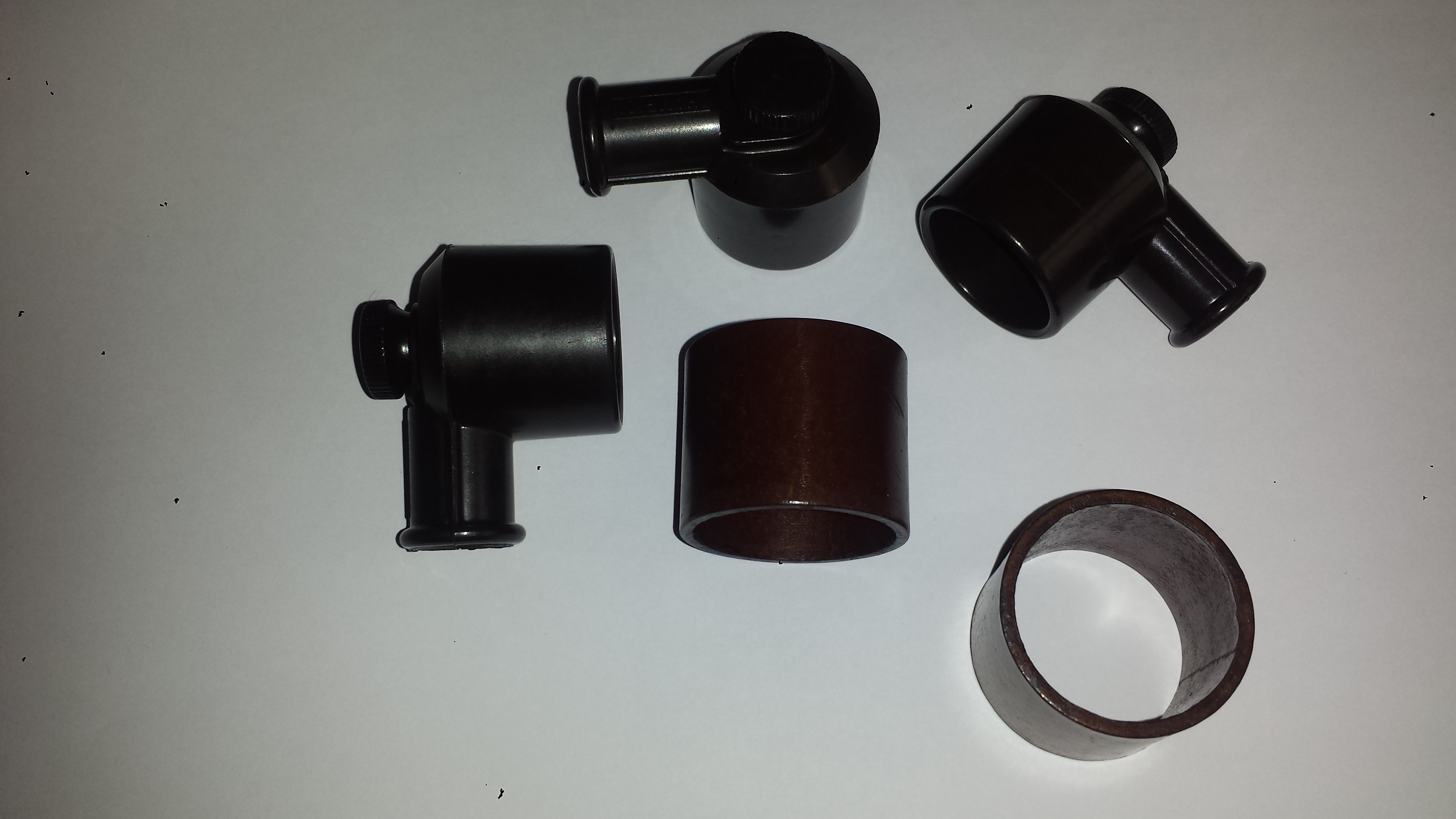

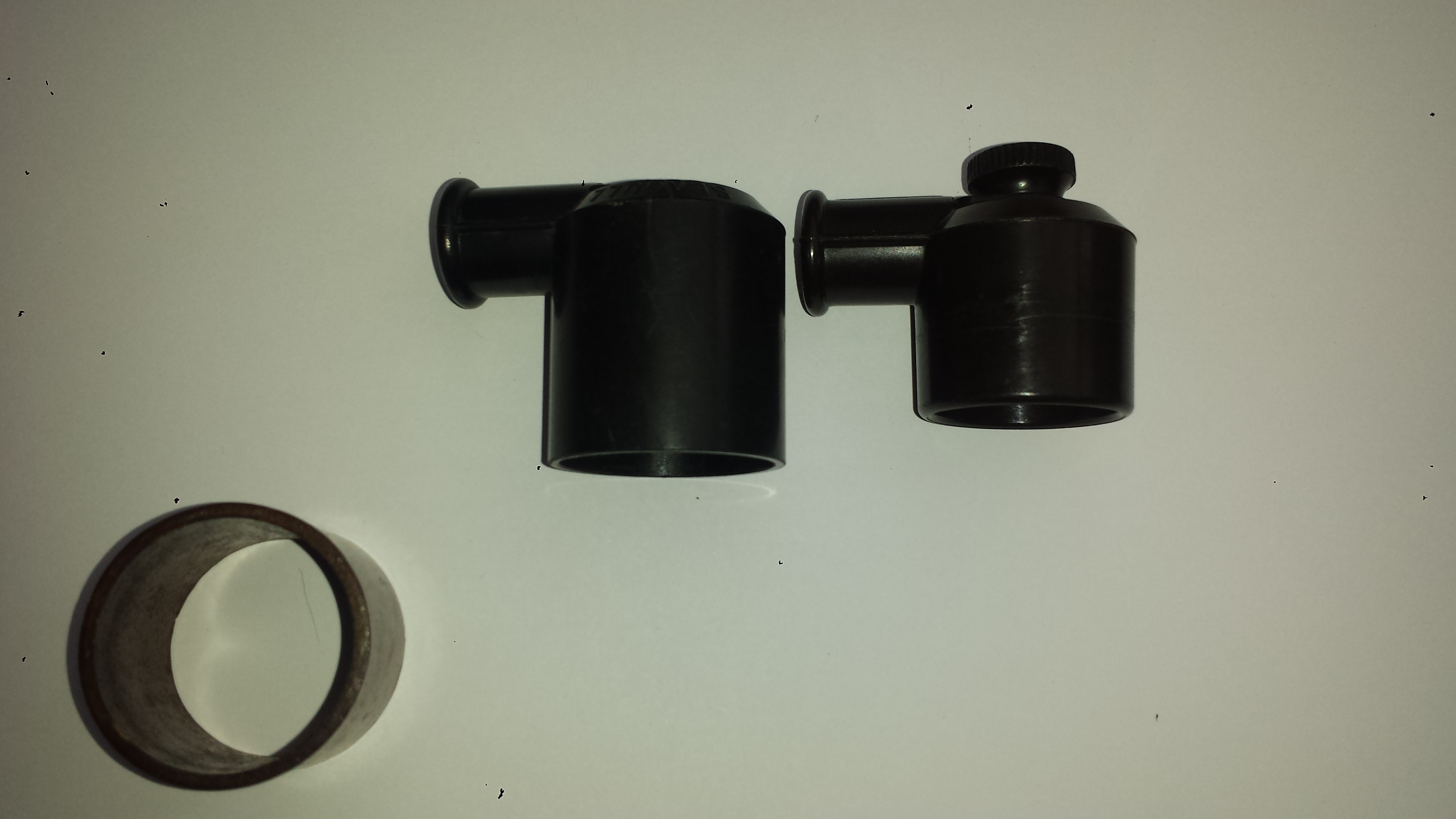

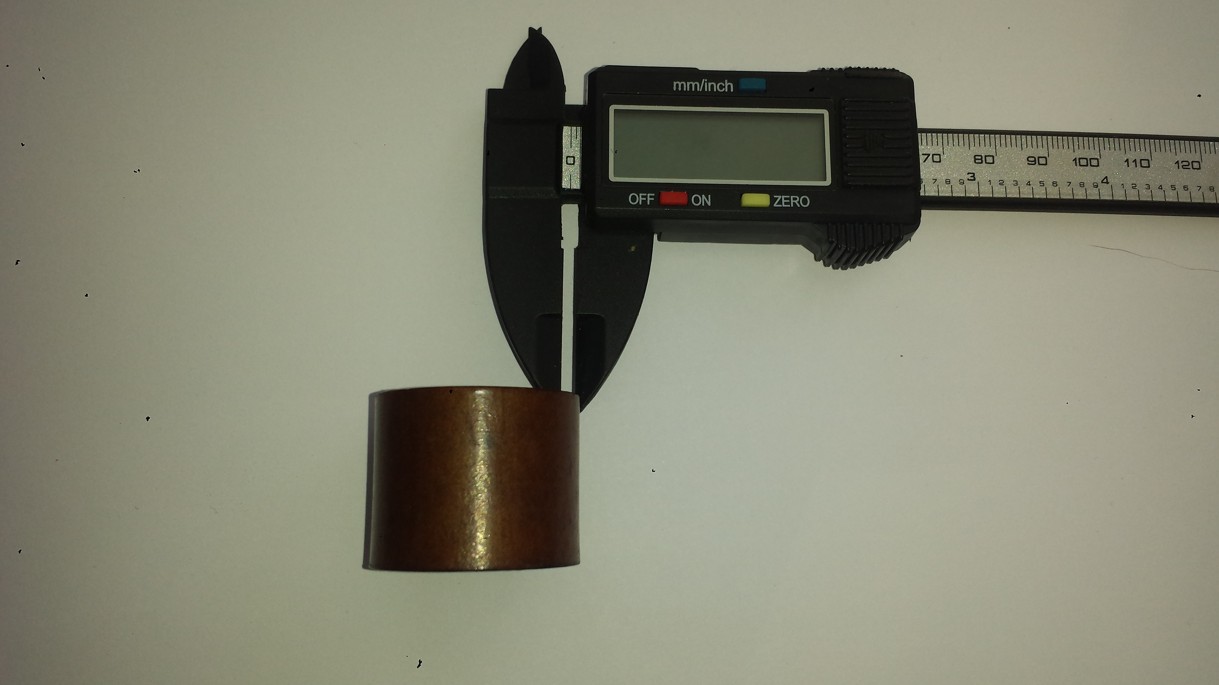

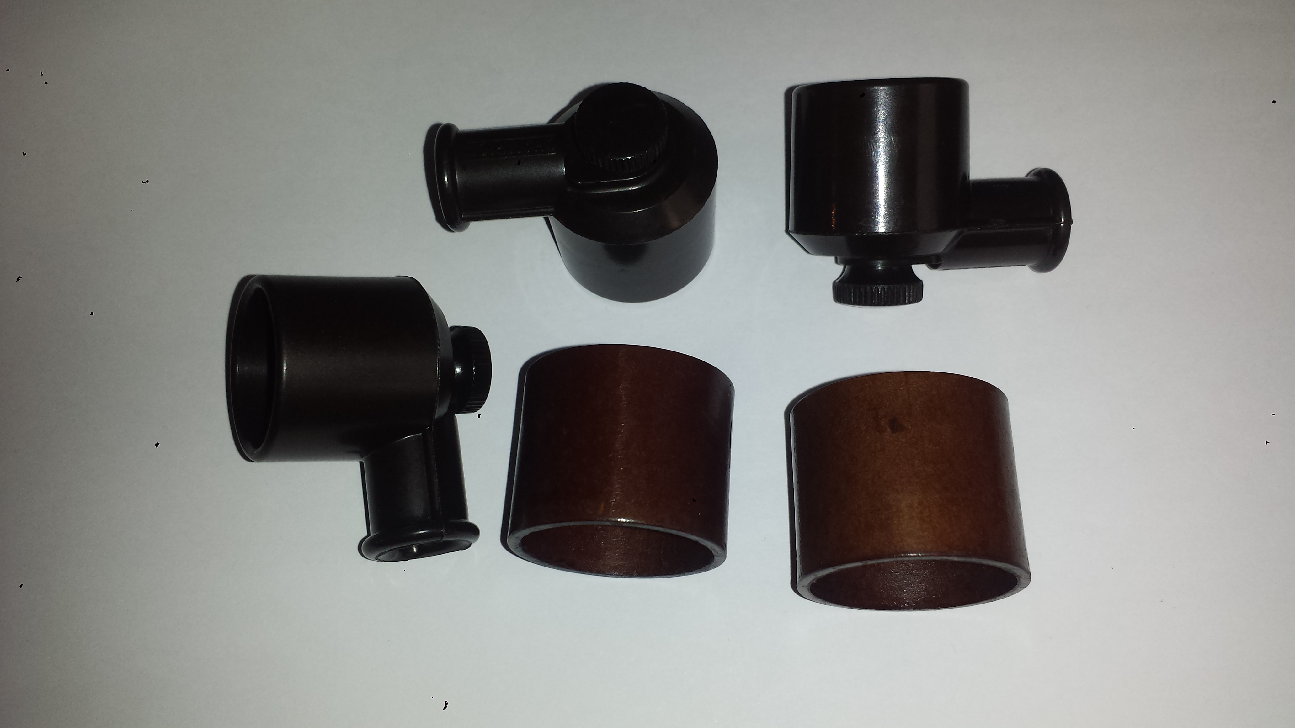

More detailed pic of 2 part plug cap and yes keith it could be tufnol tubeing. ....
Re: An FVP in USA
Interesting Tam, do they just pull apart?
It would be a lot better if them caps were not so hard to get hold off, I have some, but they are getting harder and more expensive all the time.
What's the spec of them tubes Tam, I may make one or two, as I haven't got any of this style.
Re: An FVP in USA
Yes keith they just pull apart hope these pics make sense dead battery in caliper I'm thinking they where made for other uses (probably old skool bike)although iv never seen the extended cap anywhere else other than the seagull mybe bad design for outboards...
Re: An FVP in USA
Only 1/4 of an inch in lenth in difference. ....but then again ask any woman that's a big difference :lol: :lol:

No pm this end china. ......

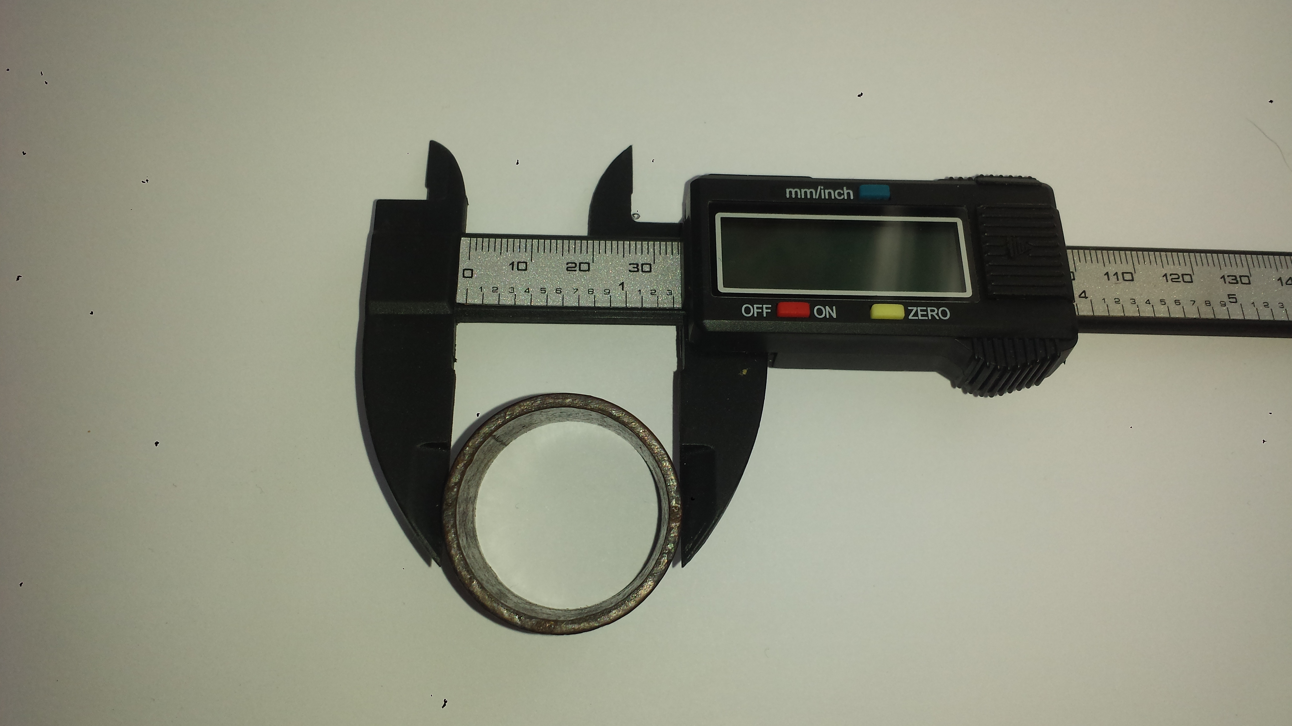

Well that was useful, You could have turned the vernier on.
No matter, I have my own plugs, so I know what ID I need.
Re: An FVP in USA
Keith.P wrote:Well that was useful, You could have turned the vernier on.
Dead battery in caliper if you enlarge the pic you'll see the size......china...
