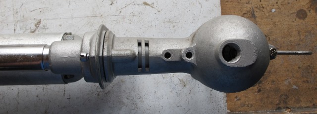

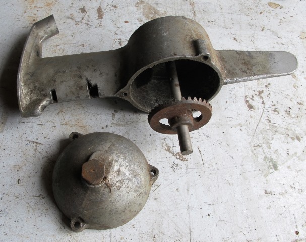

The drive tube cup is a tad small for the drive tube on my bitsa motor, why?

The motor and its power leg have now been hung up to rest for a while, I will await the arrival of suitable spare parts to do the additions required to make this a usable Seagull outboard.

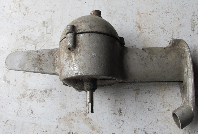

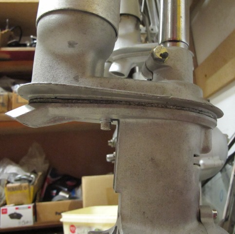

The gear box lower flange was bent, check the picture, how and why do people do such a thing? I am not happy to try and bend it back cold, I can use heat but how much?
I do not have a propellor, which one will suit the gear box and a 102 series motor, the maximum diameter would be say 8.5" inches?

Decision time Roy
As things stand now, this would be the type of prop you need for your 102 bitsa
https://www.ebay.co.uk/itm/Seagull-Outb ... SwImRYjzjK
Alternatively you could also revert back to a more conventional 102 gearbox and prop. Easy either way and plenty to choose from.
The reason your thrust block doesn't quite fit snugly with the torque tube is because you have the thicker style of torque tube. Basically you're using the older type of transom clamp/thrust block which works better with thinner sectioned torque tubes found on older seagulls . A more modern looking thrust block might fit a bit better and accommodate the thicker dimensions of the torque tube.
Like this one.
https://www.ebay.co.uk/itm/BRITISH-SEAG ... SwN3NcBbP8
This will fit onto the bracket you currently have been using.
Or you could use one of these
https://www.ebay.co.uk/itm/BRITISH-SEAG ... SwJFBcMhib
The only part you'd still need is what i call the rubber donut that fits around the torque tube and engages with thrust block of this modern transom clamp. In a perfect world you'd generally see these types of clamps with motors that have a reverse gear. Seeing as this motor of yours is a bitsa i guess anything goes.
As for the pump housing to gearbox flange, is there a gasket currently fitted in there? The gap i can see in the pics isn't really in a critical area as this is mainly where the exhaust gasses come out. If you do decide to try and bend this straight go gently with it. They are fragile.The important area to consider is around the impeller area. This does need to have a good seal around here. If once it's all back together and you still see a gap between the 2 flanges, i find a smear of rtv fills the gaps well enough to keep the wolf from the door.
Do you have all the screws and fittings for the gearbox? I notice there's a few holes with nothing in them!

This lower unit was never used on a 102 & will give you some problems making it fit.
The only prop that I can think of for your application is the 4 bladed weed free used on the model 75 & the Curlew.
Did you bead blast that lower unit as they are normally painted.
Can you take a picture of the lower unit with the water pump gasket in place.
As for putting a 4:1 century plus prop on a 2.5:1 lower unit.

Isn't the clue in the part number CPC 1409 W for the Century plus, 10.75" diameter
Whereas the 2.5:1 prop part number for the spring drive is C100 1409 for the model 75/curlew, 8" ish diameter
I agree it does look like a 75 prop but £50 & the postage to SA could be a expensive mistake!
As sealed boxes have different length drive shafts, Tam's suggestion is a real good one.
I asked the bead blasting question as oil seals don't last well on the surface that leaves.

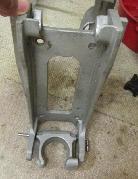

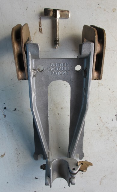

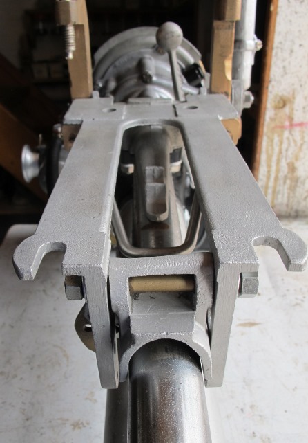

Is my picture number one the correct way to fit and use the alloy saddle ?blokewithaboat wrote:Decision time Roy

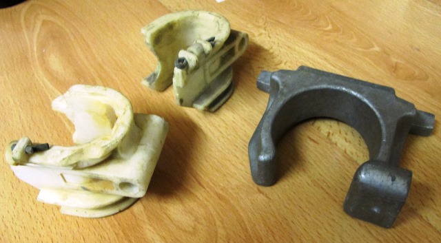

The advice on the drive shaft leg support shows me that I have two (part broken ) plastic supports, also an alloy one, it it Seagull though? Its too wide to fit the engine mount that I have right now.

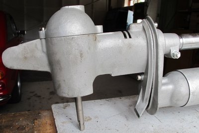

The gearbox that I have with the bent lower case will seal around the water pump area, I can easily seal the gap aft with some silicone sealant.
Note, I am now back looking at the original sized gear box that a 102 motor would use, the reason is there is a suitable five blade prop that will match it.
This solves what may be the hardest item to source being the propellor.
