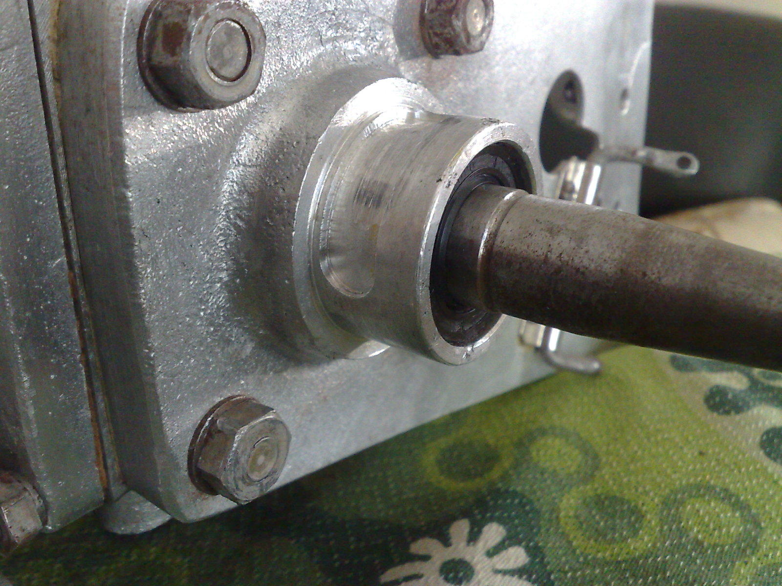

A little bit more progress on the Sportsman this weekend.
Magneto has been fully rebuilt and all parts have been hit with a couple coats of etch primer. Here's a few pics of where we finished up, starting with the magneto.
As you would expect with aluminium castings of that era, they are not the best. Here's a close up of some of the imperfections. Plan is to fill with blade putty, sand back, apply a high build primer, sand back and attend to any left over pin holes etc blade putty. Following that a final sand and we should be right for the top coat.
Still a way to go yet before it's completed, but we're getting there slowly.
