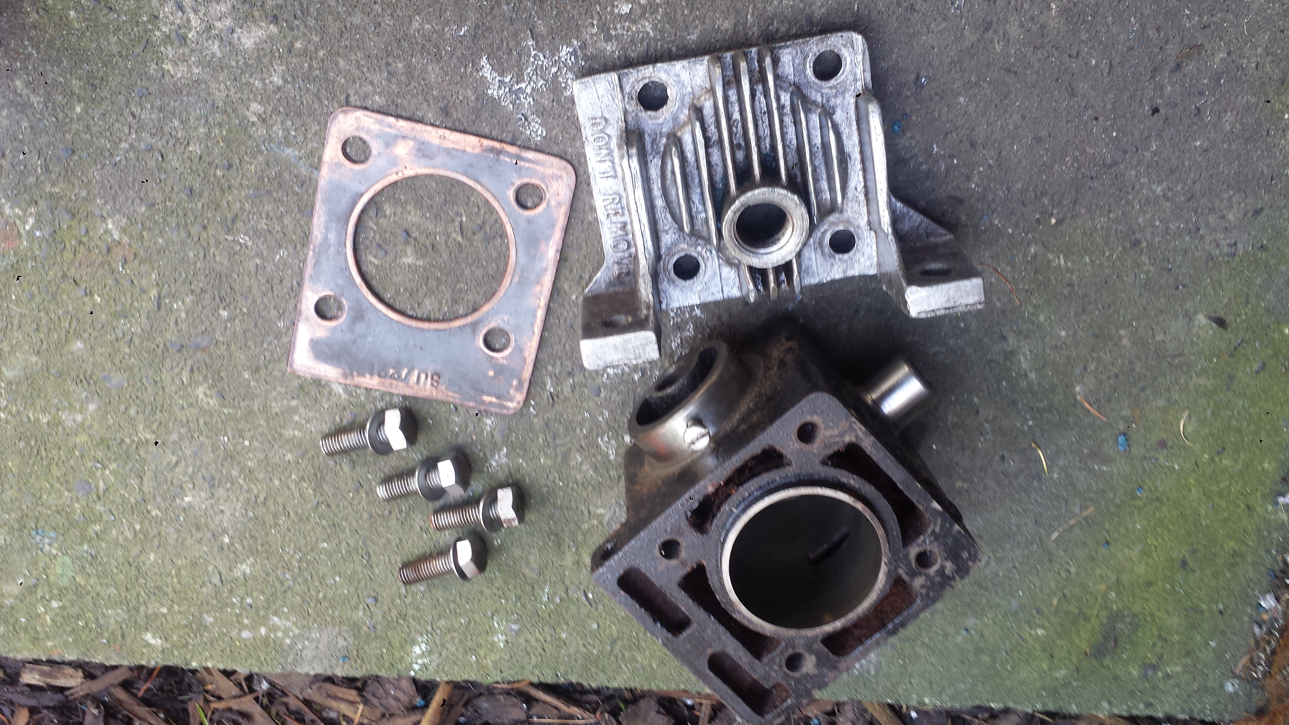

"Bruce,
Ref head/ Studs. The non hollow raised portion is typical on all FV/FVPs that I have seen. . (The first 1200 (very very approx) are slightly different. I think that the raised area around the studs is quite correct. Exactly what happened when the LS head was introduced i am not sure, but it would be understandable if the same design (in this area) was carried forward from the FV/FVPs, which is what I expect happened. Tam's late LS37902, rather suggests that was the case.
If the wrong part (ie a head) has been fitted onto an engine, it is far far more likely to be a later, more numerous part that has been fitted, rather than an earlier, rarer part.
My money is on LS37902 having its original specification head.
Jeremy"

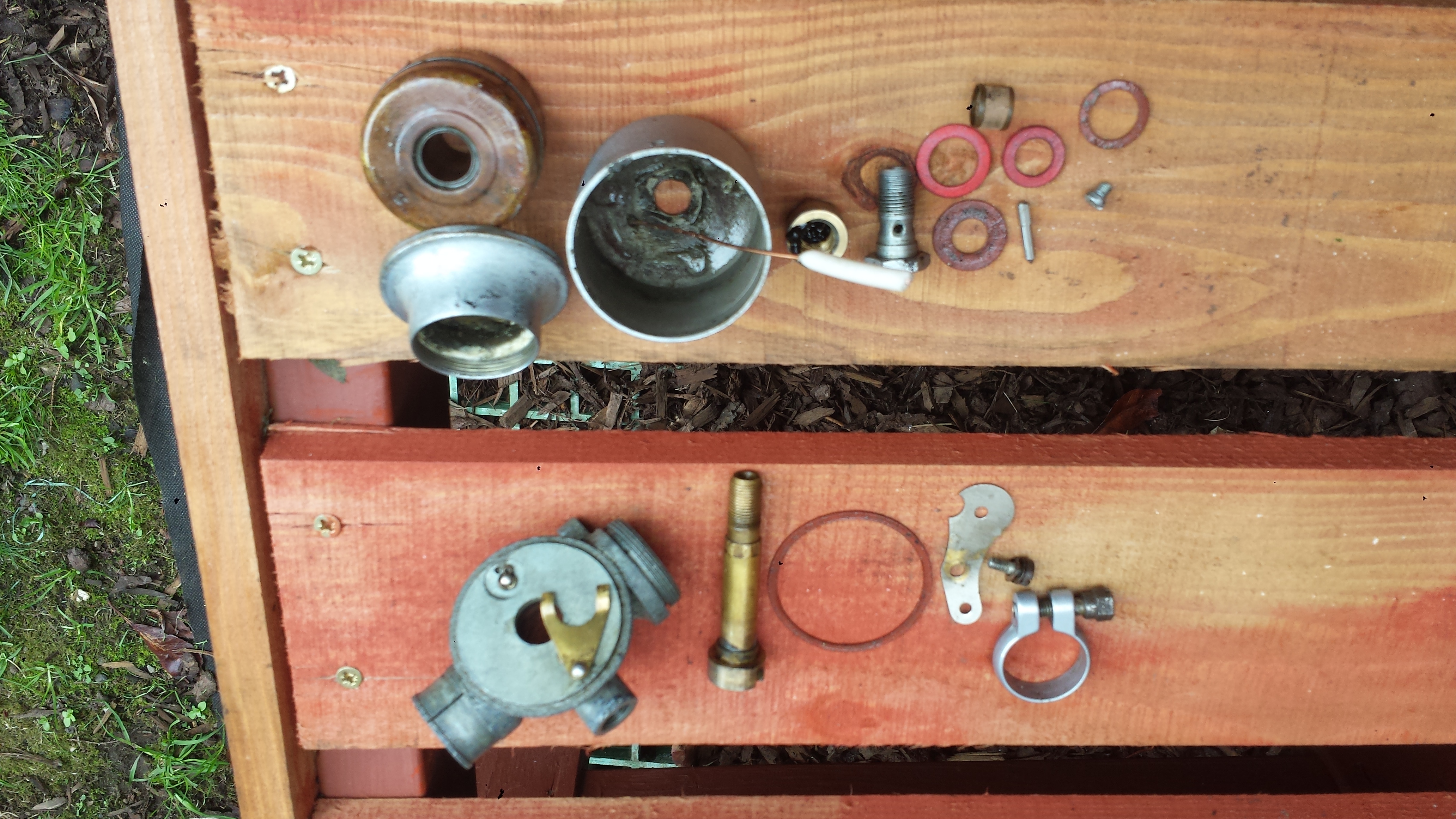

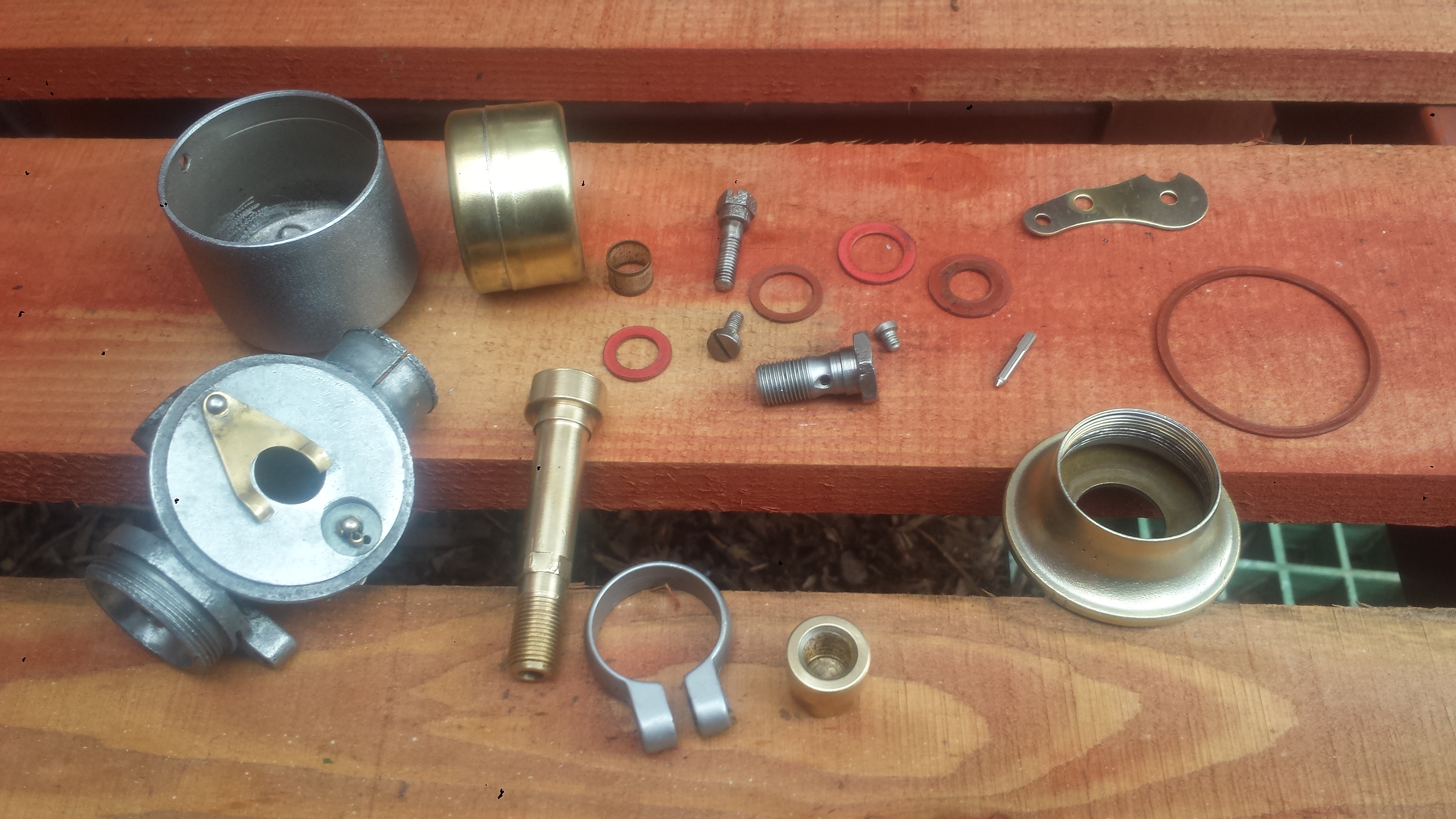

Re: Little Forty
Tam, are you missing a part on that carburettor, I thought they had a washer between the carb body and main jet?
tambikerboy
- Posts: 306
Re: Little Forty
Pass on that one china never noticed a washer between carb body and main jet (been wrong before ) mybe it's time i reported back to specsavers last time i was asked if i could read the sign on the door (yes exit)
