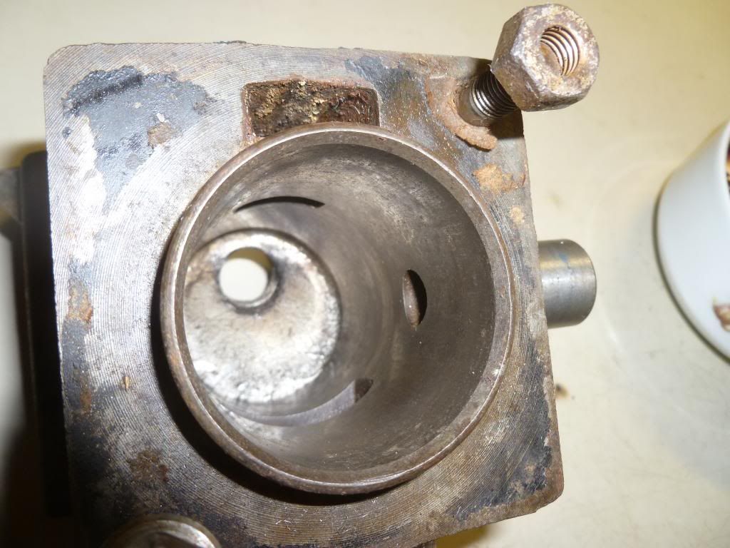

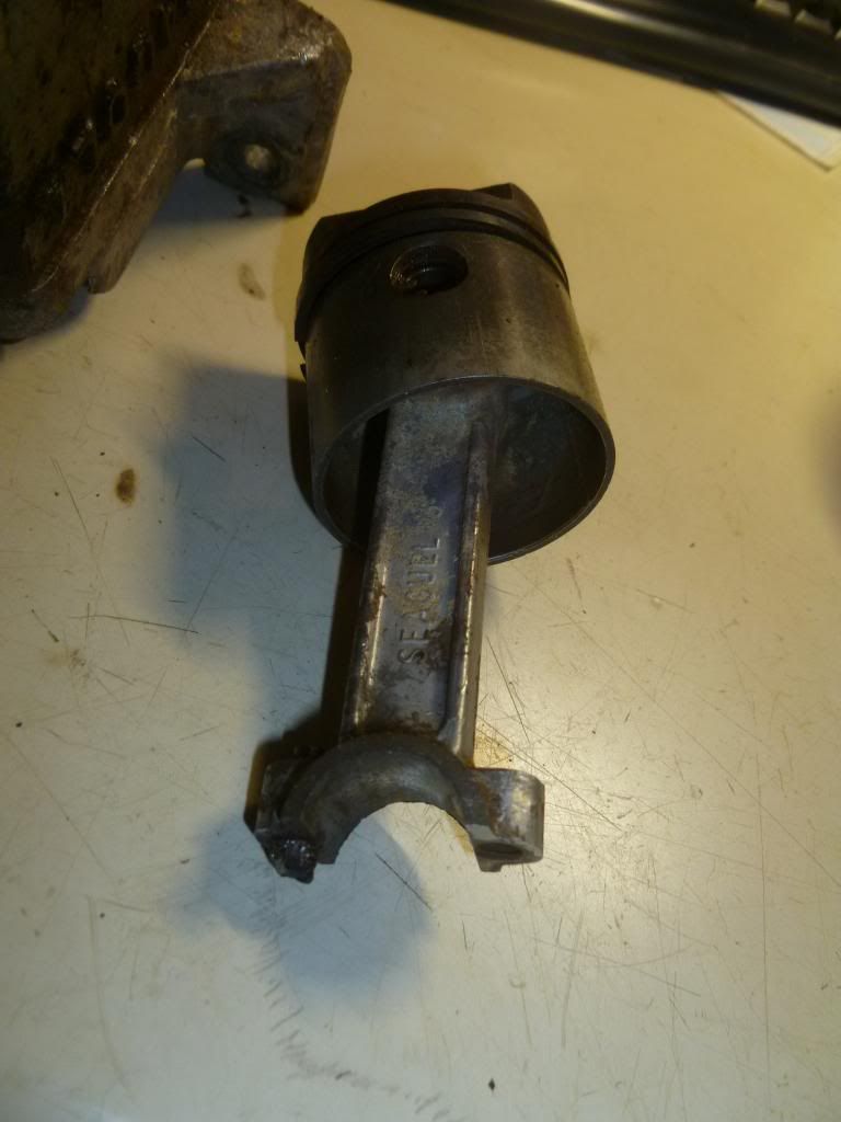

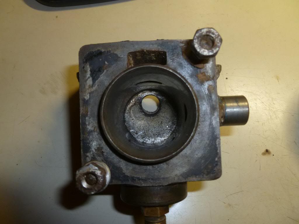

I managed to take the piston out of the bore! Hooray!! Now I have a crankcase, crank assembly and bore that work!
What I did. Heat (a lot), one day soaking in the petrol, various lubricants, hitting with a hammer but always there was a piece of wood between the hammer and the piston.
At the final stage a place a round piece of wood in the big end and hit it. At that time the piston start moving. I risk damaging the piston and the con rod but I didn't care a lot as I already have one broken screw in the con rod. The funny thing is that by the time the piston came out with some lubricant and a little play the rings start moving free.
The bore were cleaned with lubricant and wire wool.
After some heating etc I manage to take out the broken screw. I haven't tried the crank assembly that was originally stuck in that cylinder. With a spare crank assembly, a magneto and the original crankcase I made the power head. Add some oil in and turned it. It was a little bit stiff. I mount a carb and a DIY tank and tried to start it. After some pulls it started!! I didn't let it run for more than 3 minutes as I don't have a copper gasket and the one I made (correct thickness) doesn't allow thermal exchange. So the power head run for around 15minutes in total.
After that no stiffness! Now when you turn the flywheel it feels pretty normal and free.
Some pictures..
