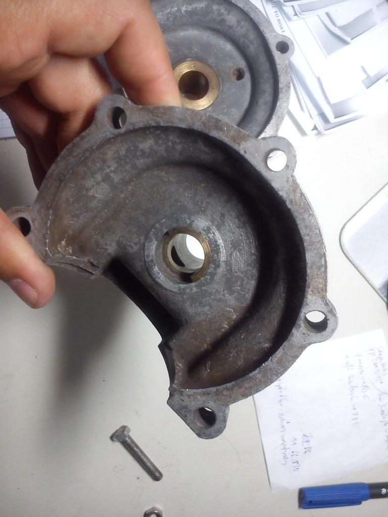

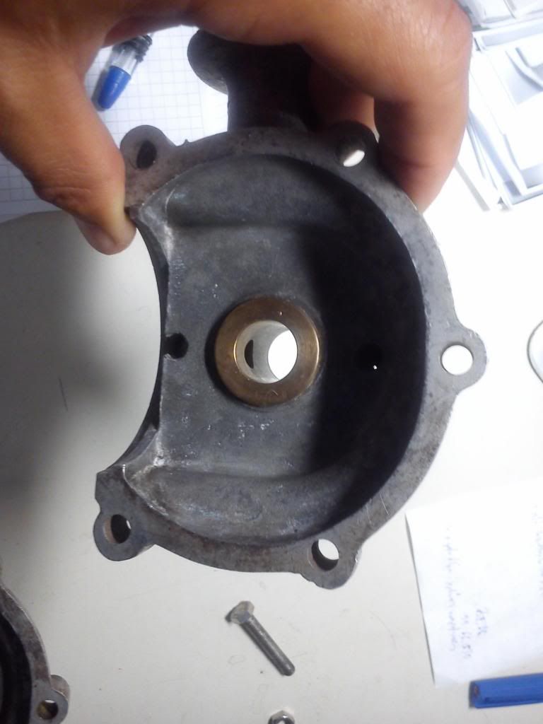

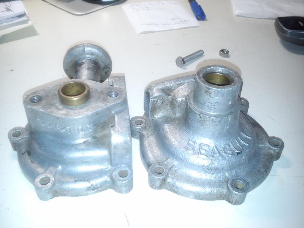

Does anyone have an open SD crankcase, so that they can take pics of the bearings, to show how different they are?

Pictures on the way...

Upper..
Lower..
Both..
On the lower case the hole of the bush is blind. Shouldn't have been drilled the crankcase to let oil go through the hole of the bush?
It's a spare crankcase but with matters..
I also have two sets of bushes from silver centuries if those could be of any use to anyone.
