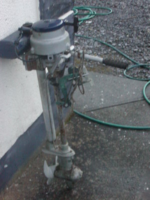

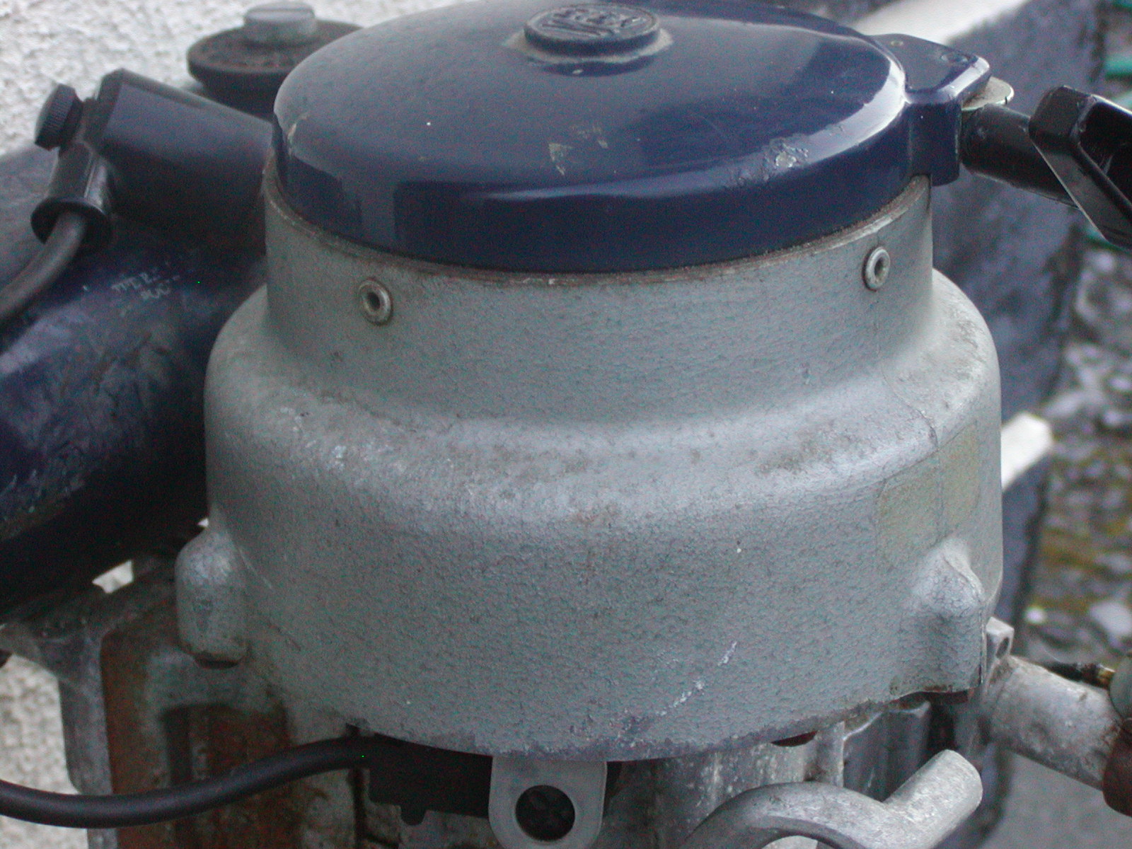

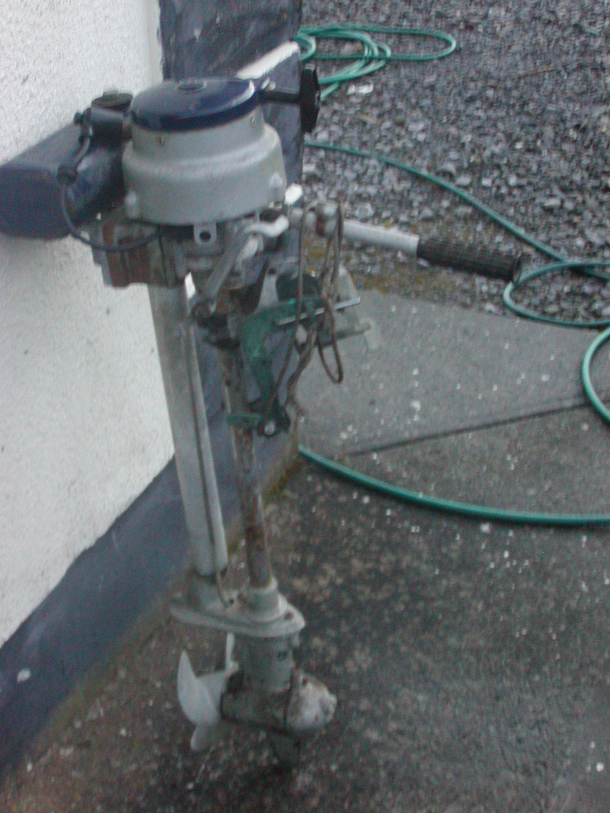

Morning all.
I have just got an old seagull serial FPC 1723AA9 Jan 1979. There is no spark at the plug and someone has suggested it my be the points that are the problem. Are the points located in the same compartment as the pull cord and do I have drill out the rivets to get access to the points. If I'm taking off this cover there are no components that may "spring" out Please attachments seagull and seagull1 which may explain the problem more clearly. Any information that could be provided to this problem would be appreciated.
Malachy from Galway
Malachy from Galway
Re: No spark
Its just the same as a normal seagull, if you take off the recoil cover you will see a flywheel with a cone on top of the flywheel, depending on which flywheel you have, you may have to remove the cone to gain access to the points.
Clean the points and try again.

Thanks for the reply. It's getting recoil cover off that's the problem as it appear quite solidly secured . Do the rivets have to be drilled out.

Unscrew the 3 x 1/4" bsf bolts holding the flywheel cover in position, the recoil & cover will lift off, there are two holes in the top of your flywheel which will give access to the points, clean twice & set to 20 thou or 0.5mm.

Thanks for all the advice. I just realised that the 3 screws holding the recoil cover in place are underneath the casing and require a 12 mil spanner. Next time I will be more observant. I leave looking at the points until tomorrow as I'm currently at work and don't have access to a feeler gauge.
