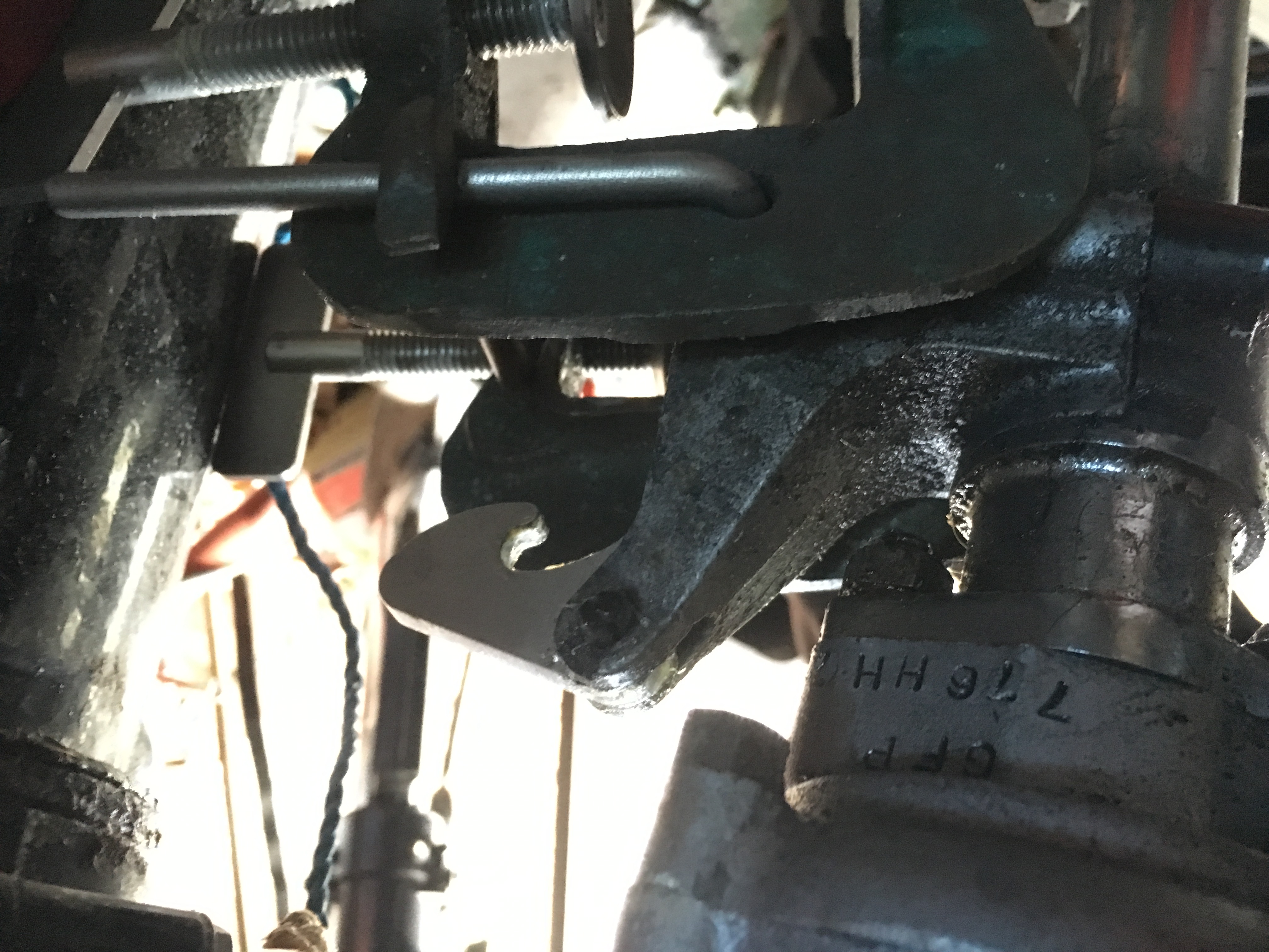

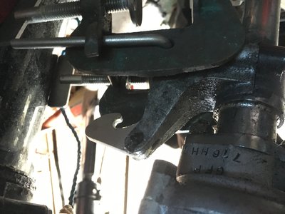

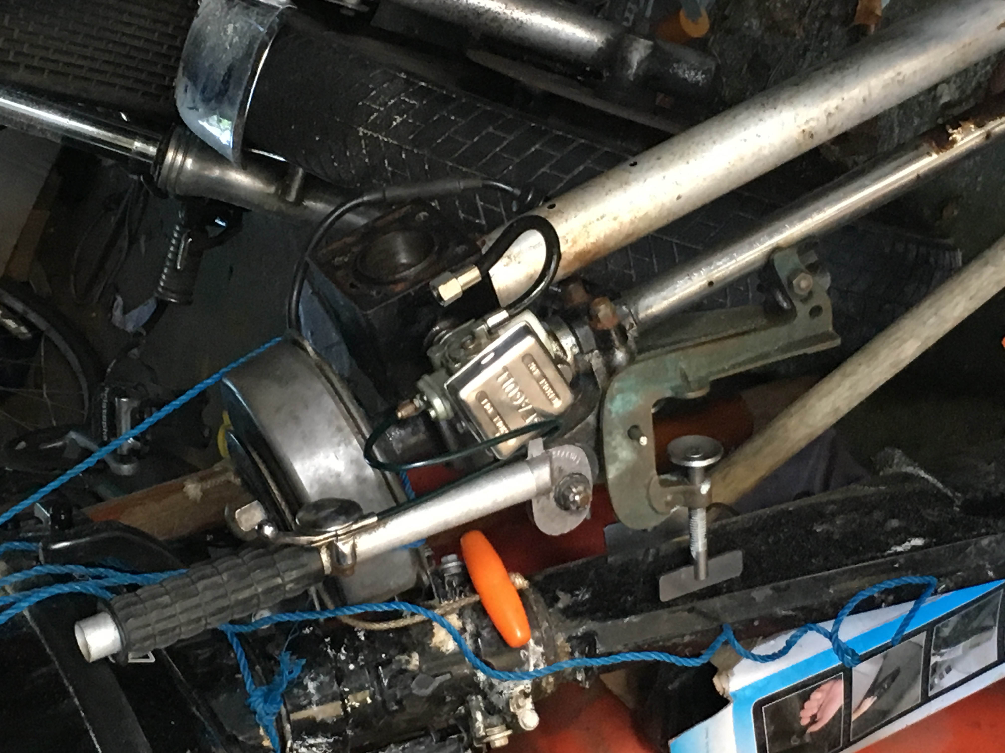

As promised some pictures; here she is head and tank removed.
Note the new stainless clamps and "hook" from SOS.

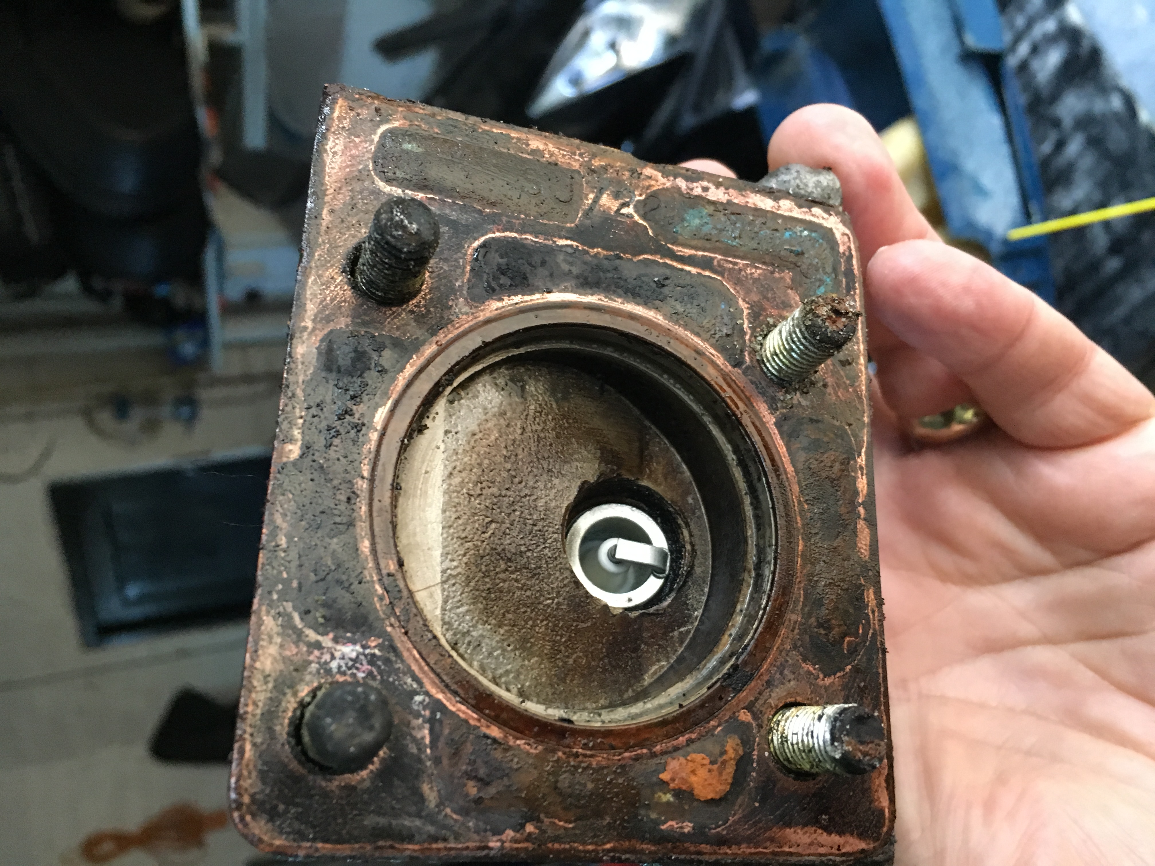

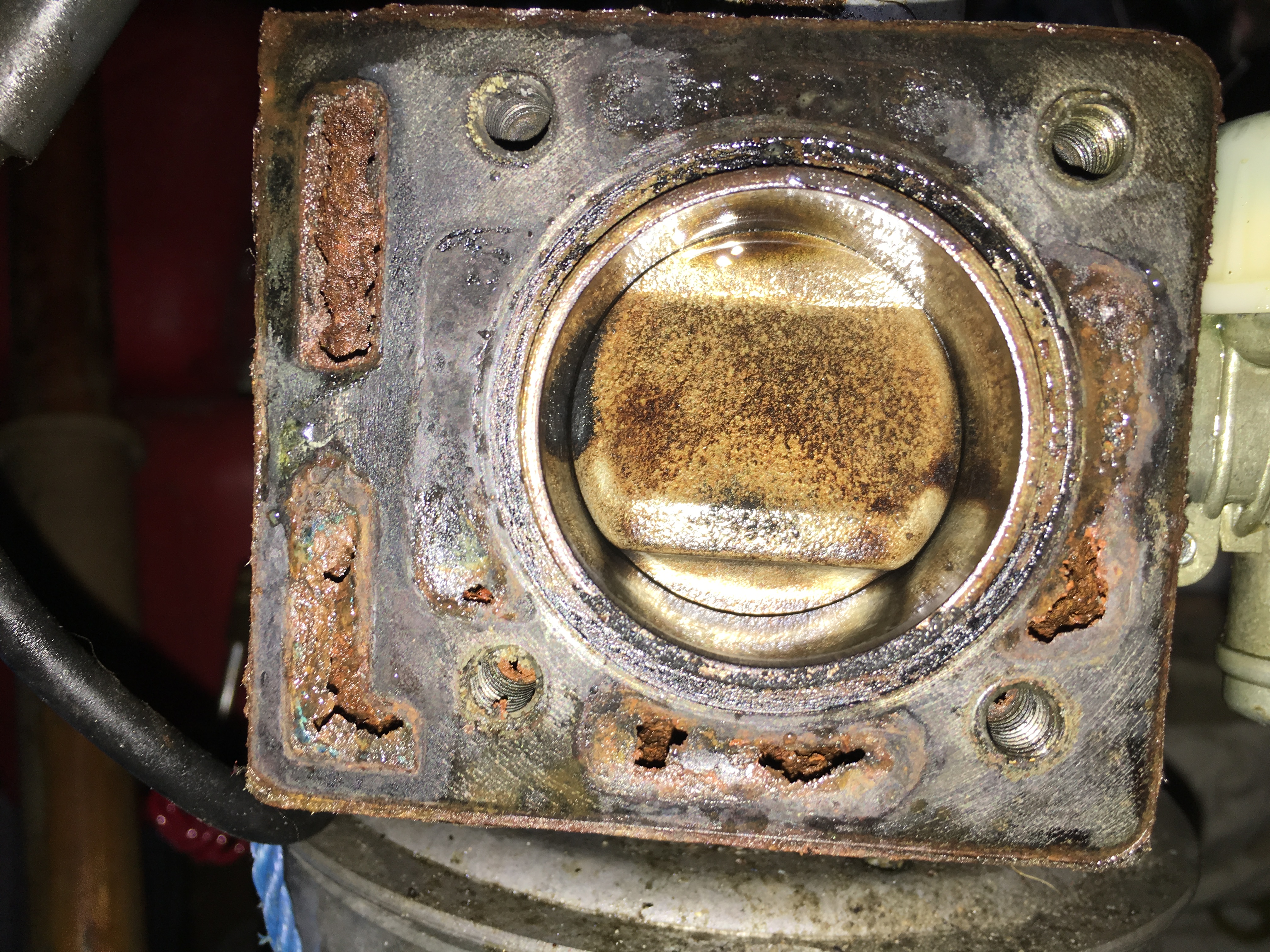

I got round to removing the head this lunchtime having sprayed everything in penetrating oil for a couple of evenings. Came apart easy with no heat required.
To my un-tutored eye the head looks okay. No carbon at all. The bore looks clean also with no obvious scores.
The water jacket looks pretty solid with rusty gunk so well worth getting the head of and having a poke around in there.

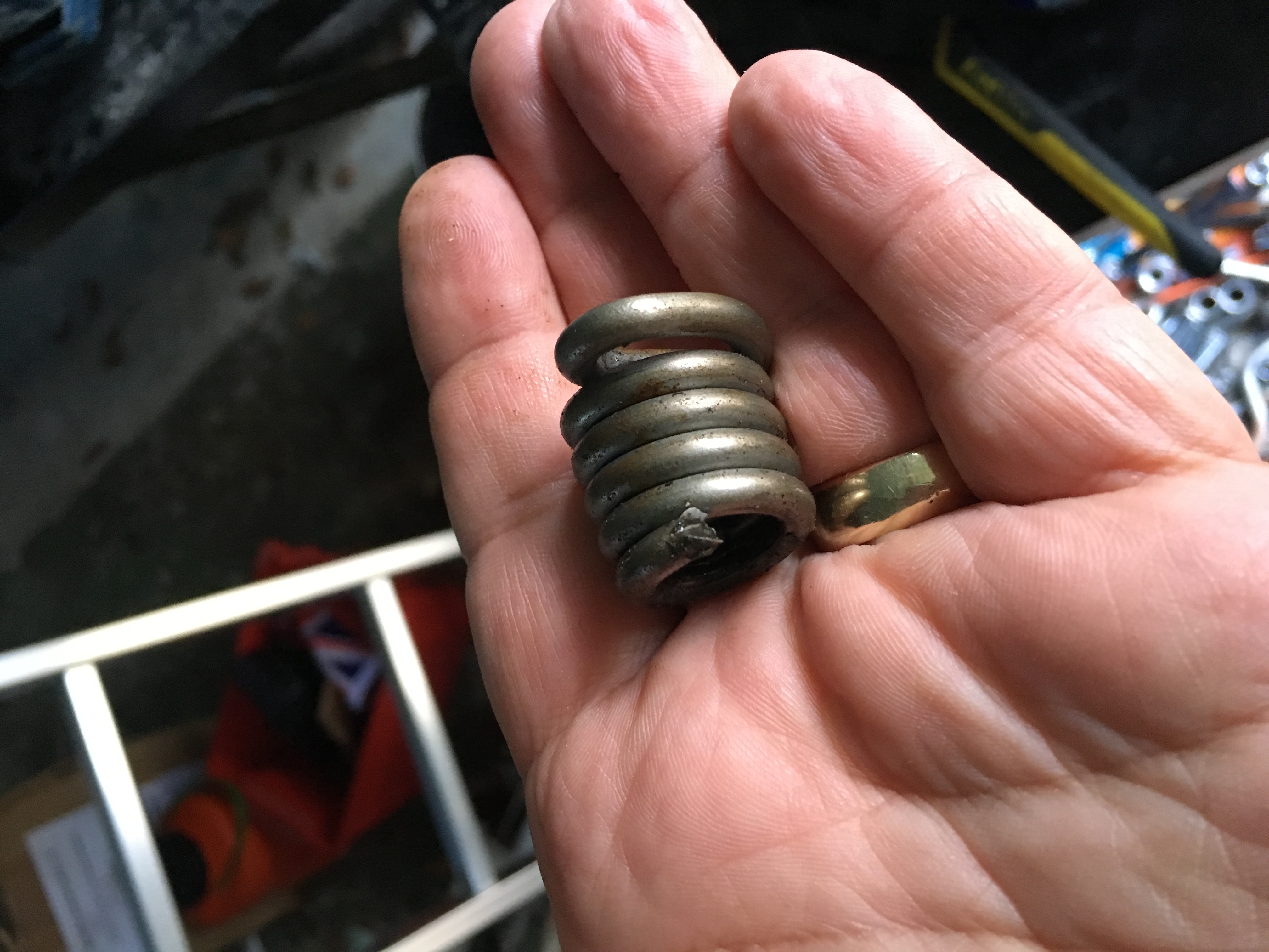

I also noticed for the first time (unless i broke it when I broke the transom screws) that the drive spring is broke...so another item on the shopping list. More to follow....

Good work so far. As you are that far down it will only take a few minutes to replace the rings, and not much cost. Well worth it I think.
Whilst the head is off give it a good clean up and also check the gasket faces for flatness. The easiest way to do that is to get a large sheet of wet and dry medium grit perhaps 400 grade, then wet the wet and dry and put it on a flat work top, run the head around on the gasket face and see where the high spots are. Keep going until it is flat, and do the same on the cylinder face, then fit a new gasket.
Give the water jacket a really good clean out too a long thin screwdriver works well for this.
Assemble it all back and you are good to go.
Don't forget to make sure the fuel system is spotless, including the fuel pipe. The tank can be cleaned out by filling with paraffin and leaving overnight, repeat and finally soak for a few hours with a caustic solution. Always add caustic soda crystals to water not the other way around. Another good way is to put a couple of dishwasher tablets in the tan and fill with hot water.
Do all this and see how it runs. You did buy a new plug and HT lead too?

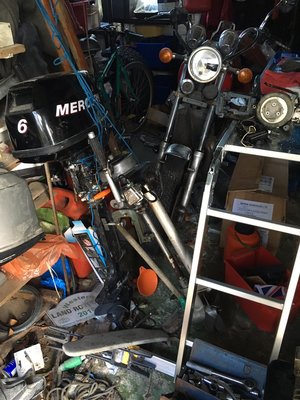

Thanks for the tips. The main problem with my garage / workshop is overcrowding, although it is now blinking cold also.
