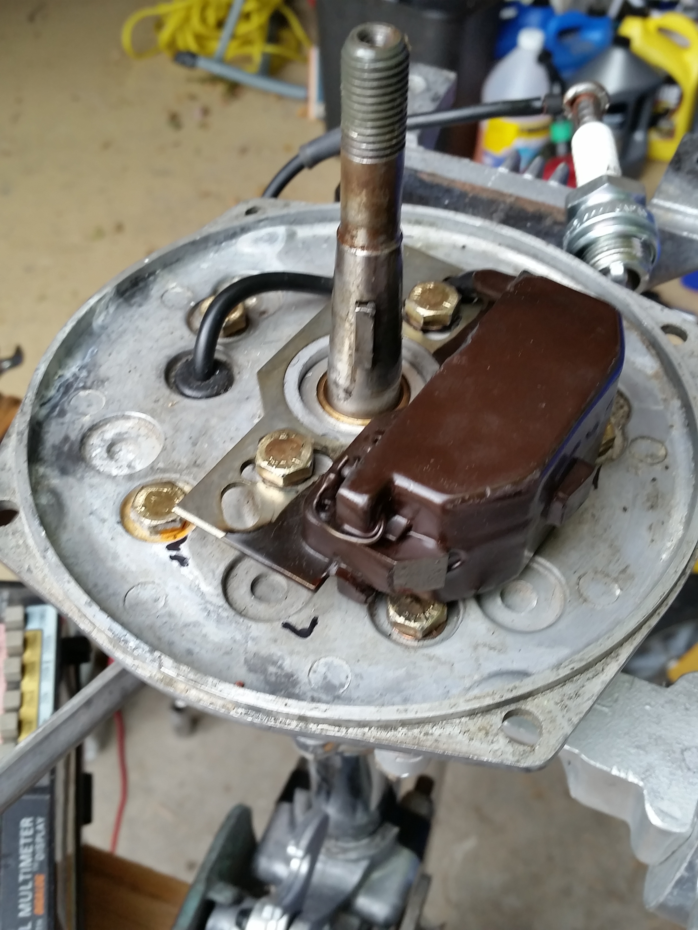

The EFPCL has the Mk IV (brown single modular coil/CDI). Couldn't get spark last fall either. Today, pulled apart the plug cap. Lots of burn and corrosion in the HT lead where the cap connects. I cut it back another half inch until I saw clean copper conductor. I cleaned up the plug cap (the pointed threaded plug cap that looks like a wood sure, screws into the Ht wire). JOY! Spark returns. Spent the next 3 hours pulling bits off the EFNR carb to repair the carb on the EFPCL. Both are Amal. The plastic fuel hose banjo fitting was cracked on the EFPCL. The EFNR had a metal spacer in it's connector but the gasket rings were dried out and cracked. I made 2 new ones. Soaked the cork tank petcock in some 2-stroke mix for an hour wile i was working the carb. The cork swelled up enough to make an almost tight seal.

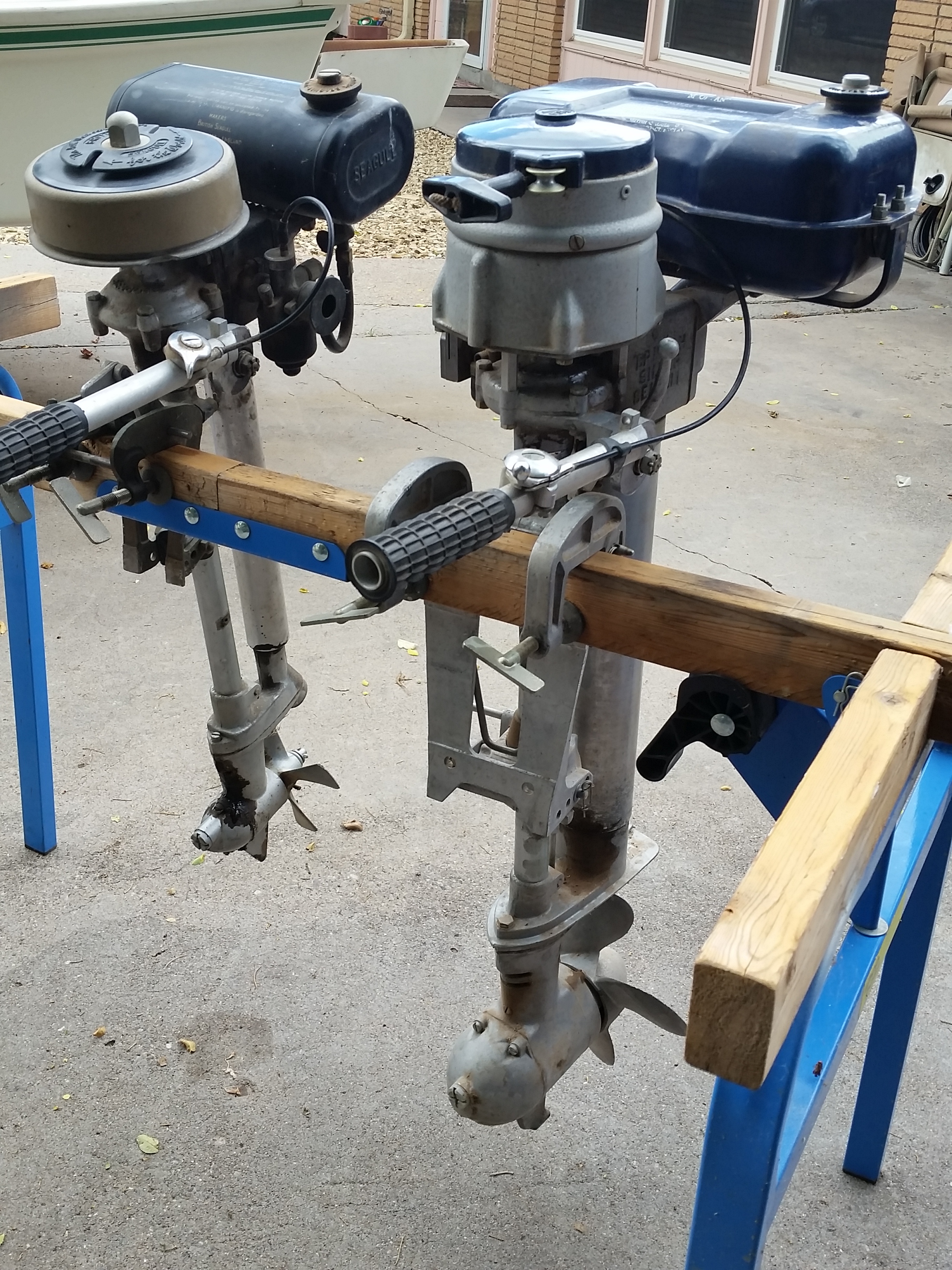

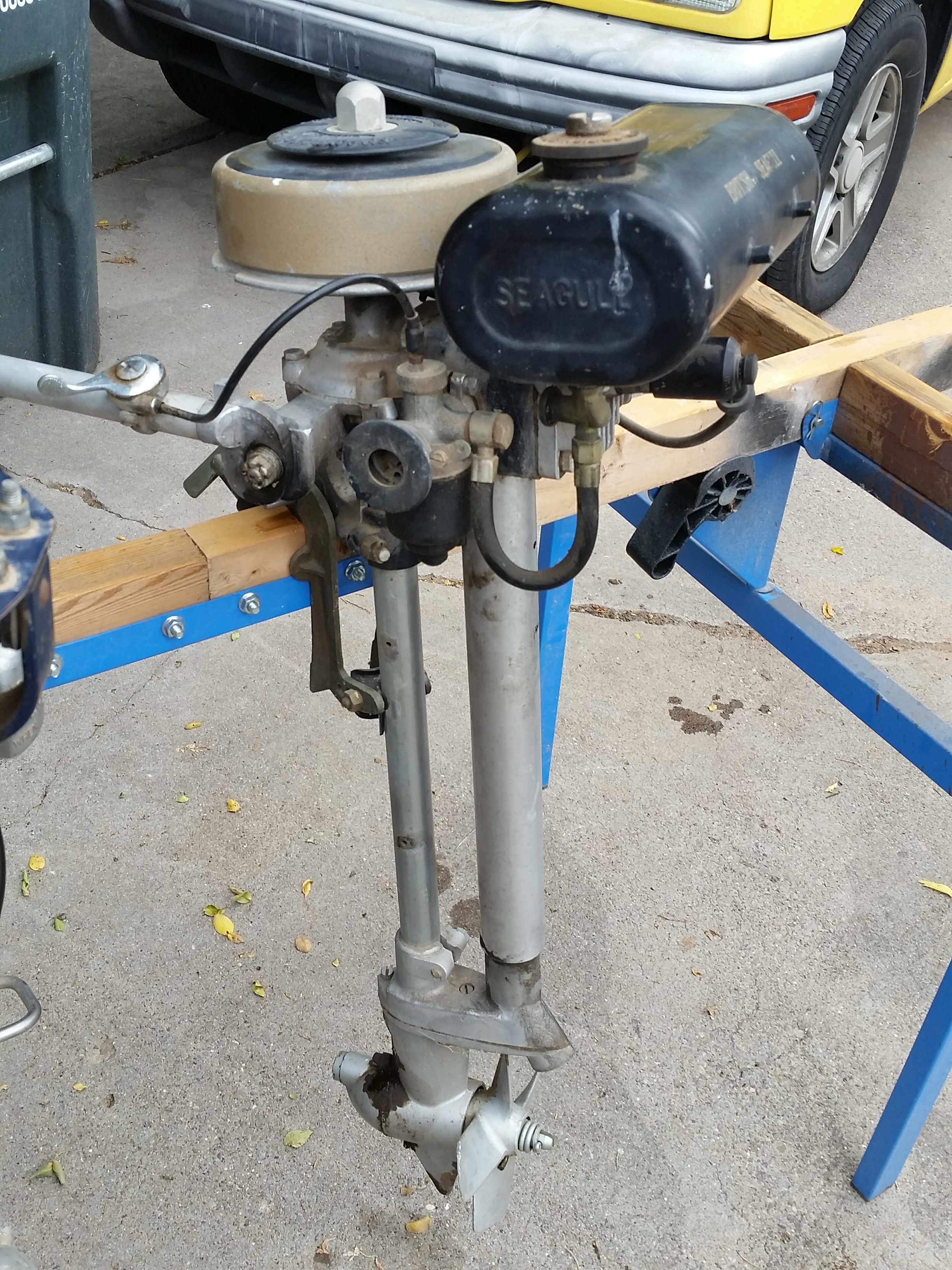

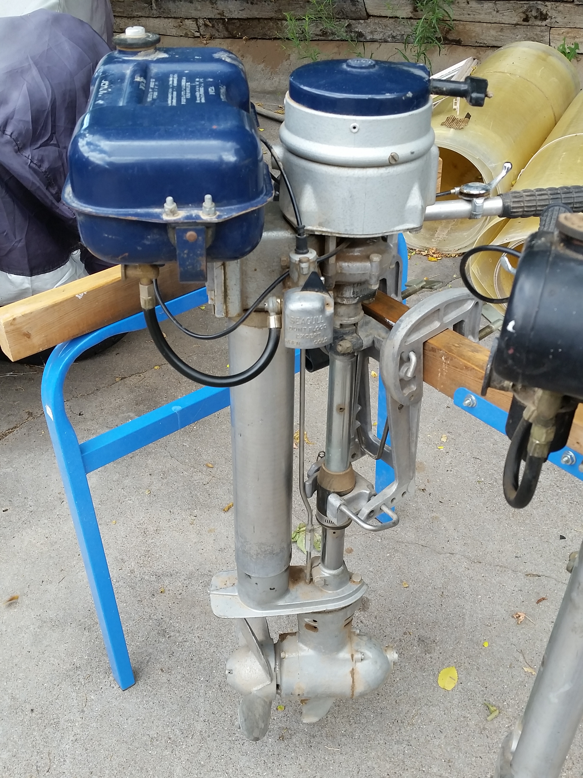

My Seagulls
Here are the motors as I got them last fall. The EPCL is with the flywheel and starter off. I have to go take a photo of it on my boat tonight. The water photo is where I sail most often, Lake Abiquiu, NM. I hope I haven't used up too much BW with these big pix.

The 40 came with the Potter 15. The owner was going to junk the EFNR, so he gave it to me for free. The EPCL I paid about $60 US. I don't think the EPCL has seen more than 2 or 3 hours of service. All of the paint is still on the prop. I've since put about $75 for parts, consumables, and a set of BSW spanners. The rest is my time. I think I did pretty well.
Re: EFPCL Lives!
You did very well there, a lot of engine for your money

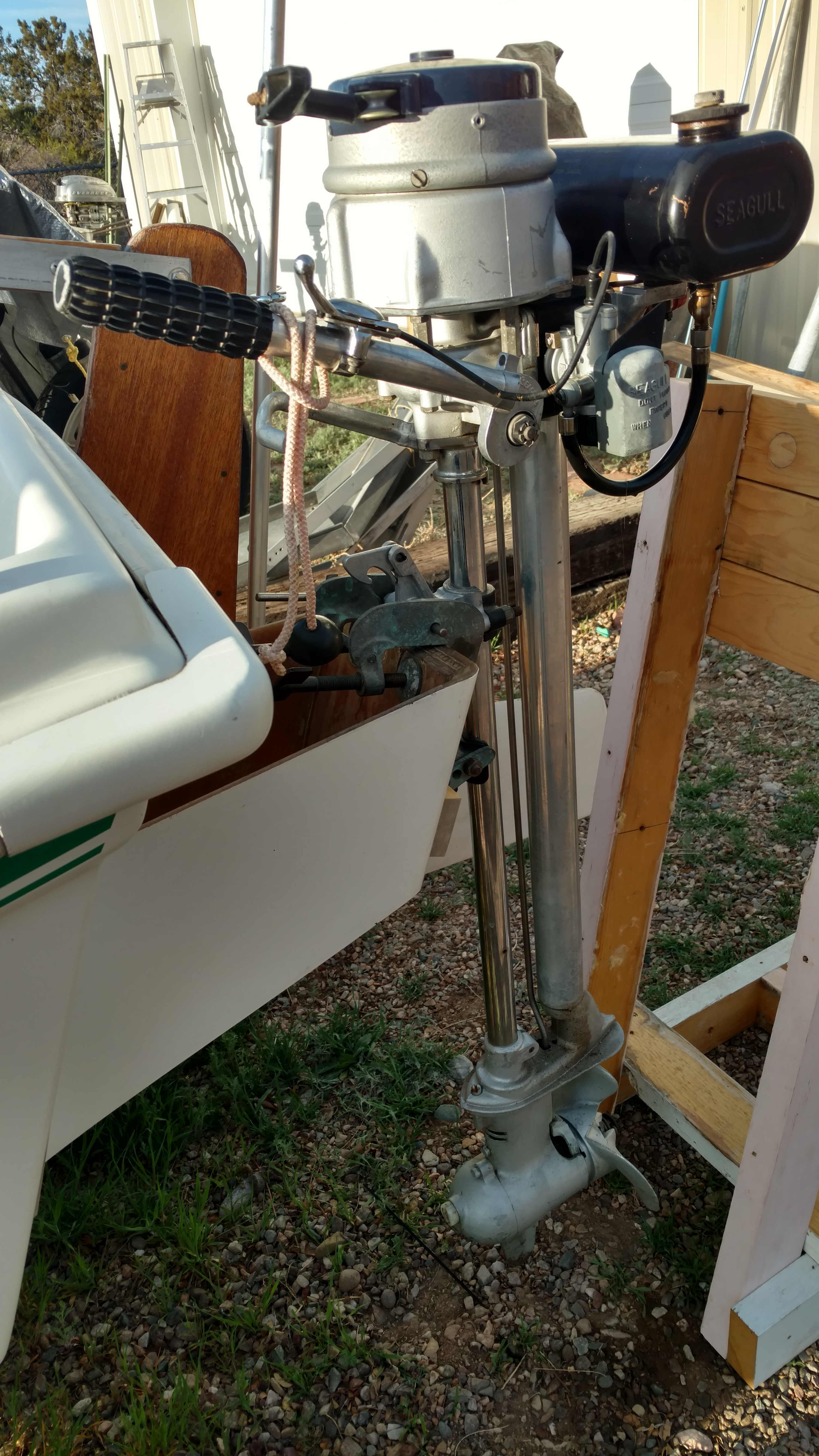

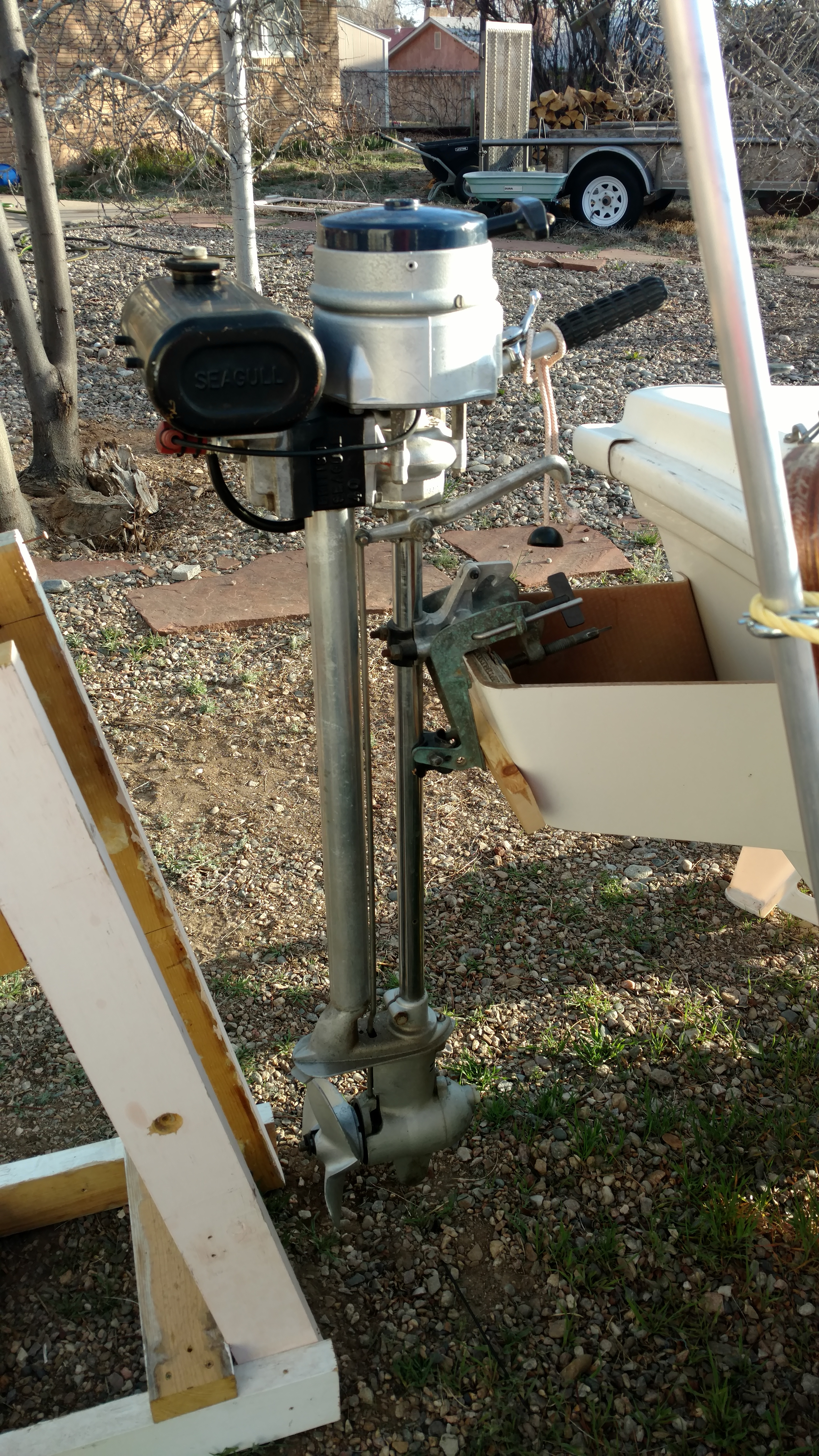

Pix of the EFPCL on the back of my Potter. It has the brass tank off my FW40. The FW40 has the spare tank that came with the EFPCL (I was too lazy this weekend to put the right tanks back on the right motors). The brass tank was really clogged up with 17 years of stale gas/varnish. The EFPCL's original tank is on my FW40. I finished cleaning it this weekend and put it on the EFPCL so I could test it. I also had to put the recoil starter from the EFNR on the EFPCL since the EFPCL's starter was missing the recoil spring. I'll put everything right again once I get some more spare parts. I'm going to fully restore the Featherweight 40. The tank, although has a few light scratches and the decal is faded, has absolutely NO dents or dings.
BTW. I was thinking, that if the recoil spring is not available, could one be fabricated from some thin spring steel,say from an electrician's wire snake?
Finally, from the photo's you can see that the long-shaft is 8 inches too long for the Potter. I saw some accessory photos for the seagulls that use a clamp on the 1" driveshaft tube to raise the motor in the steering clamp. Are they available? recommended? Can I just fabricate a spacer that clamps between the power head collar and the steering clamp to raise it? I would be a little worried about crushing the drive tube or scratching the chrome. Otherwise, I'll just build a bolt-on extension to the boat's motormount. I'm eventually going to replace the fixed mount with an adjustable scissor mount like I had on my Macgregor. That way I can get the motor completely out of the water.
