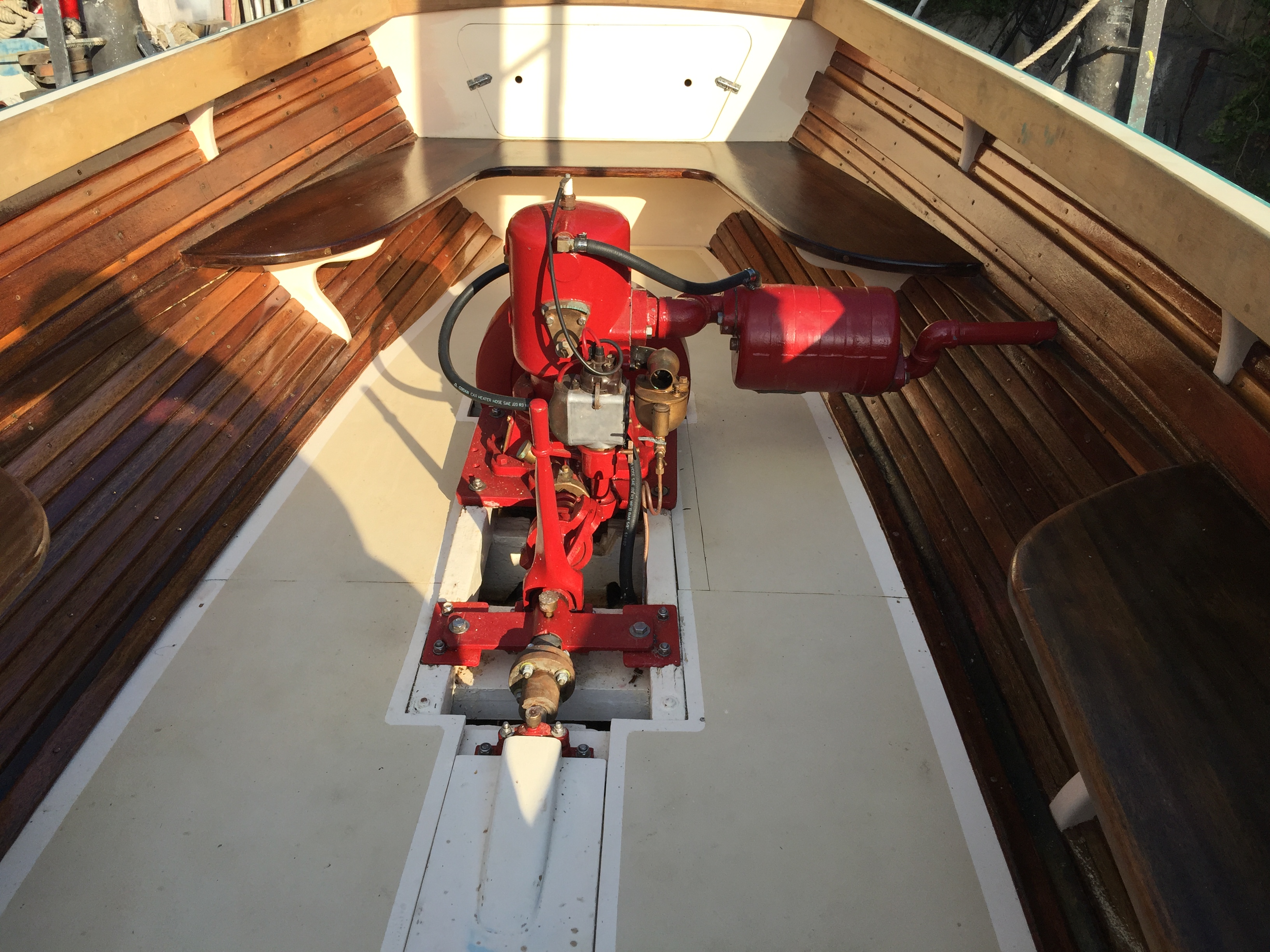

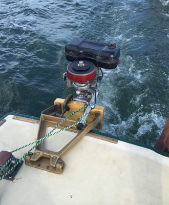

I have a SilverCentury Plus as the auxiliary motor on my 20' open work boat down here on Sydney Harbour. The Serial Number is WSPCL1378HH7. It is fitted to my boat 'Sarah' with a Spartan outboat motor mount. We tested it for first time on the weekend and was not overly impressed with the performance in the water. Currently the prop is a four blade rounded prop* and I see in all photos of Silver Centuries that it should have a 5 blade 11" hydrofan prop. Would the 4 blade rounded prop on the engine now give less performance in the water?
Silver Century on Spartan outboard mount
Interior of the work boat with Chapman Seadog Engine
The rear of the boat

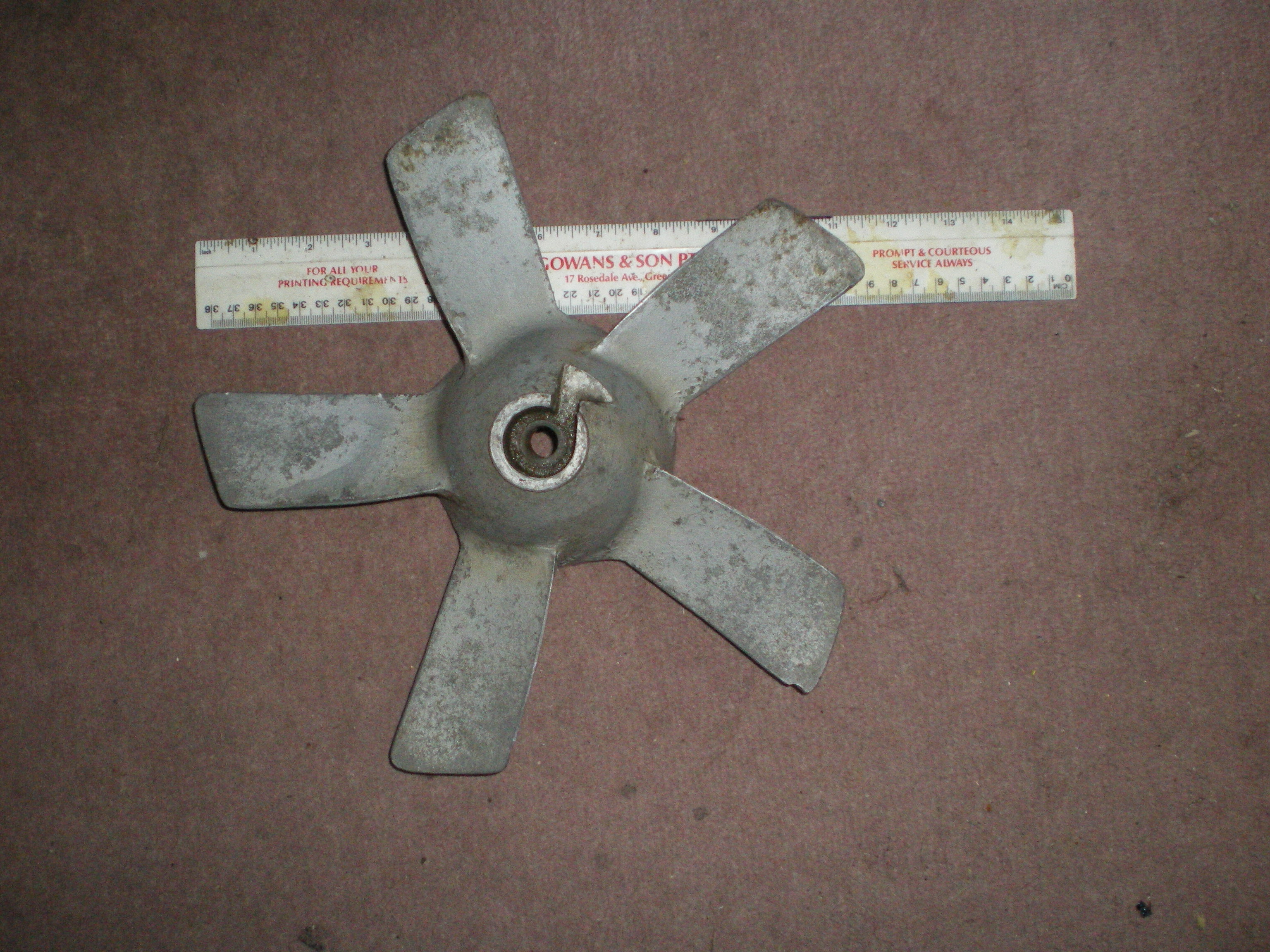

I have been led to believe that most, if not all Century model Seagulls are supposed to turn a five-bladed hydrofan type prop, not four blade or otherwise.
If some Silver Century's left the factory with four blade props, I'm sure someone will let us know.
BP
Again, thanks to SOS for the pic.

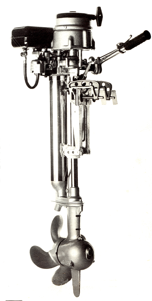

The later weedless prop design on a model 80, still a silver century though.
I don't think it had as much push as the Hydrofan

Thank you every one with the help re the correct prop for my engine. The boat it is on is at least 1 ton and I wanted the Silver Century to be a definite auxiliary. Not wanting great speed, just to get me home if the Chapman Seadog lets me down. So now looking for a 11" 5 blade original prop. I am sure I will find one!
Thanks everyone again.
I will let you know the difference when the new blade is on.
