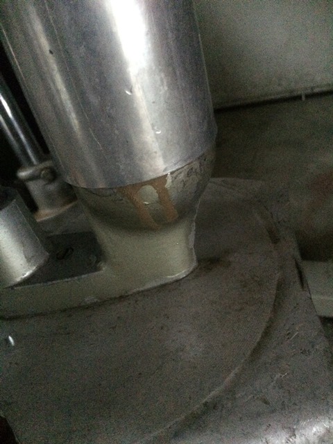

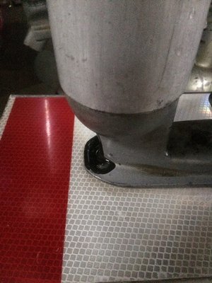

Here is something interesting black oil out of the silver cent. and coffee out of the LLS whats with that? The fuel is the same in both engines run on the same day
Re: Fixing the 20 footer
The coffee is an emulsion how's the water getting up that high?
That's got to come apart.
I will remove the exhaust tube and take the power head off the drive tube to have a good look in the exhaust port.
If I can't see any thing there I will take the head off.
On a LLS it's dry around the exhaust port, check the water delivery tube for fractures & a sloppy fit in the water pump housing,
Wake the neighbours & run it without the exhaust tube.
Did jast as you said.... Neighbours are happpy with me now! :lol:
Water is spraying up from the pump housing, The pipe is a little deformed where it fits into the housing.
The coffee was 200mm up the tube, nice and black down from the top. I'm happy.
It's still pumping plenty of water and not getting hot so I will leave it be for now.... Too many other things to do right now.
