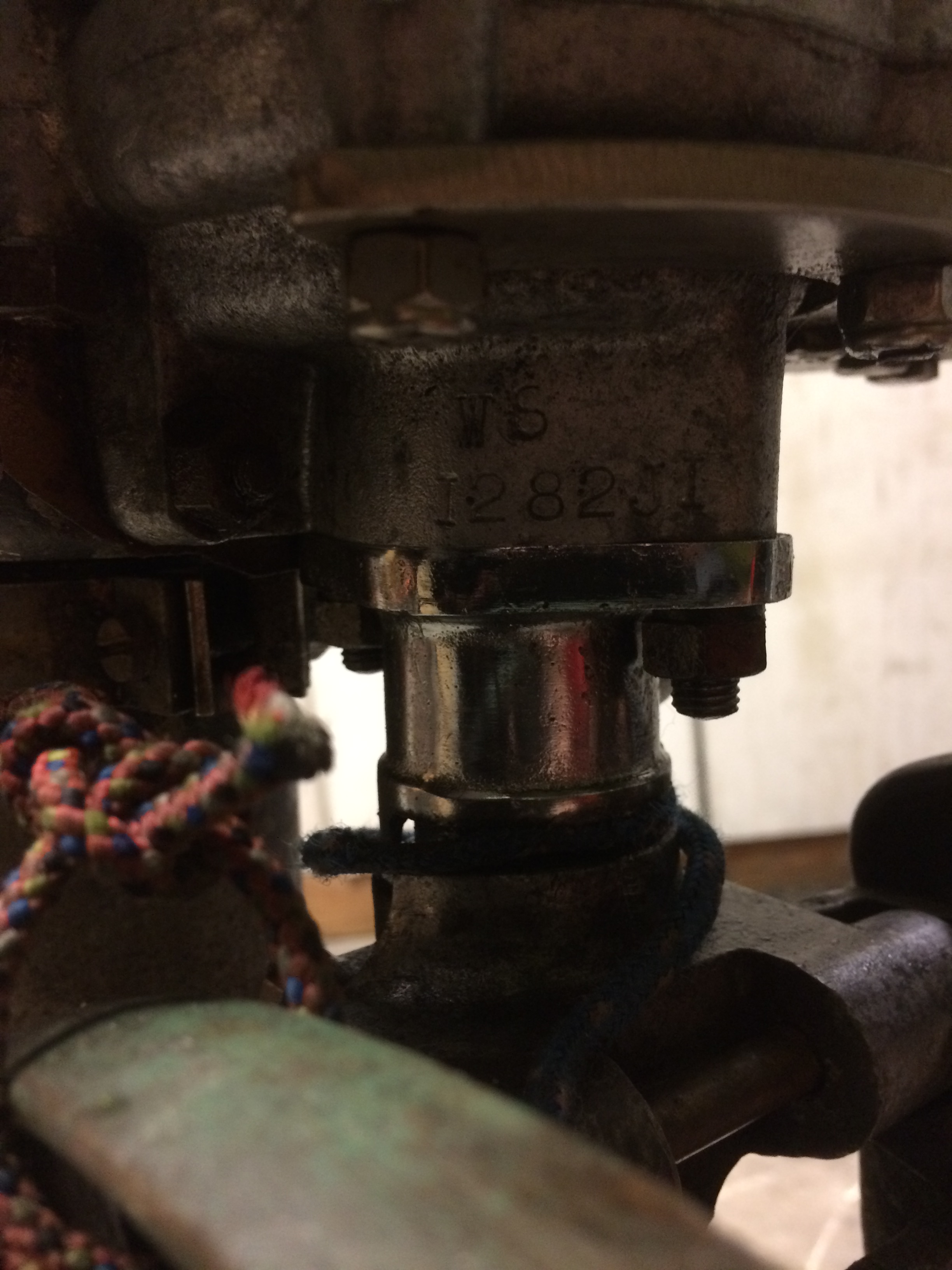

The ws runs great it has a 3.5 :1 box with a 5 blade hydro fan and will pull 4000 rpm all day long.

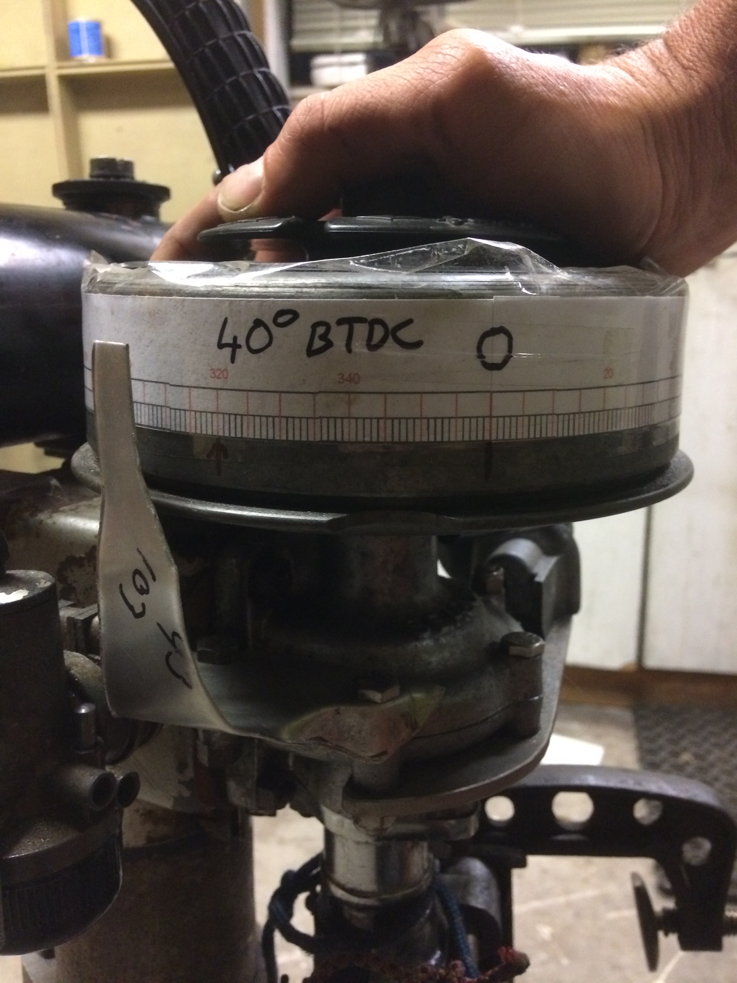

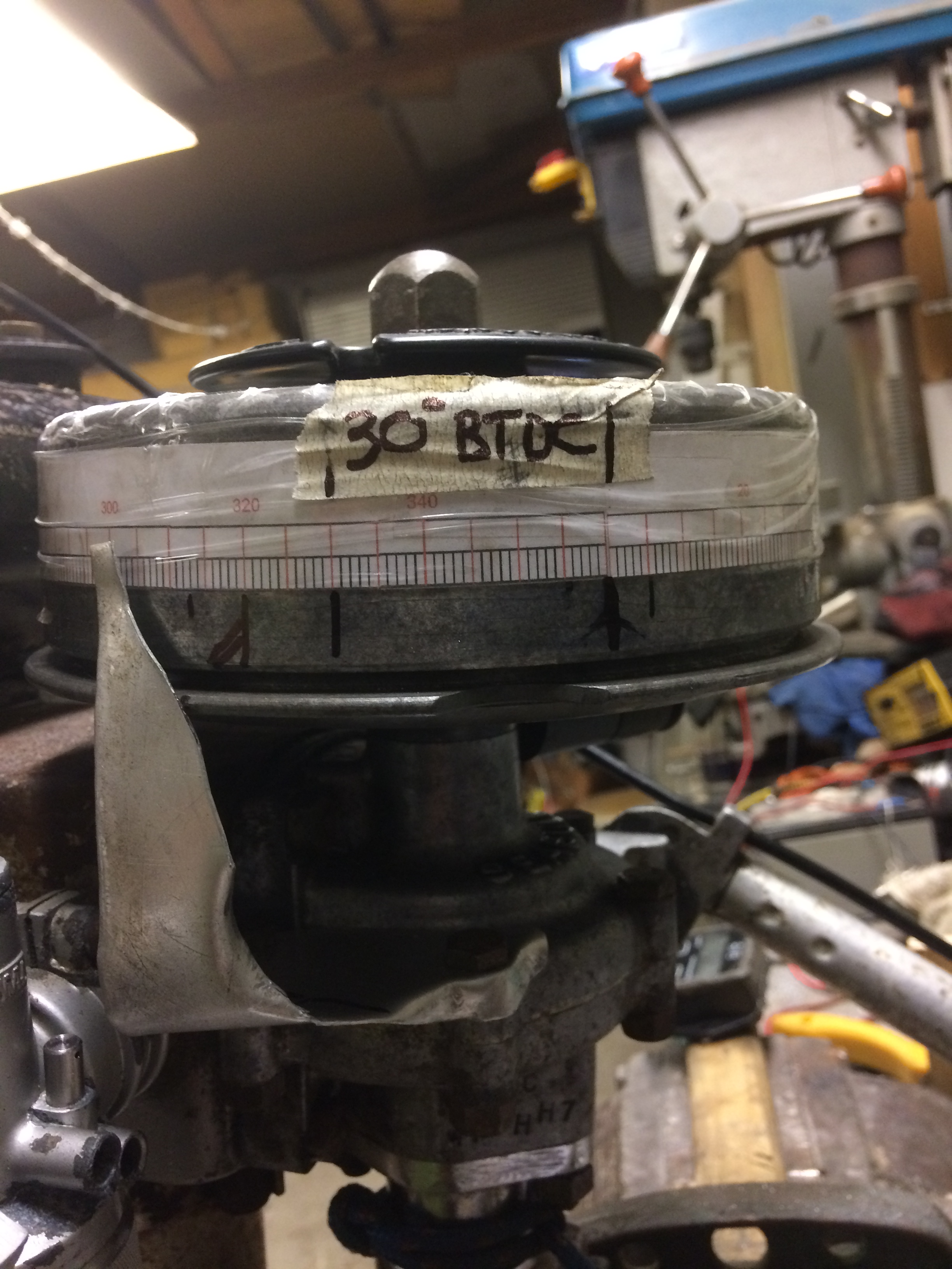

Then I noticed the D cut out on the mag base plate was in differant places.
At this point I have decided It has to have something to do with the timing!
I worked out where TDC was by welding a bar to the end of a sparkplug to stop the piston. Rotate the piston one way, take a reading, rotate it the other way, take a reading, devide number in half and it will give you BDC.... 180° from that is TDC.....Got it!

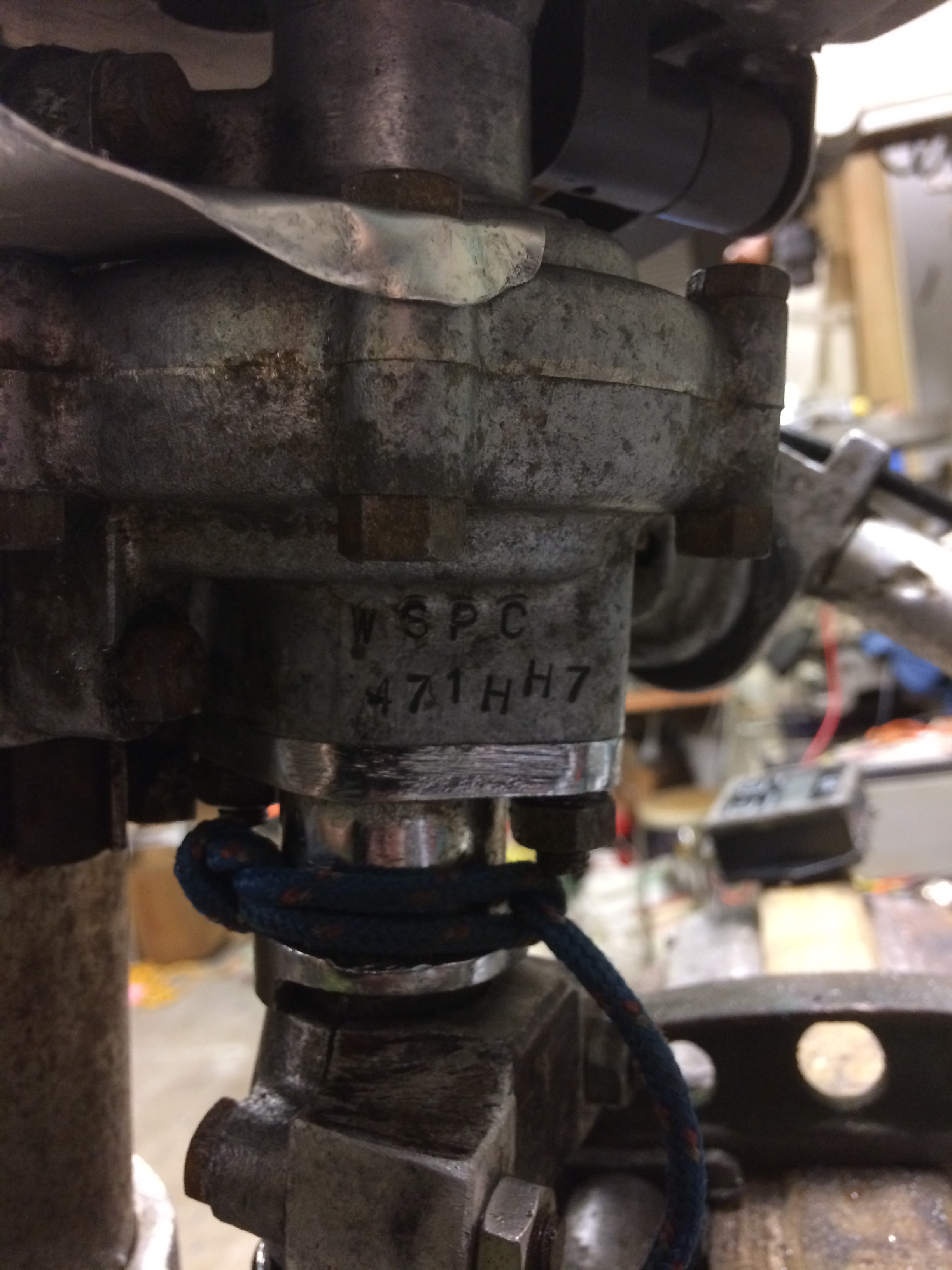

The timing on the ws is factory set to 40° BTDC The timing on the wspc is factory set to 30° BTDC So why is WSPC set at 30°BTDC and the WS set to 40°BTDC???? The power head on both these engines Should be the same???

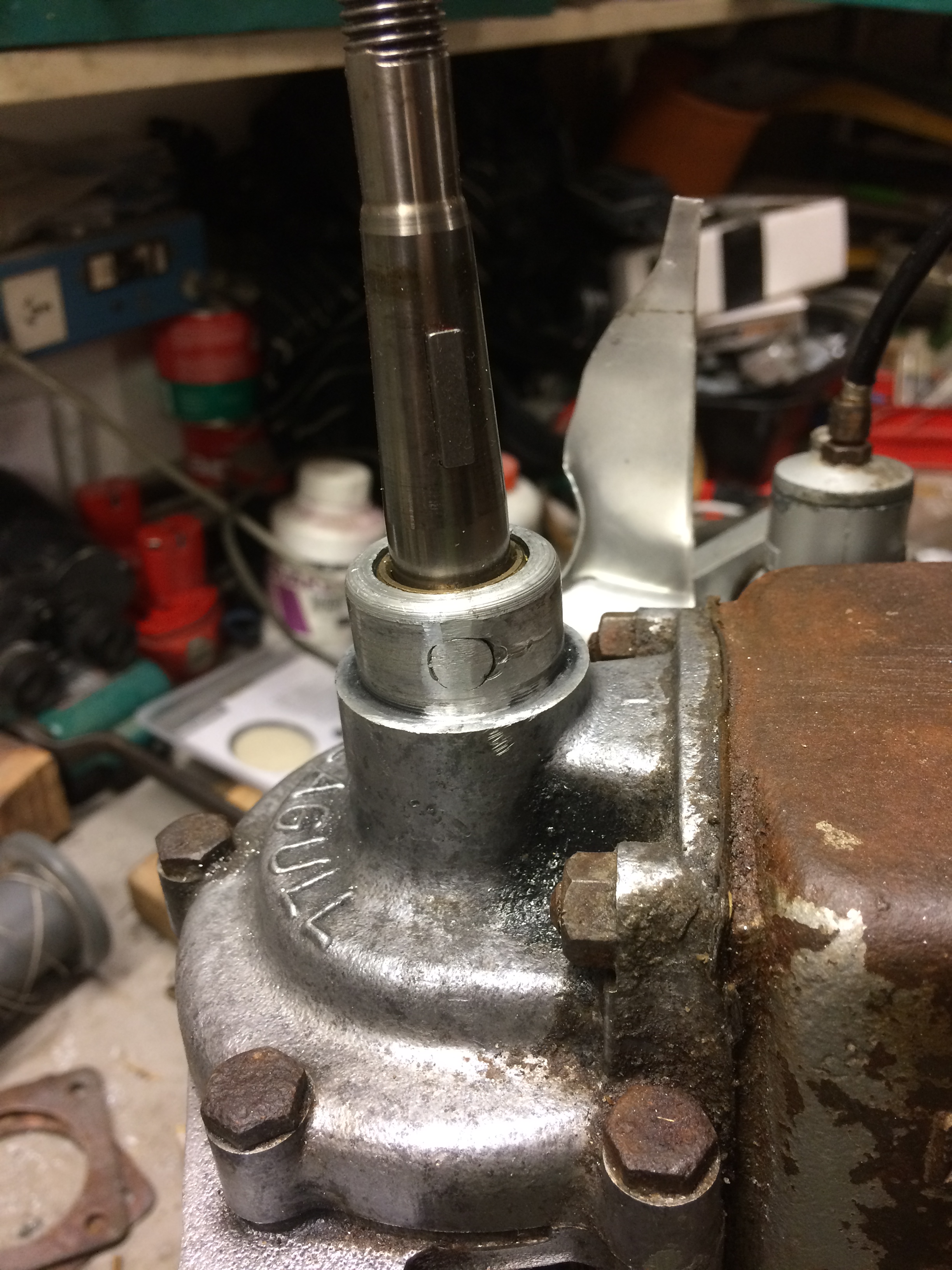

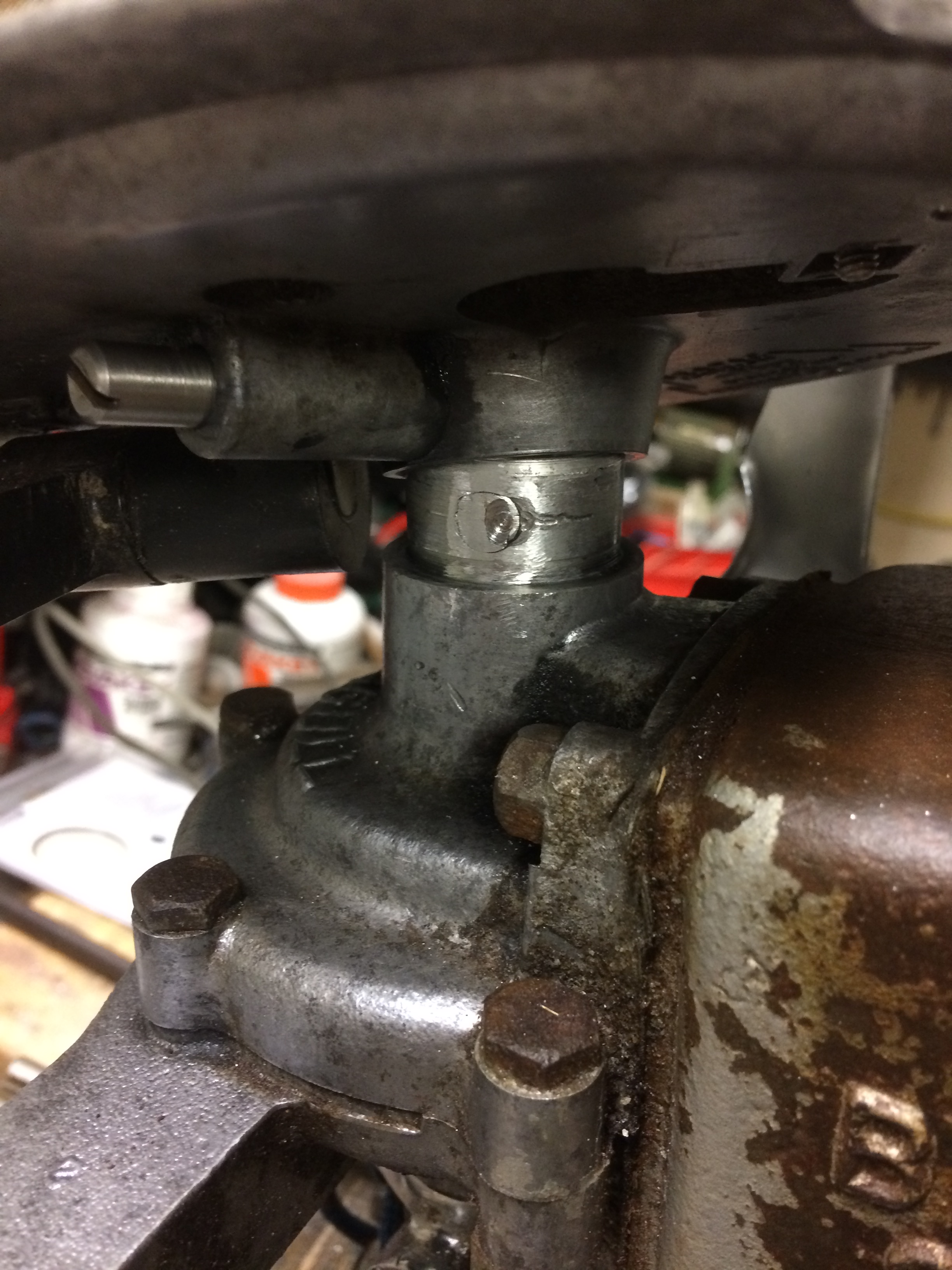

The problem with changing the setting on the WSPC is where the hole for the retaining screw is. It is half a hole out!
How to fix that problem??? I turned up an aluminium slug cut a 5/16 x 26 55°thread that was a little over size and wound it in the hole. More to come
