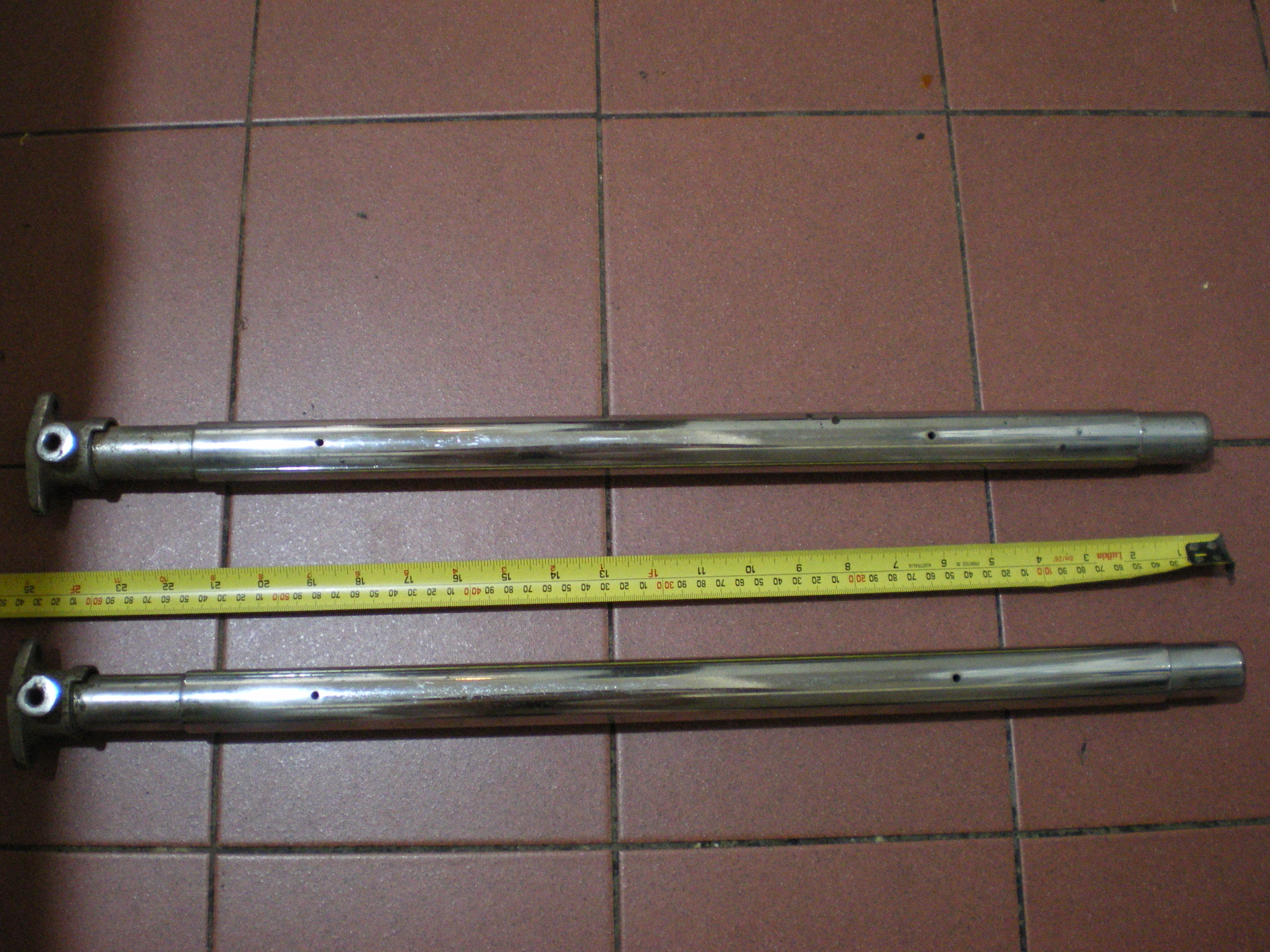

Re: FNR Standard Driveshaft Tube
I've seen a EFNR leg fitted to a 102. A chap in Sydney did it. The transom bracket will have to be changed to so you can lock the tilt in reverse. A faint bell is ringing in my mind that the exhaust and torque tube are slighly different centres and if this the case the two tubes may not be parralel but it wont be out by much. The thicker drive tube will be needed to use the rubber flange that the EFNR transom locks onto. I can see no difficulty in physically attaching. The prop has a different sheer spring arrangement as the std one will unwind in reverse. Whether you can adapt another prop to the EFNR box l can not tell you but hey just change the leg over. Only should take you an hour. Go for it. Drive shaft flange the same. Exhaust diameter the same. Water pipe connection the same.
I would just bush the lever to get it up to desired internal diameter. Should be easy enough. Some of that taped copper foil used in stained glass lampshades etc would be a home handyman temporary fix.
I have an EFNR in the lower dungeon but unfortunately there is a reptilian poltergeist down there and as such I'm not game to go down there until Mars is in retrograde which wont be for another 9 months

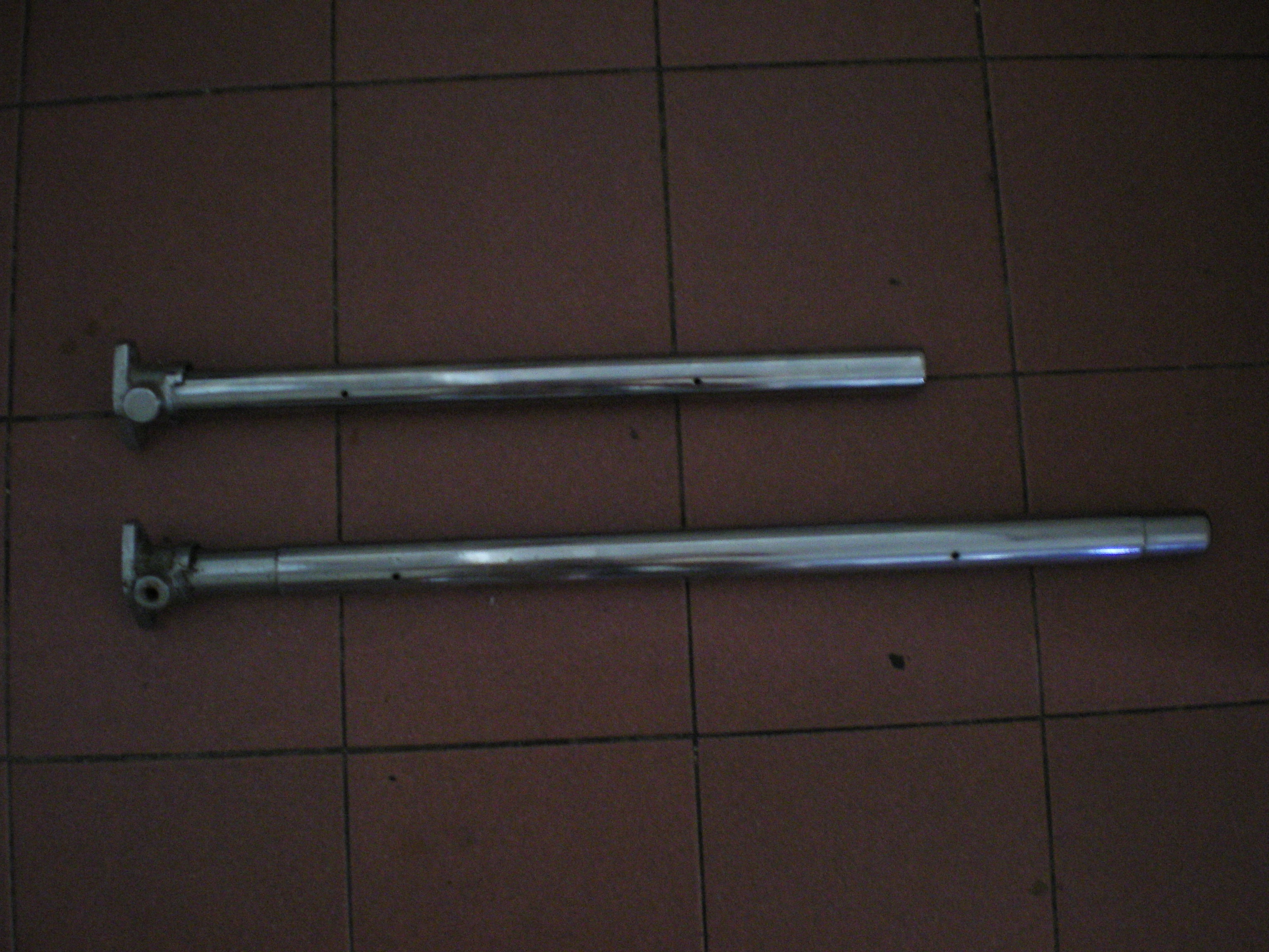

Is the FNR driveshaft different to silver Century? Don't know much about the newer motors.
Are these the same? Edit:
I just had a thought that there must be two rubber driveshaft flanges as the short (std) diveshaft is narrower against the thicker longshaft. Or is the std EFNR driveshaft a thicker one as well?
Hugz,
Some later models fitted with FNR boxes have a substantially thicker outer diameter for the driveshaft tube, this was done to overcome an issue with flexing in the tube. The difference is obvious.
The difference between a 102 tube and (for example) a Silver Century tube is in the casting at the top. A 102 tube can be made to work with a later bracket but just not so neatly as the one it was designed for, so if this bugs me I could just as easily use a Silver Century tube as a 102 tube. But the fatter FNR (Curlew?) tube would a) accept the clutch lever bolt, b) obviously have no issues with the FNR mounting bracket and c) there would be no possibility of tube flex.
The flange/bush I have came from a rusty Silver Century bitsa pile of horribleness and fits well enough on either a 102 or Silver Century tube so I assume there is no difference in outer diameter, especially as either tube fits any water-pump housing I've offered it to. Never bothered attempting to measure it though.
And finally...you are right that the tube centers of an FNR are different to those of earlier models...curses! However, as you also rightly say, the difference isn't great - a crude measurement shows a difference of 6mm between the top and bottom of the exhaust and driveshaft tubes. Also as you say, its probably not enough to make a serious problem, although it is enough to see with the naked eye and this pisses me off since it detracts from what at least I percieve as the aesthetic value. Also the driveshaft will be running at an angle other than 90 degrees inside the driveshaft tube. But there's no getting around it so I either abandon the idea or accept it. Think I'll go with the second option, but the acid test is wether or not the driveshaft moves freely. Still, its been done before!
