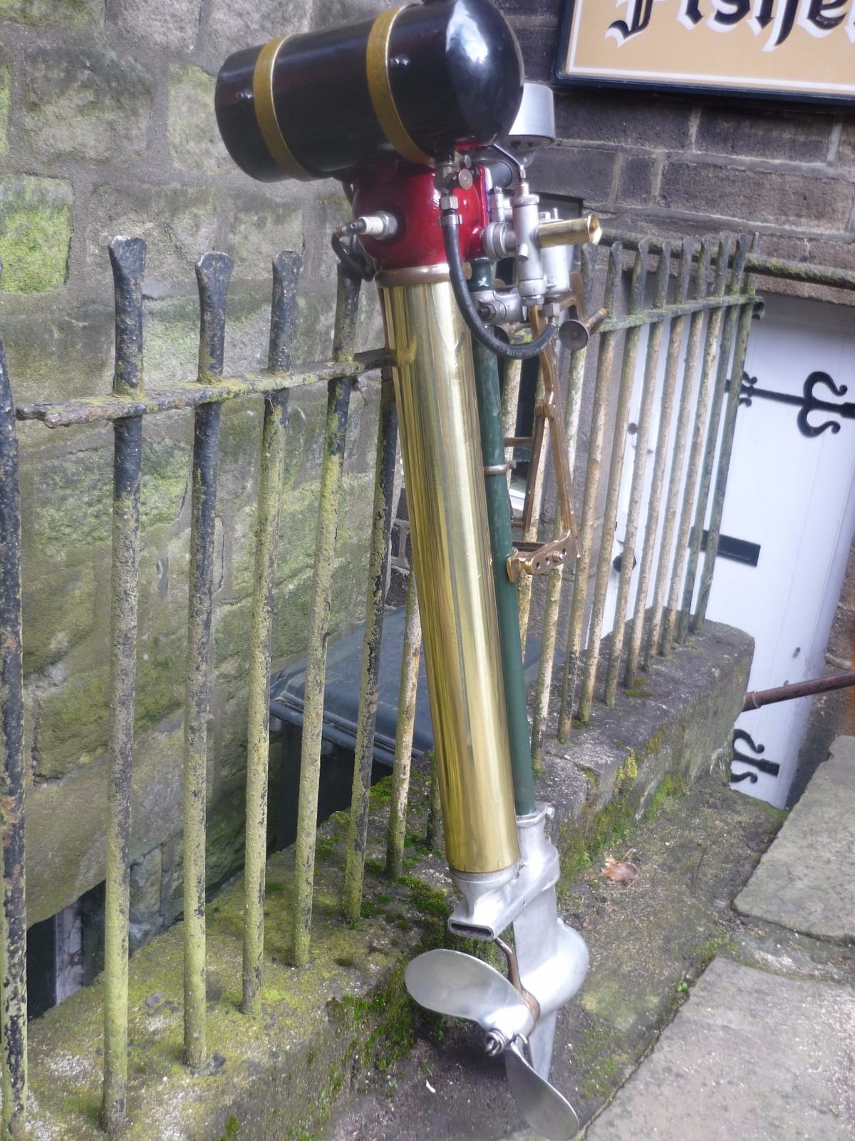

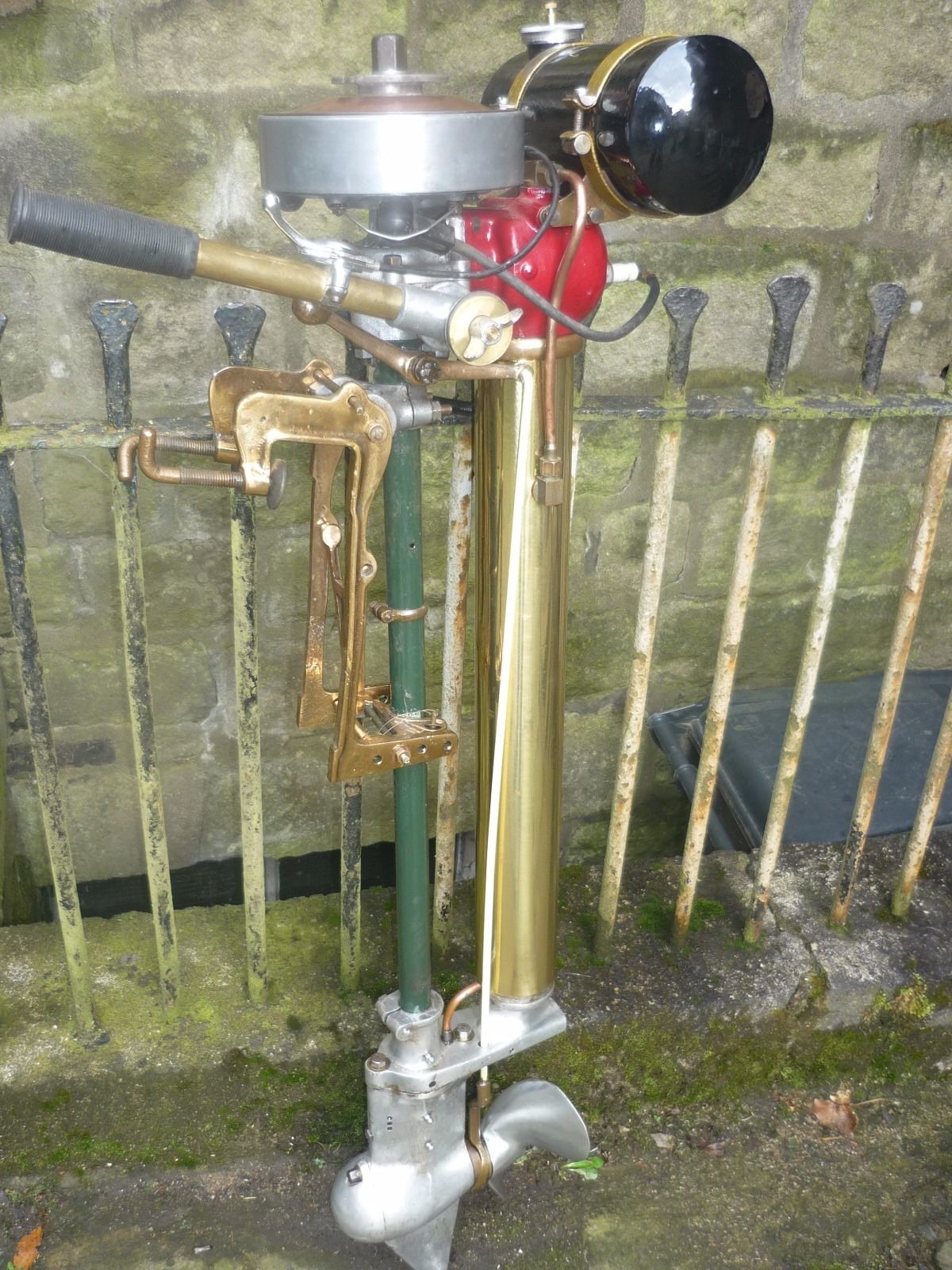

Pressed brass tank mounts, late serial number (1350 away from my SDP), late tank straps, brass tiller :shock: with an odd tiller grip, wrong thumb throttle etc. etc. etc. and what's with those colours !!! :lol: :lol:
Is it REALLY worth that much :evil:
I don't think so
Re: sd on ebay
Also the carb looks late, like the throttle lever, no plug cap and a painted tube, a cheap restoration, if it was all original and not tarted up like a French poodle, then it may have been worth more than it is now.

The seller has obviously gone right through the engine, not many people would replace and ream out the crank bushes. It also has a very nice replacement bayonet cap 8) Shame about the description as a naval model, that description has come from here I'm afraid.
With the skeletal bracket, and ignoring the red paint, quite nice. Best of luck to the seller, who has obviously worked hard at it.

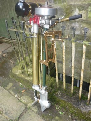

Before and after...
Is that the same motor?
If it is its a shame in my opinion, i think that engines with patina are nicer to have than restored ones.

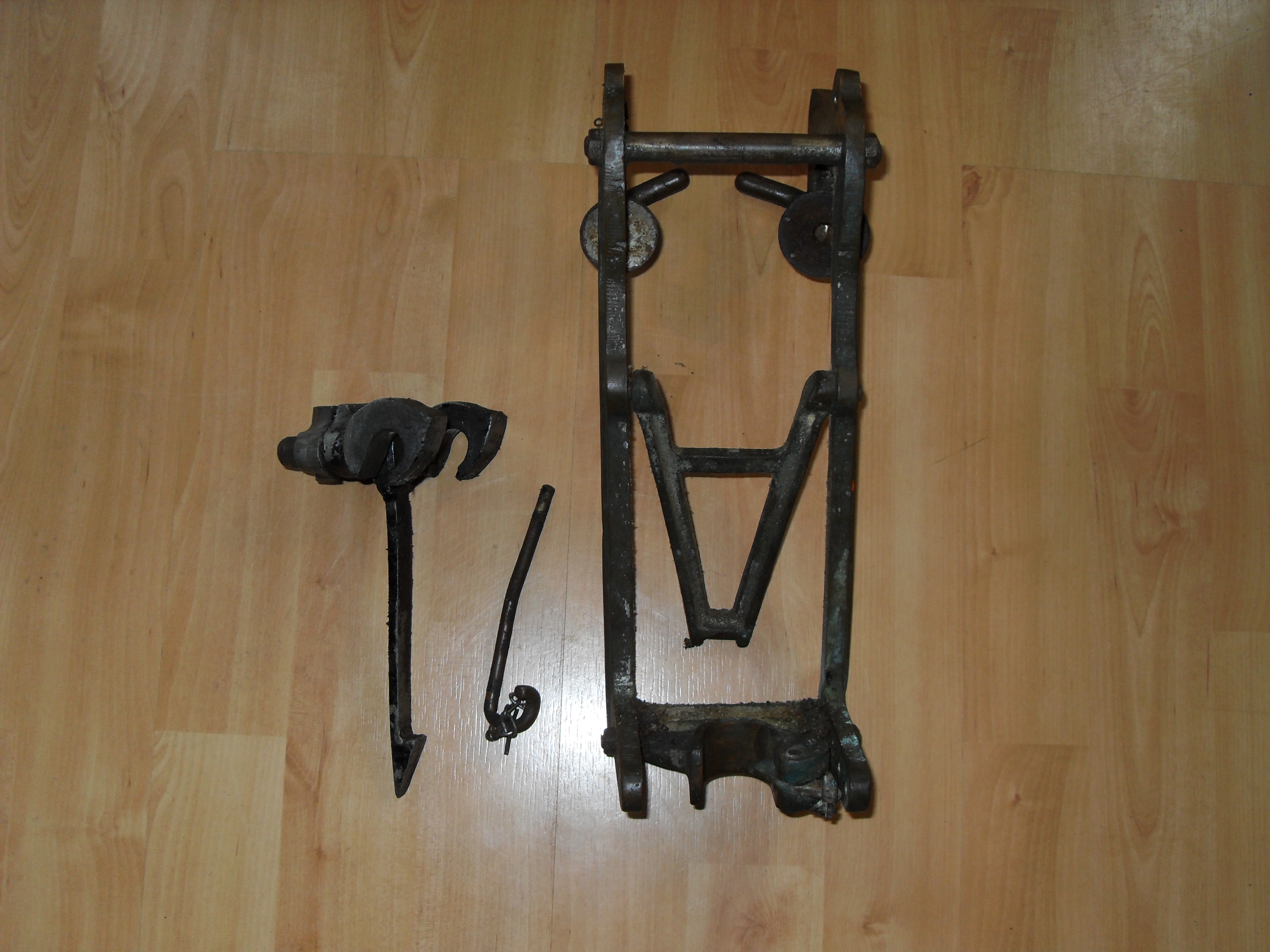

I like the novel approaxh of using the original height adjuster as the transom bracket tilt support. I've never quite figured out what the V strut hooks onto on the skeletal brackets.
Does powder coating have a high heat characteristic? Would it burn on the exhaust tube?

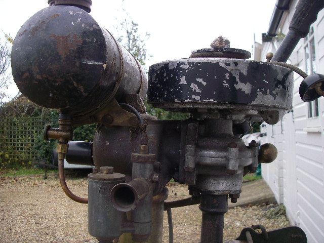

Going back and forth between the before and after pictures there seems to be a bit that's shall we say changed.
Older pics from SOS show what i believe to be the "original" carb for this motor and yet in the after pics it's a more modern variant with a plastic fuel pipe. It will obviously still run like this but it's not right for the motor's age.
Before pics show the much earlier gearbox oil nipple arrangement, after pics show a more "common" gearbox.(something not quite right there)
Tank straps in the before pics are probably right for this, and yet in the after pics they've been swapped out. On and on it goes.

Hugo, this is what the components should look like on a skeletal bracket. What's missing on the one from ebay.

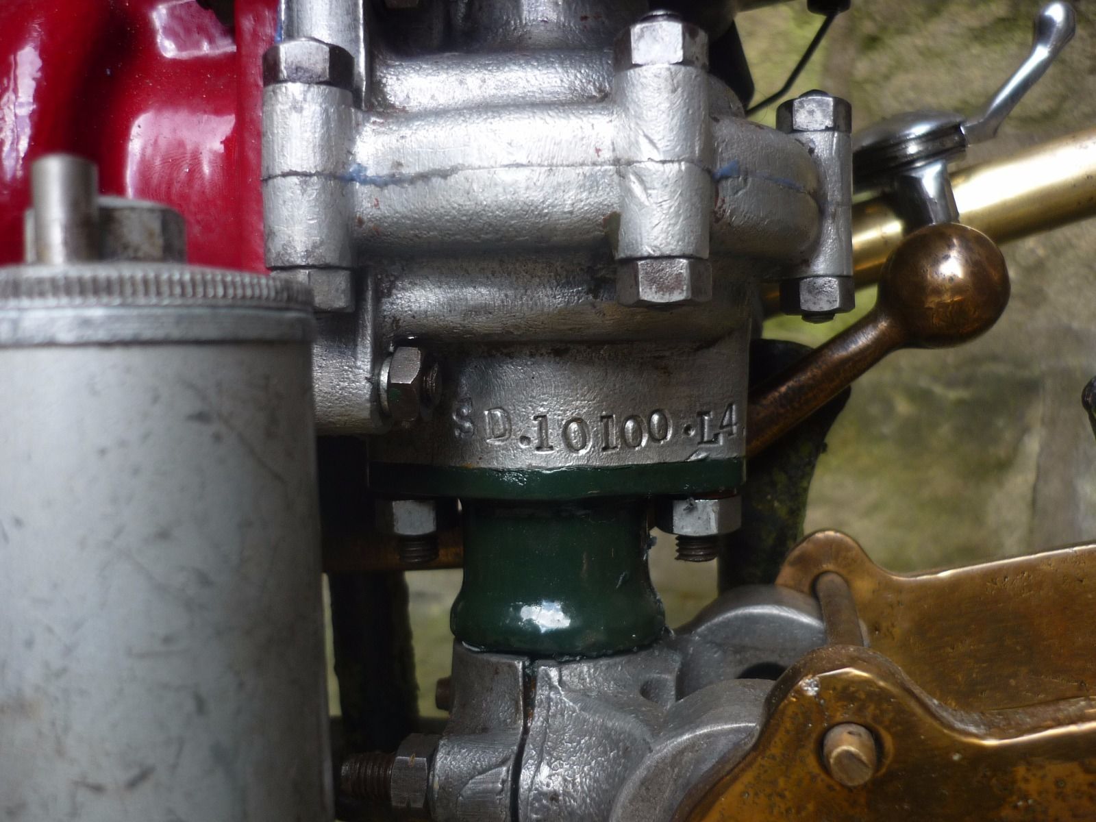

When Jon started saying, this and that had been changed, it got me to thinking is this actually the one that John Williams sold in November 2013. Maybe John Williams sold a different SD other than the one in November 2013. If you click on the "John Williams" picture and zoom in, you can just about make out the engine serial number and it looks a lot different to the very bold, well stamped "ebay sd". It could be that the original "John Williams" photo the serial number is just covered in grime and can't me made out properly.
I'm sure Hugz has information in his registry that leads him to believe that it is the same outboard, just making sure we're 100% certain.
