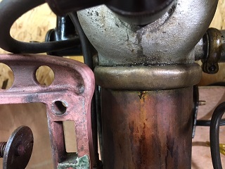

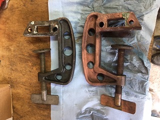

Hello everyone,
What is the best way to clean bronze transom bits as i tried the salt and vinegar solution and it turned a horrid pink color!?
I want it to be like the exhaust clamp on my SD.
Cheers Jacob
Cheers Jacob

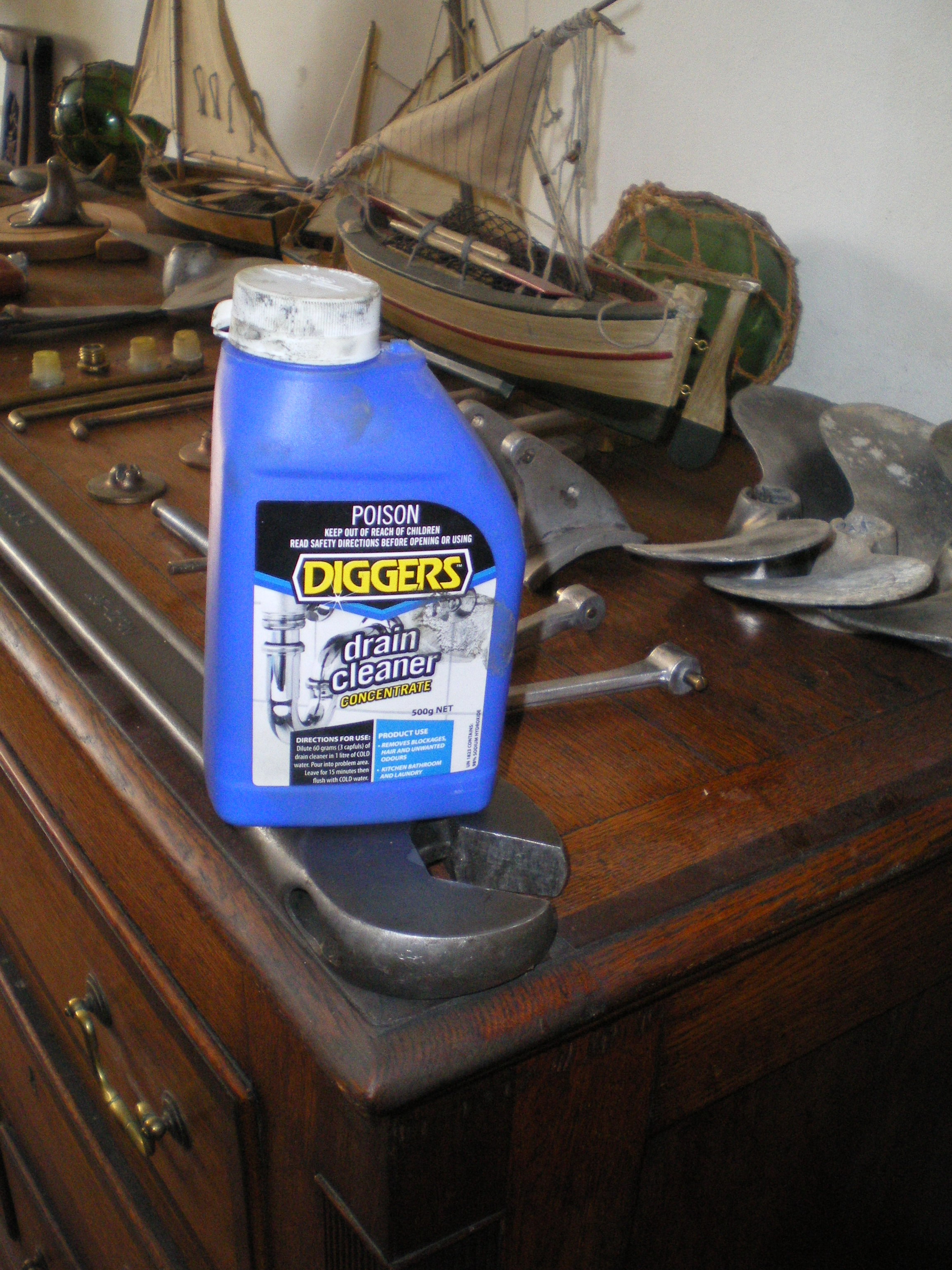

Re: Bronze cleaning
I dip in caustic soda for 24 hrs and then hit it with a wire brush on a drill.

Re: Bronze cleaning
Is that the same as soda crystals?
Re: Bronze cleaning

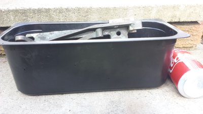

Once decreased with petrol cheap coca cola overnight then like hugo says wire brush at the end of a drill..sorted then you realise what it does to your guts

Re: Bronze cleaning
Cheers guys, have wire brushed the pink one and it looks perfect! the other one is currently soaking in coke till tomorrow evening.
Re: Bronze cleaning
Caustic Soda is NaOH Sodium Hydroxide or stuff you use to clean drains. White crystals that you dissolve in water.
Re: Bronze cleaning
Do be careful using caustic Soda though. It will destroy alluminium parts very quickly...
On alluminium I degrease, scrub in washing up liquid, then put in the dishwasher. Finish off with a rotary wire brush to burnish.
Also follow the instructions and add Soda to water and not the other way around.

Re: Bronze cleaning
To add to the above cautions re caustic soda, wear eye protection. One drop of the solution can do serious damage and cause blindness.
It is nasty on the skin too.
Get rid of it straight away, do not leave in unlabelled containers for others to find.

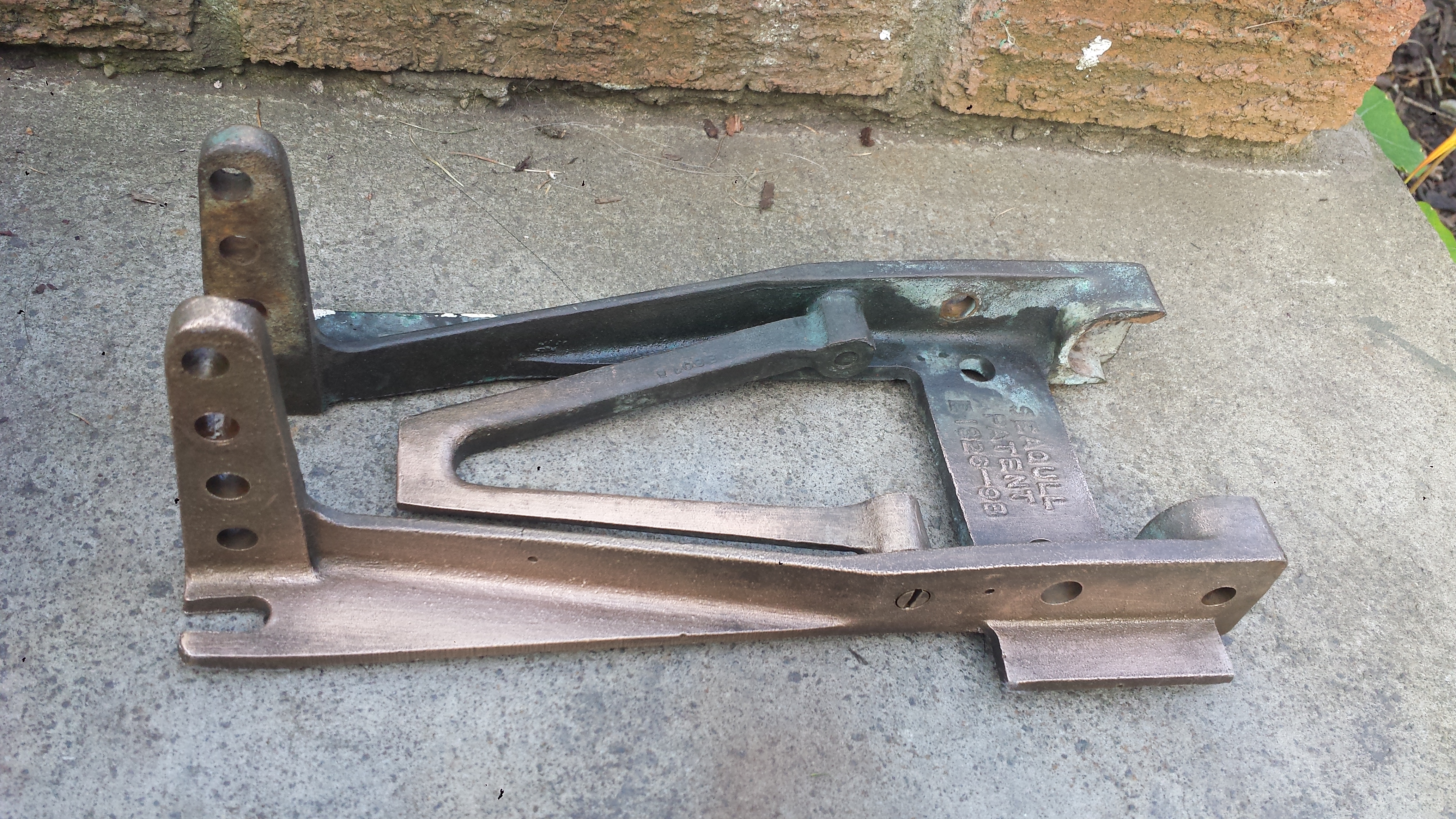

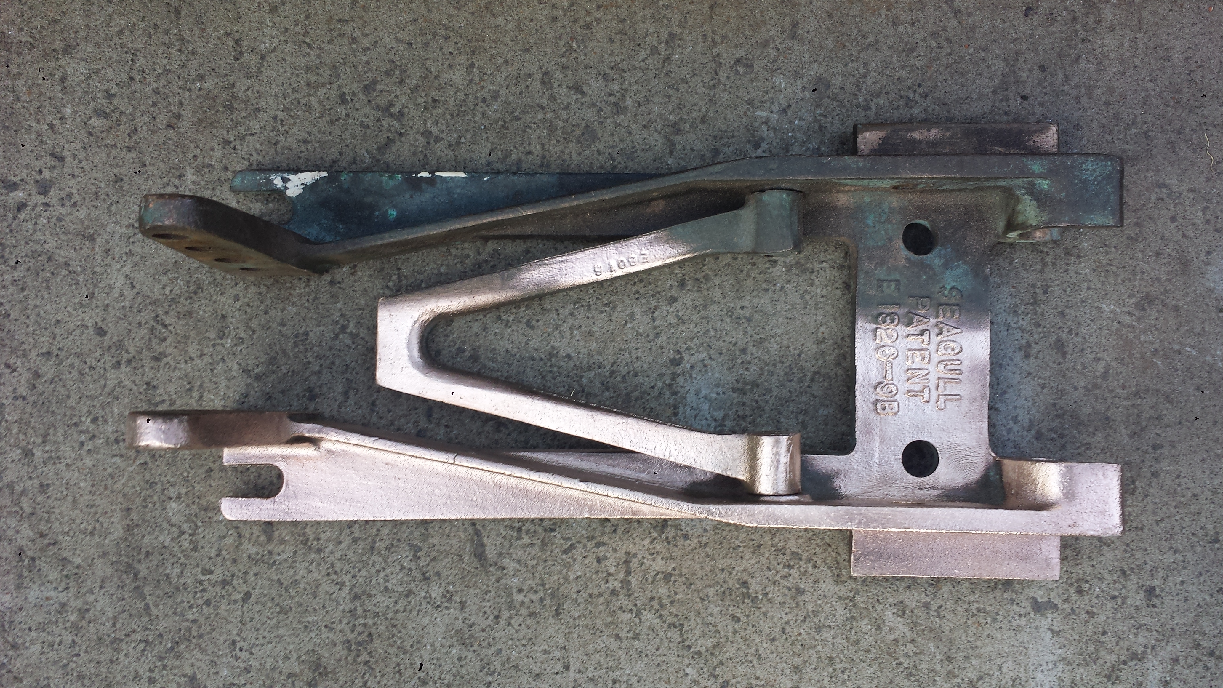

After leaving the bronze part in coke for 24hrs it had little or no effect, it is currently soaking in vinegar till tomorrow night.
The one that turned pink i have since wire brushed and is looking perfect!
I will get pics up when finished.
Jacob
