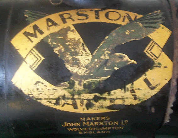

I need a good set of clear photographs of the decals that i might be able to copy for mine (ex A-J's)
This tank is in very nice condition considering its age.
Anyone heard from H-A recently as i'd like to talk to him about re-doing these older decals.Mine hasn't got anything left of the decal so i'm going to have to start from scratch.

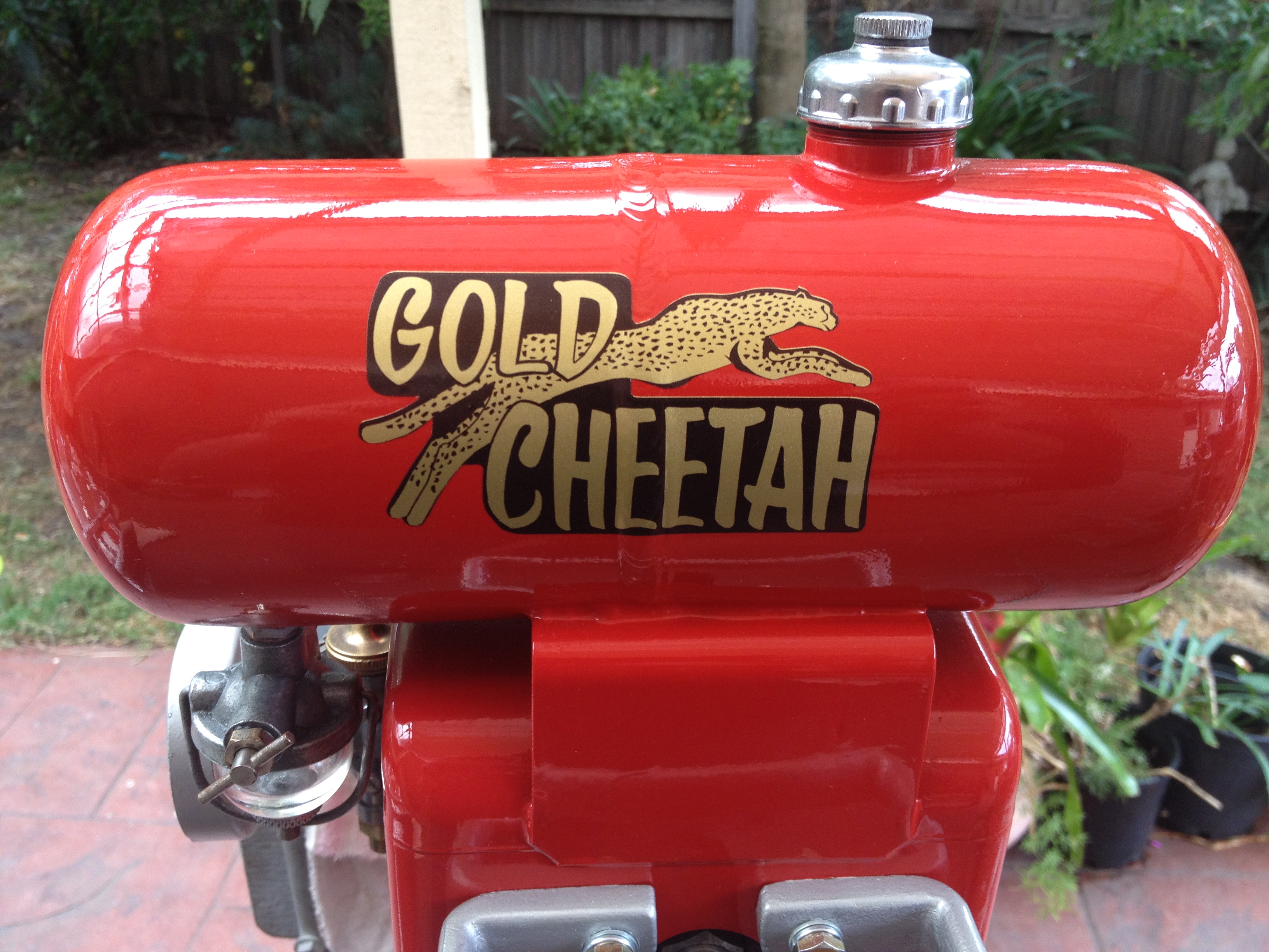

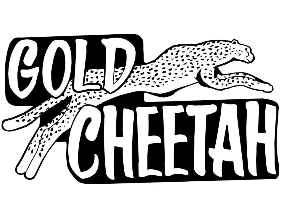

Have recreated several decals thus far using basic software tools such as MS Powerpoint etc, but they are never quite the same as the originals ie particularly when unique font styles and graphics are involved. Huge time investment required, for example I have approx. 22 hours in this Gold Cheetah reproduction decal. Sections of the original I copied from were missing so I had to improvise there. I also had to improvise the dots on the Cheetahs coat as it was impossible to copy those from the original decal ie due to their size and varying shape. End result is close to the original but not identical to.
Reproduction artwork
And printed on to extra thin layer of Gold Vinyl. I have printers use this because it is of similar thickness to the original decals which were generally water slide, and because it forms easily around surfaces that are not flat.
Lots of time and patience required.

It should be a flying seagull on my one.
I have no idea what it should be as i can't find any decent pictures yet.

Any use?
