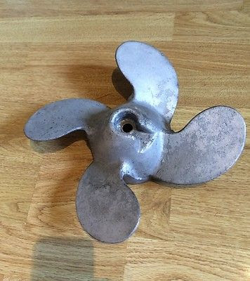

The prop looks like this. ..

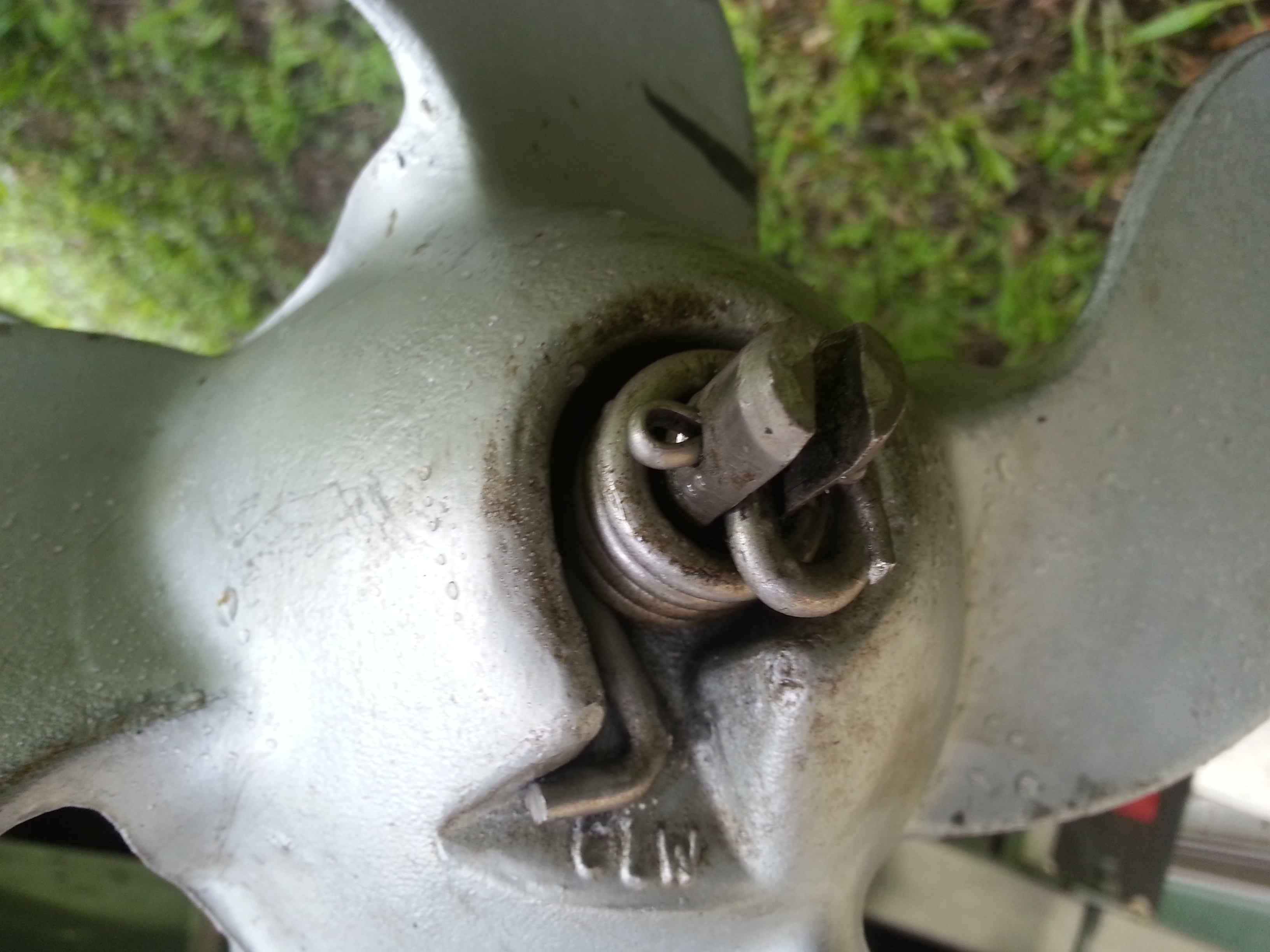

So I have a 'weedless ' on there? Is that 'wrong '
I will still snap that pic for clarification.
Al.
Re: Not really the right seagull?
Your prop should have "CLW" cast in the spring notch.

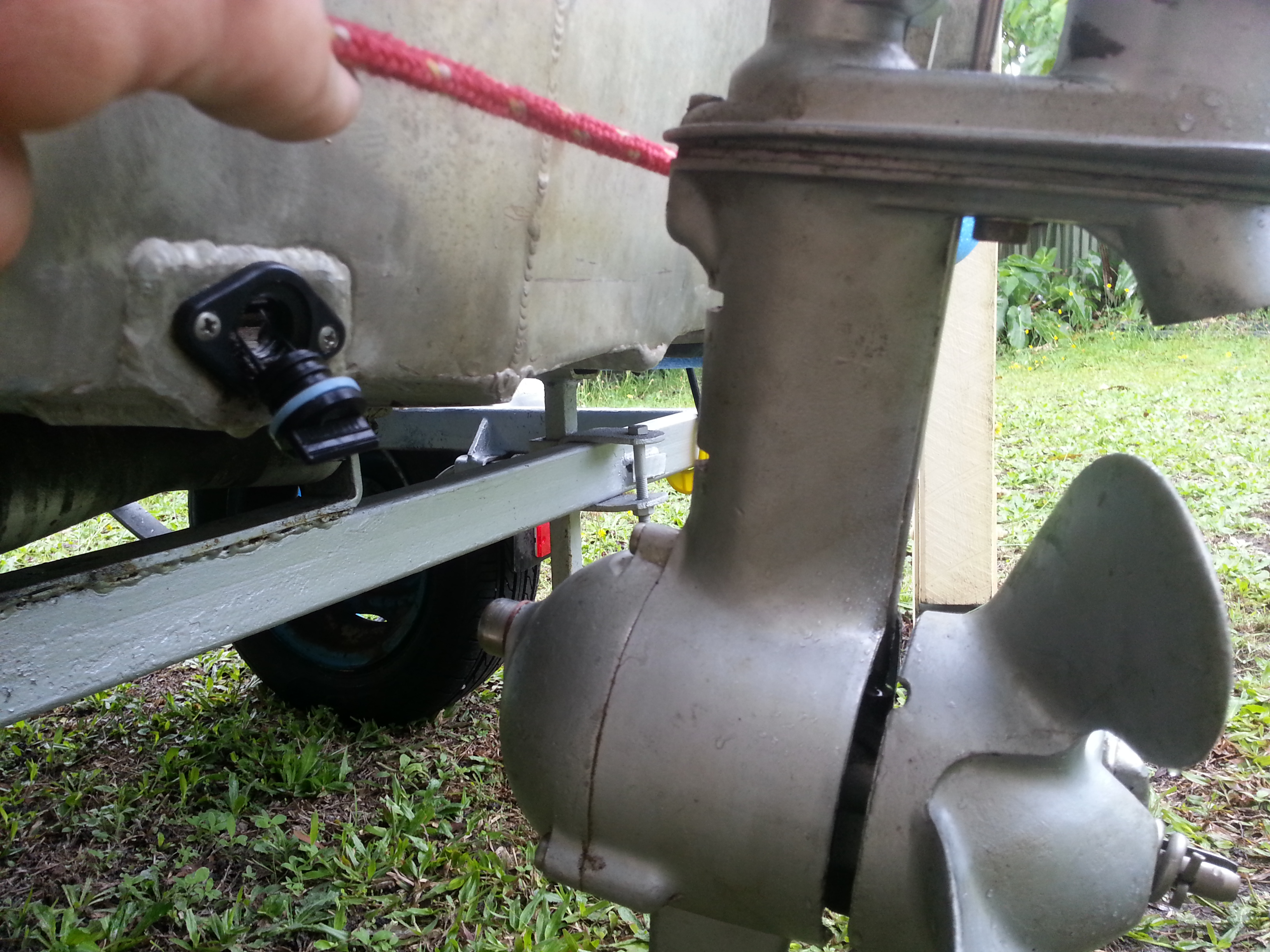

Anyway. Sorry for the delay , my phone went for a swim. As promised, here are some pictures (excuse bad camera on phone )
Prop
Prop
Prop

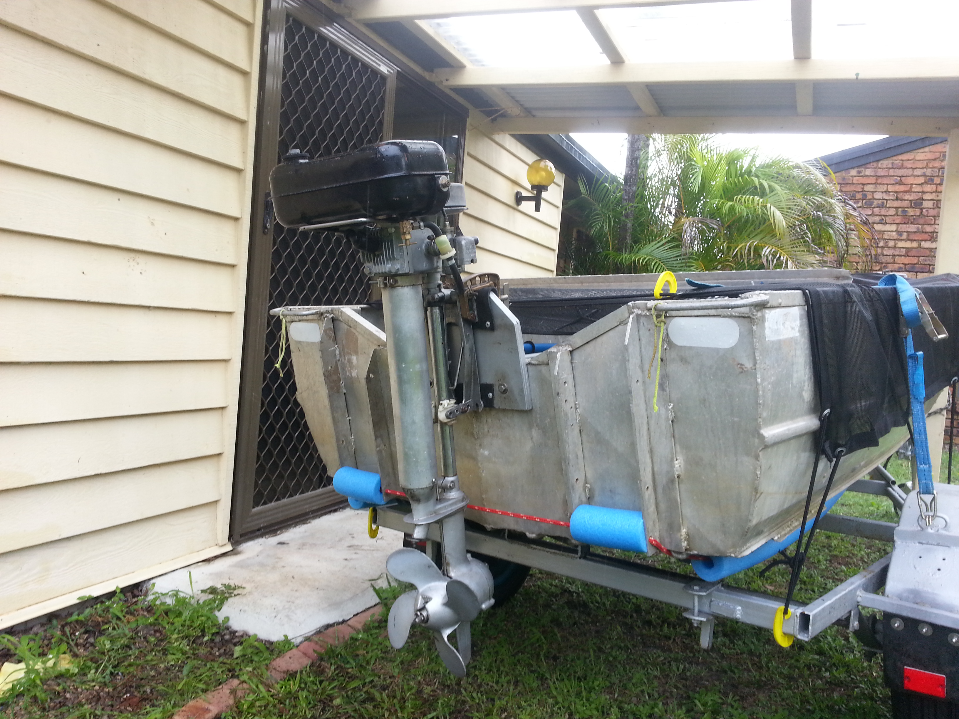

Current height
Current height

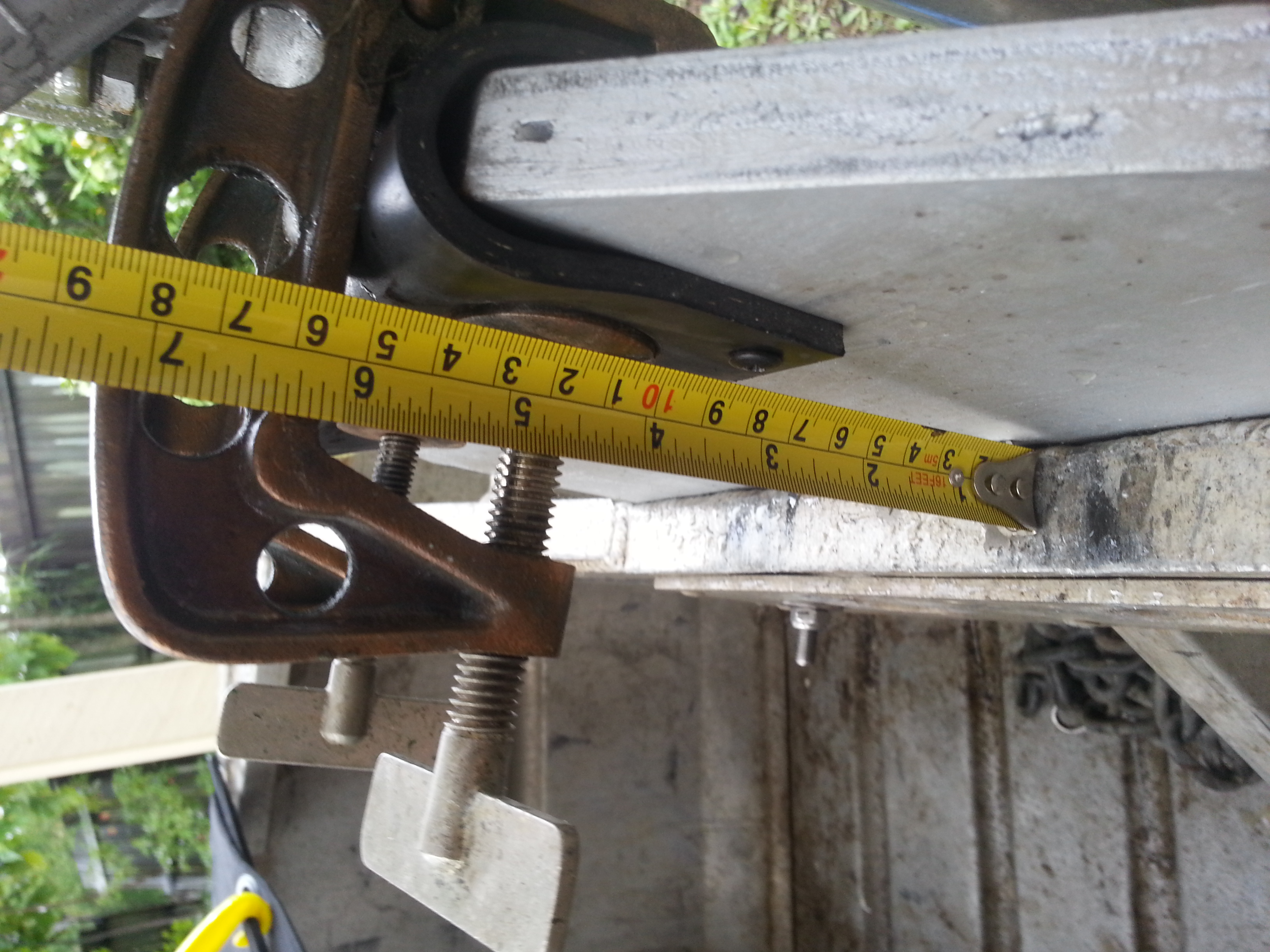

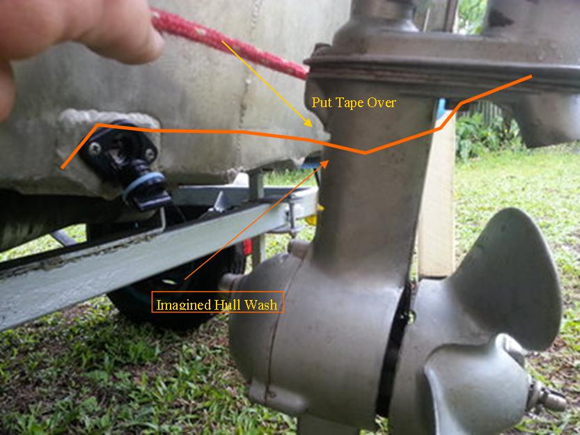

I have been experimenting with different mounting heights . This is where I am currently which might be a little high as...
Water inlet.
Water inlet.
The higher cooling water inlet is above the bottom of the boat (although still well in the water)and I am no longer getting my nice thick water flow right through the rev range.
As you can see though, this is a fair bit higher than I originally had it on the boat's standard transom.
Above transom.
Above transom.

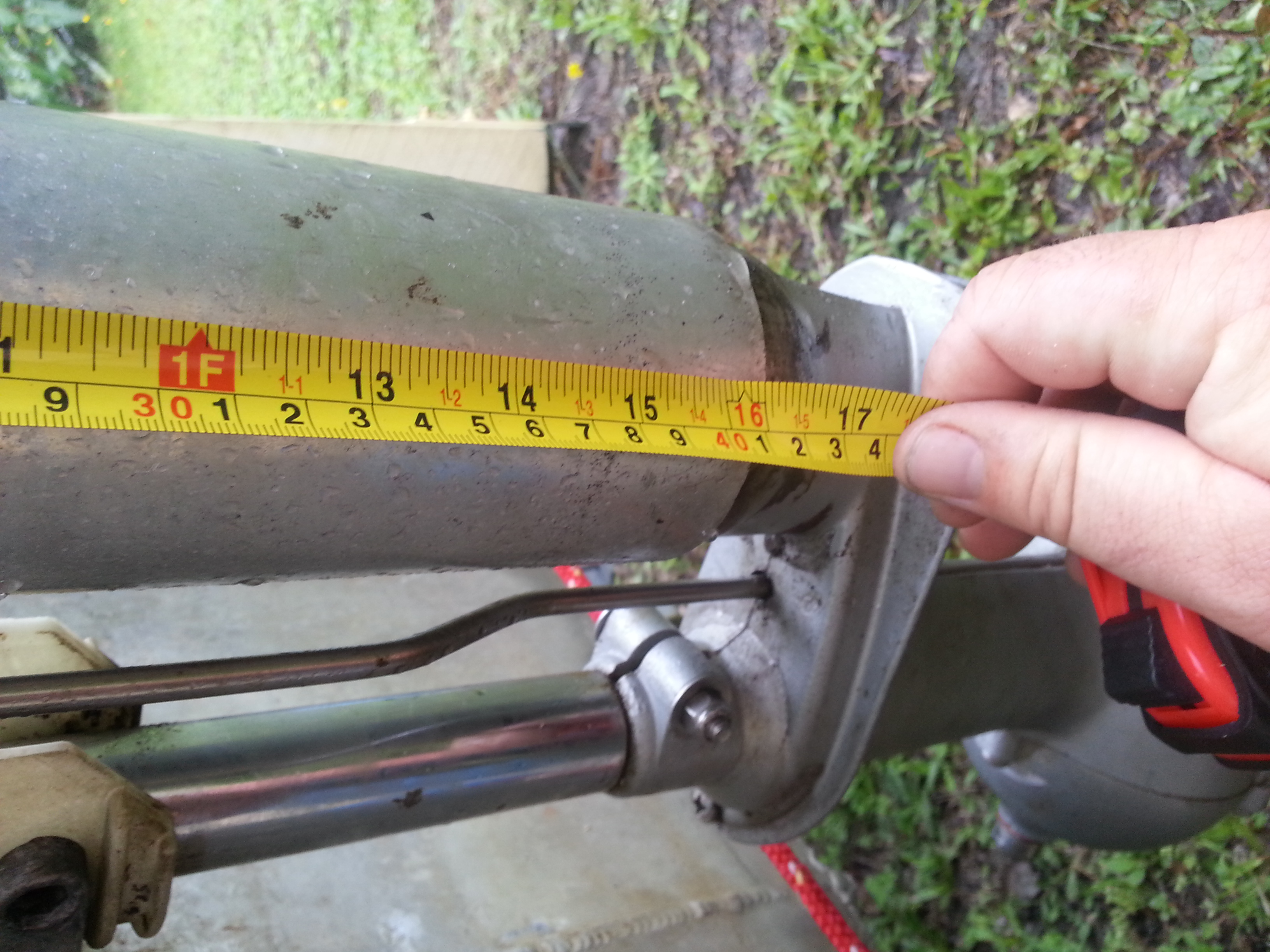

Also. Here is my exhaust tube length. Is this a standard long shaft or has it been modified?
Tube.
Tube.
Apart from seeming to effect cooling flow, where I currently have the motor will get me a choppy 8kmh one up in the boat. That's just fine but I want to fine tune. :)
Blocking the holes in the exhaust tube will make a big difference!
Not sure what putting foam in the carb will do.
There is a 5 blade hydro fan that will fit that gearbox that Might make it a bit quicker...
There is a pic of one in this thread. (first pic of a prop)
viewtopic.php?f=2&t=5592
"The higher cooling water inlet is above the bottom of the boat (although still well in the water)and I am no longer getting my nice thick water flow right through the rev range."
Ok do as below and try again......
