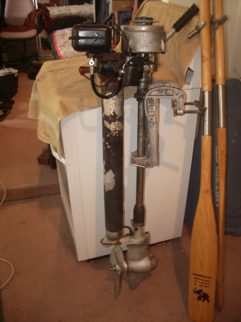

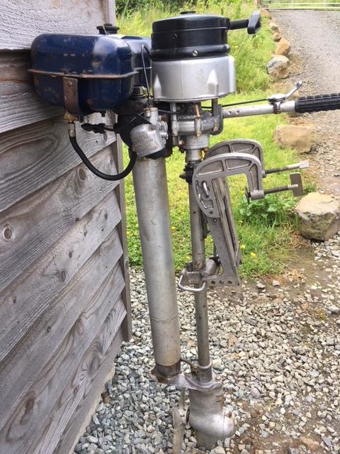

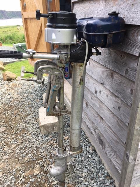

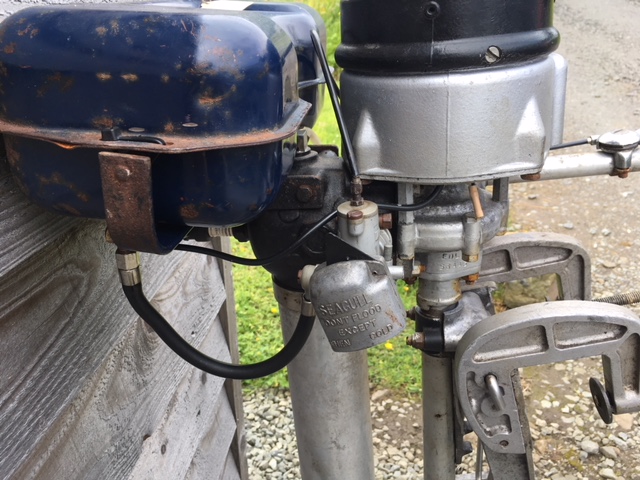

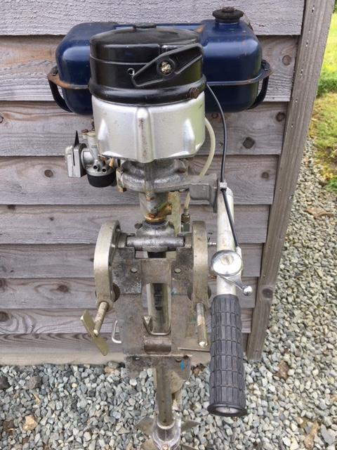

Hello everyone,
As some of you know i am lacking a proper project for the first time in months, the Model 75 i will test start tomorrow which has been my main project this year.
Recently my EDL 53AA3 has been lacking some attention since i took these photos (6 months ago) i have put proper tank mounts on it and thats it.
I personally like my motors to show patina and therefore don't usually restore them but i wouldn't mind trying a complete restoration and tought my ED would be a good candidate for such work.
I cant make my mind up though, which is why i'm asking, should i restore it or not???
Jacob

That won't take a lot of work Jacob, a little paint & a once over of the transom bracket & thrust block!

Leave it as is. Dont mess with it

Tough choice Jacob.
Here's what i'd do.
Steel fuel tanks are known to corrode so perhaps a first port of call would be to address the corrosion inside and outside of the fuel tank. Paint and decal to suit to finish it off.
Exhaust tube will polish up easily with some elbow grease, same with the tiller.
Ignition covers/recoil shroud in my eyes at least should be the same colour. Your choice whether it's black or silver.(silver/grey i think would look correct for the age of your ED)
Gearbox and prop would also benefit from a fresh coat of paint.
Replace anything that needs renewing.
If funds allow, the drive tube could be re-chromed.
OR
you could just get the motor into a condition where it runs reliably, that the rusty bits aren't going to rust any further leaving you plenty of time to decide what's best for it.
That wasn't much help was it?

Yeah, your right. I quite like it the way it is so maybe i will save my money (i'm broke the way it is). I should probably focus on getting my non runners running first.Charles uk wrote:That won't take a lot of work Jacob, a little paint & a once over of the transom bracket & thrust block!
Jacob

Sorry Jon you posted while i was typing.
Thanks to you
i have that steel long range tank and NOS leg! Cheers for that.
I like that patina of the tank that is on it as it has original paint, no decal though.
The tank we swapped has been repaired with body filler but i can weld it. Not blaming you in any way as it was impossible to see until i started stripping that tank.
Still not sure, any more suggestions.
Jacob

Transom bracket needs the minimum of the rubber thrust tube to avoid chrome against ally.
1 Kingfisher & 1 Century thumb screw, missing carry tube.
Was the drive shaft tube a fat one before you changed it?
What year is it? oops! Just seen the number, 1983, has yours got a plastic tank Hugo?

Charles,
I have one of the rubber things of an EFNR, i have also since fixed the thumbscrews to two century ones.
Driveshaft tube is the one that is small where it goes into the waterpump housing and where the transom mounts.
Also we decided that it was a 1993, from the old thread about this motor when i got it:
That makes it 1993 must be one of the last ever built, very interesting!
A3 1963
AA3 1973
A3 1983
AA3 1993
It couldn't be January 1973 as it an ED no CDIs then, so it must be 1993
Jacob
