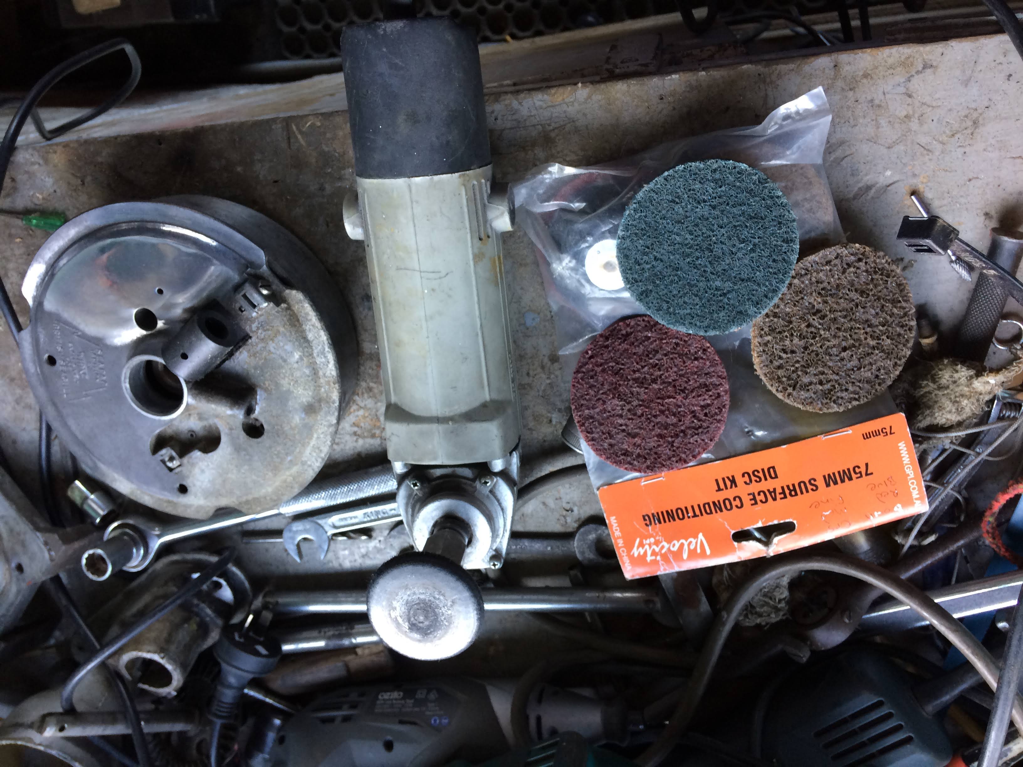

I use these to get the worst of the scratches out

I follow a similar procedure to that described by Nudge, but I tend to use sand paper instead of the discs particularly on the larger areas.
The reason for this is because it leads to a much more even surface, whereas the discs can sometimes take too much material away from some areas and not enough in others.
Flywheels and rope sheaves etc are just spun up on a drill press with sand paper held against the surfaces needing tidying up.
In all cases i might start with an 80 or 120 grit and slowly work up to 1500 wet and dry, before moving on to polish.

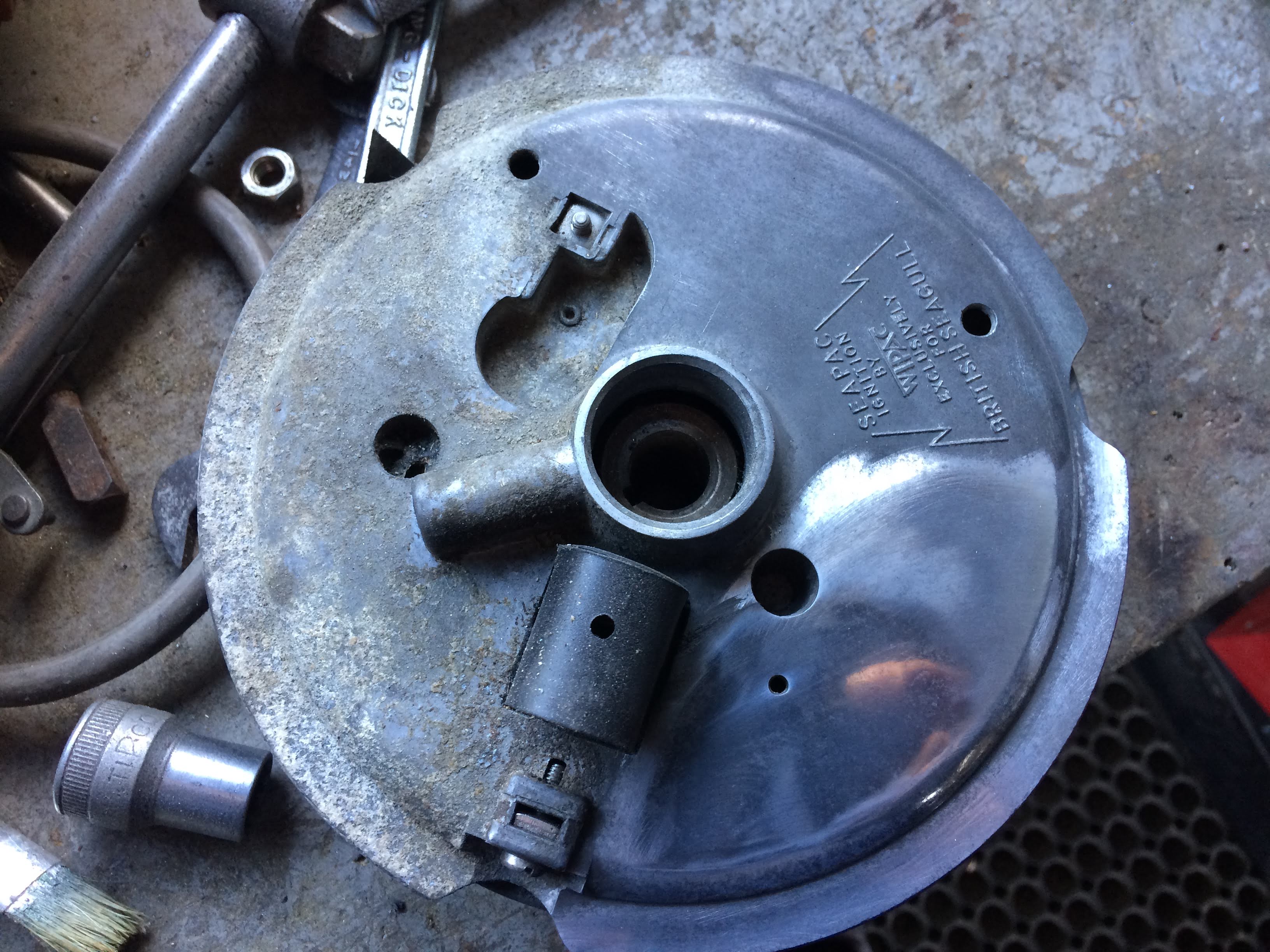

It took me longer to get the tools out than it did to clean and polish it up! :P
Now Im going to have to clean up the other side. :roll:

WOW :shock: very impressive work, well done. Is there any chance you would mind sharing the procedure of this, as in which order to use which discs then wheels if you get what i mean.

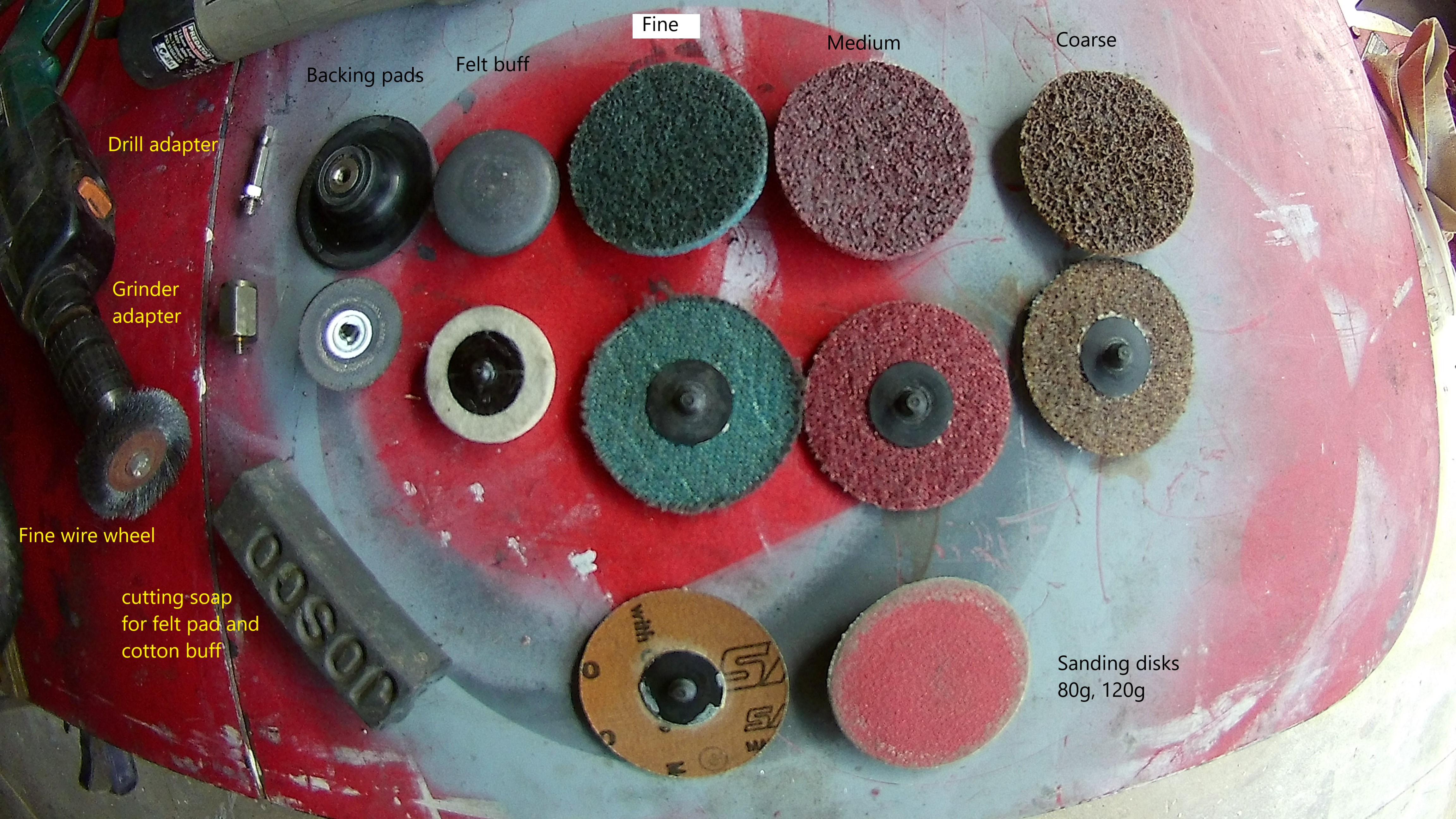

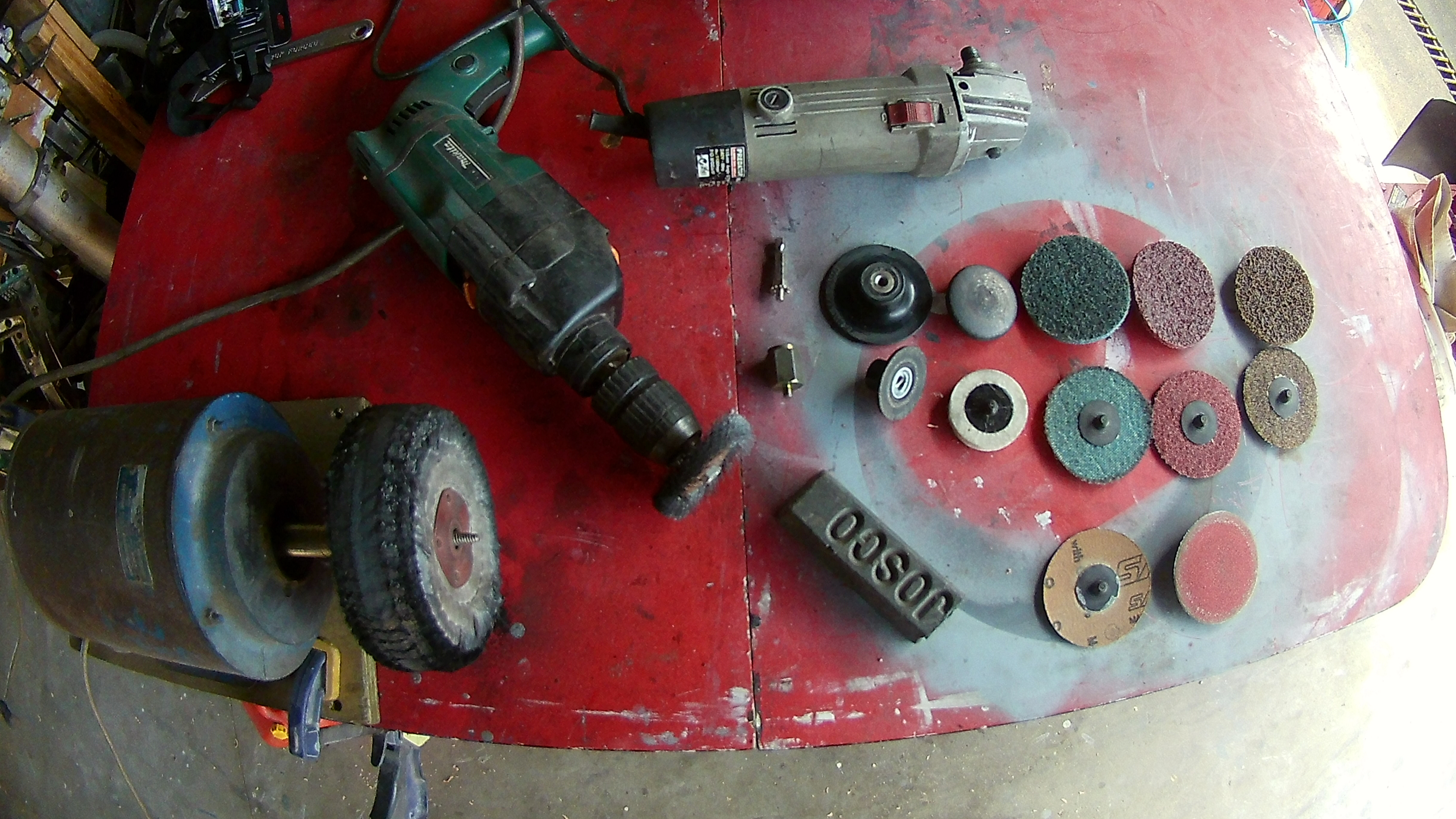

I had already used a fine wire wheel on the drill to get the dirt off.... it took longer with the wire wheel to clean up than it did with the polypads
There is no editing in the video!
The order to proceed,
Sanding disk (not required for this job)
Brown poly pad (coarse, not required for this job)
Red poly pad (medium, not required for this job)
Blue poly pad (fine, only poly pad used for the job)
Felt pad, cotton buff (to be used with cutting soap, use a little soap at a time and often)
