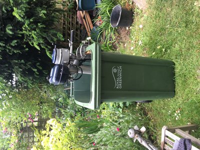

It's dependent on which type of ignition you have fitted to your model 90, black or white CDI.
A picture of the flywheel rim will tell us.

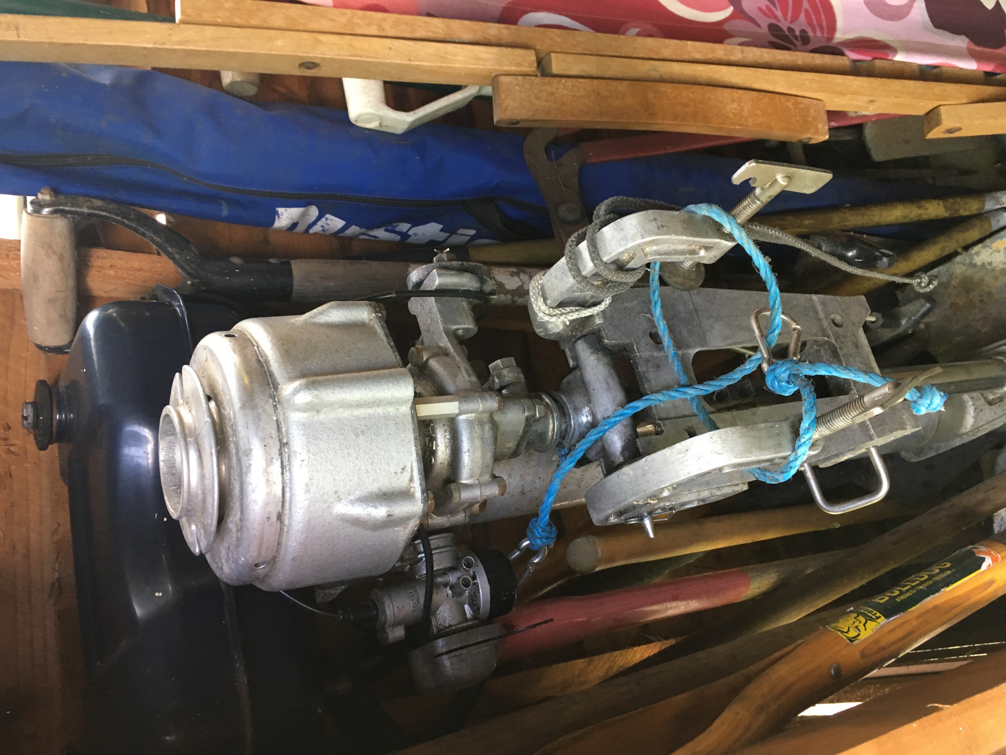

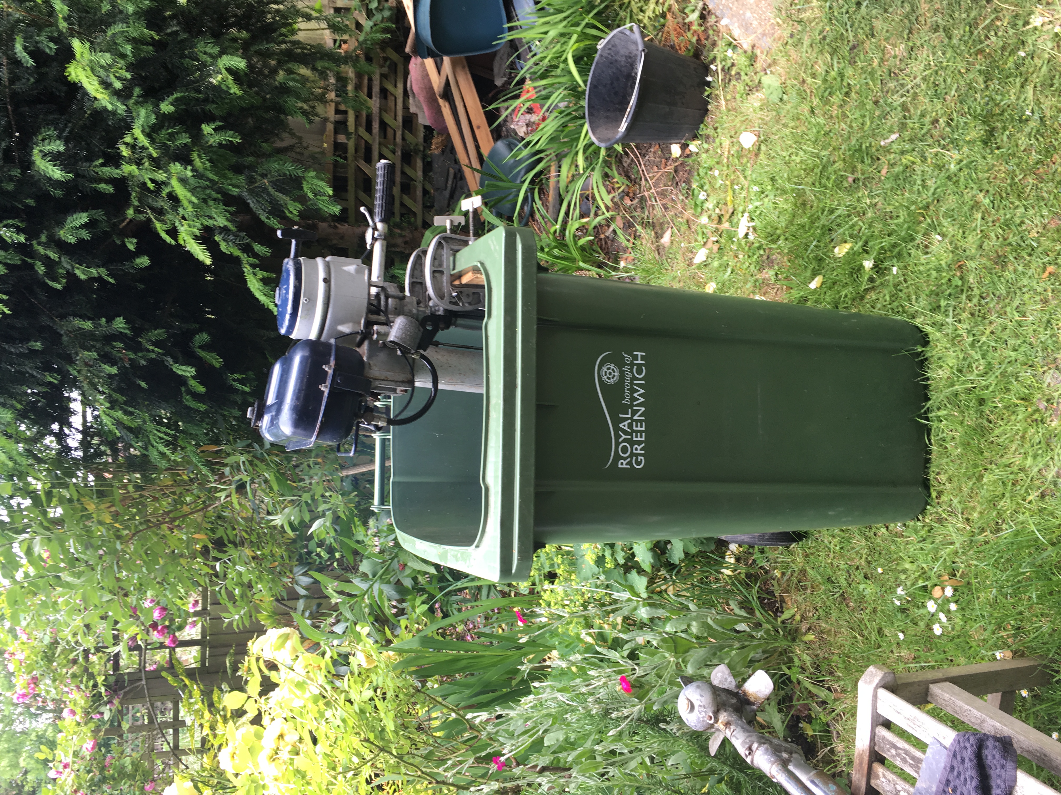

This is all I have today...
Thank you.
Mark
Re: Plug gap
Well the White CDI is 35 thou & the Black 25.
I run both at 25 thou & haven't had a problem yet.

Re: Plug gap
Yours is a factory rebuild & that doesn't tell us which ignition they fitted.
Remove flywheel cover & inspect flywheel rim,
no groove white CDI
groove black CDI
Run at 25 thou until your sure, as the black CDI struggles at 35 thou, & replacements are expensive!

Undo the 1/4" BSF bolts below the baseplate, these should release the flywheel cover & with luck you should be able to lift it enough to see the bottom 1/2" of the flywheel rim & be able to see a shallow groove 3/8" above the bottom of the flywheel base, if the groove is present you've got a Mk 4 Wypac CDI 25 thou plug gap.
