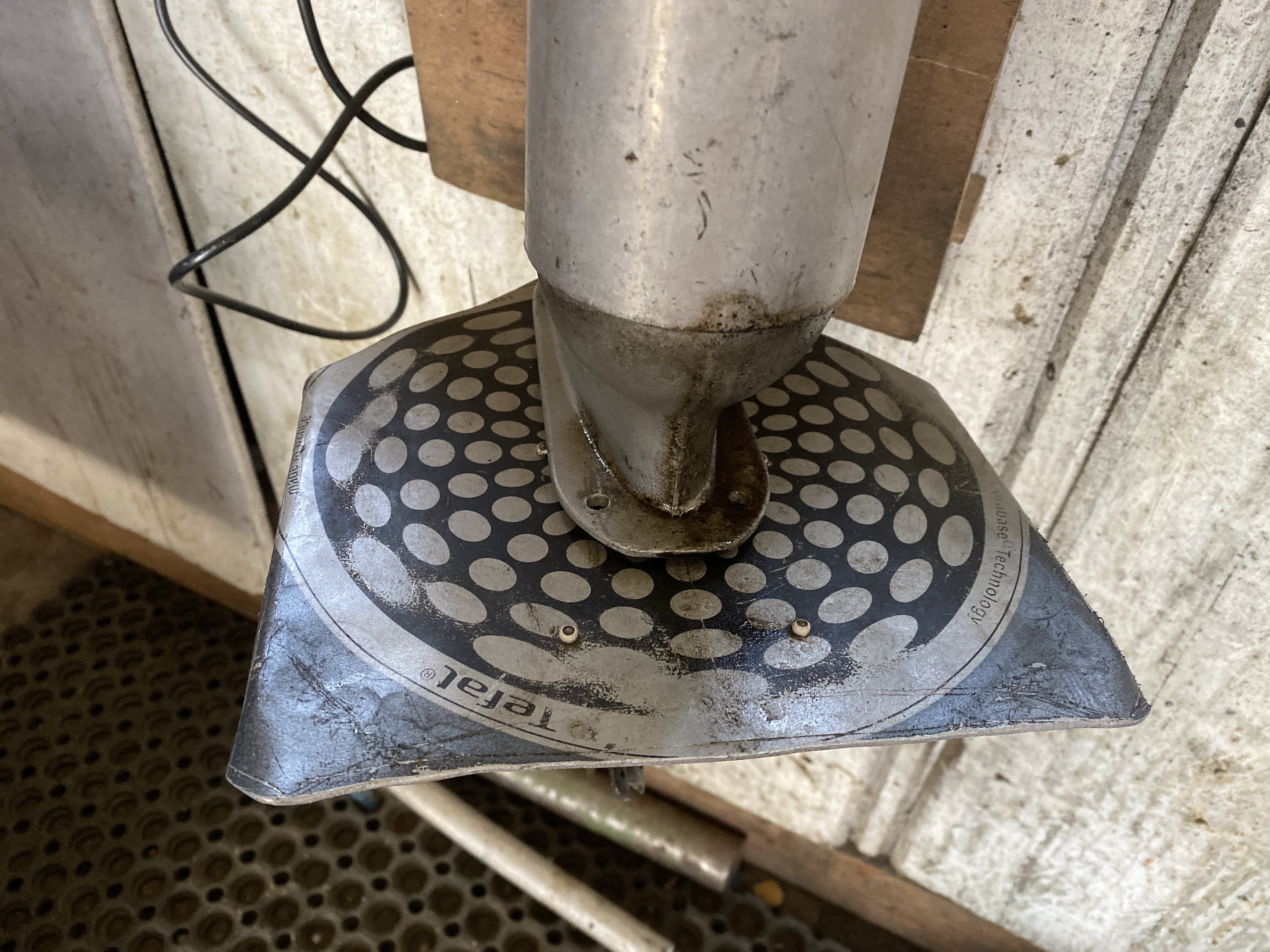

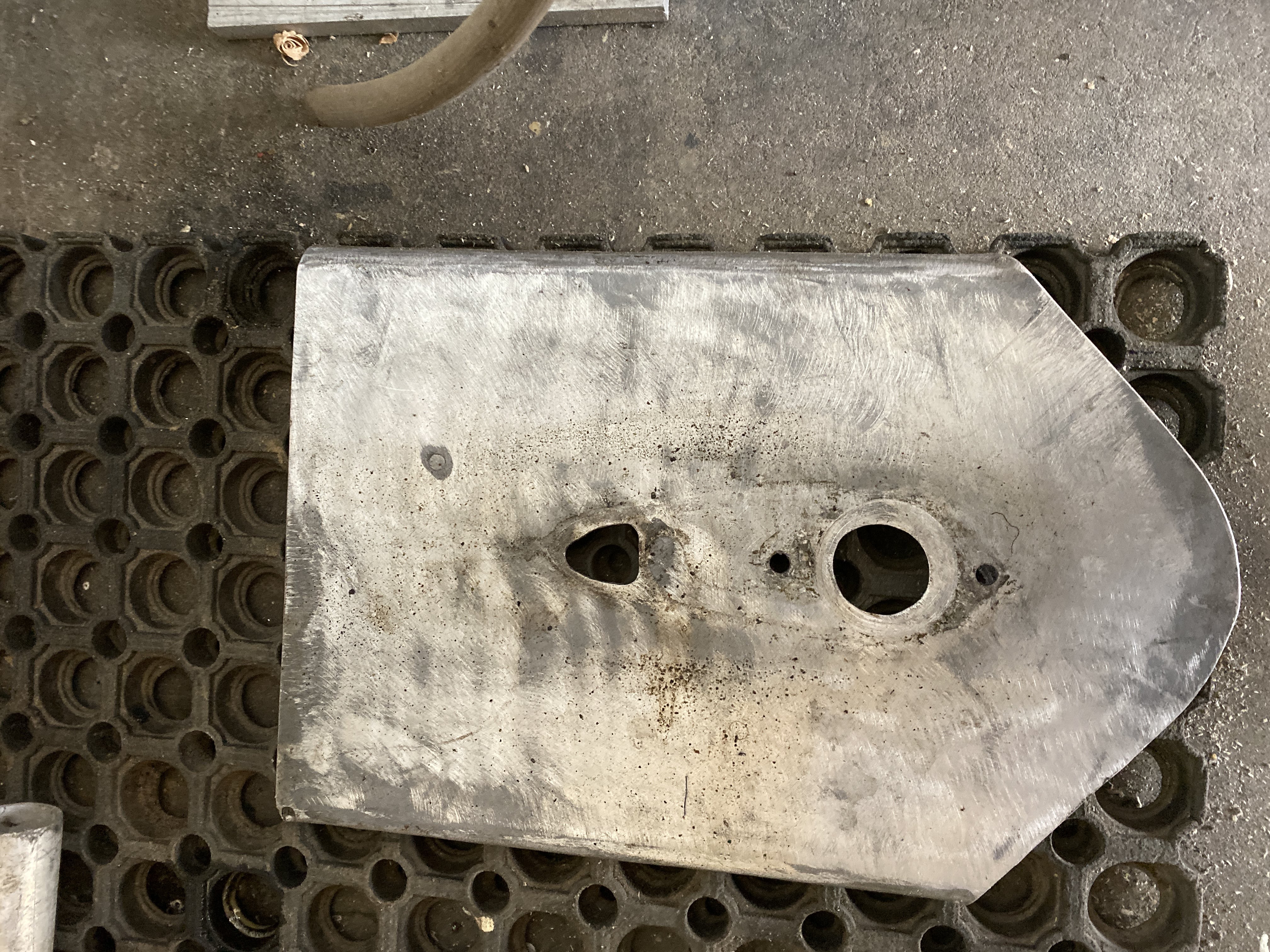

Thanks for posting , interesting link . Cool pictures . I see alot of competitors have added an extra piece to the anti cavitation plate .
Re: waitara river seagull race
Yes I do this also. by doing that we can run the engine a lot higher in the water with out the prop grabbing air (as much) the higher the engine the less drag it has = the faster you go.

That's interesting , I have considered trying this to aid going astern in choppy conditions . I'm just reluctant to drill holes in an almost new engine for an experiment !
Replace the water pump gasket with a 3mm aluminium plate , make the holes the same size & location as the gasket, use RTV to seal it.
Make it giant to start with, you can always make it smaller.
I fold the wing tips down as a skeg/stiffener.

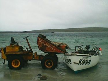

Won't win any races with this one :lol:
You have every chance to win a race with that boat. I may just have to drop my motor over the side first! :lol:
Maybe if you didn't fill it with sand from that tipper it might go better! :mrgreen:

what gear box motor have you got? I will get a pic of my setup later for you

Pics of the "Pan" Has to be of the non stick type to work! :roll:
As Charles said take the gasket out and put the pan in its place
The white one is for the 20'er

Nice ! Thanks for the pics , do you have a patent on these ?
I bet he doesn't eat a lot of fried food!
Told you these Kiwi's were sneaky!

I can't survive without my bacon and eggs , I'll need to source an alternative material :lol:
