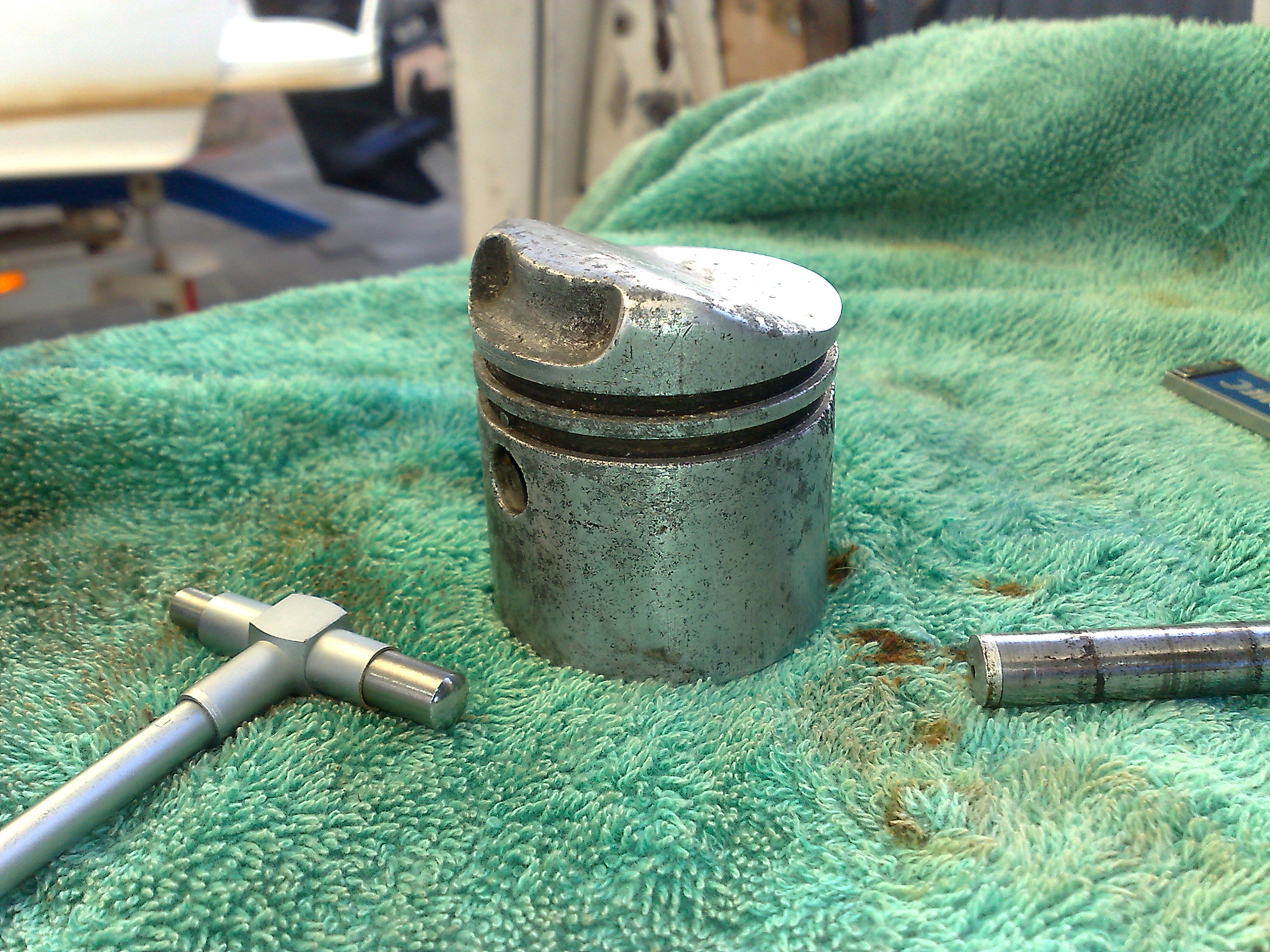

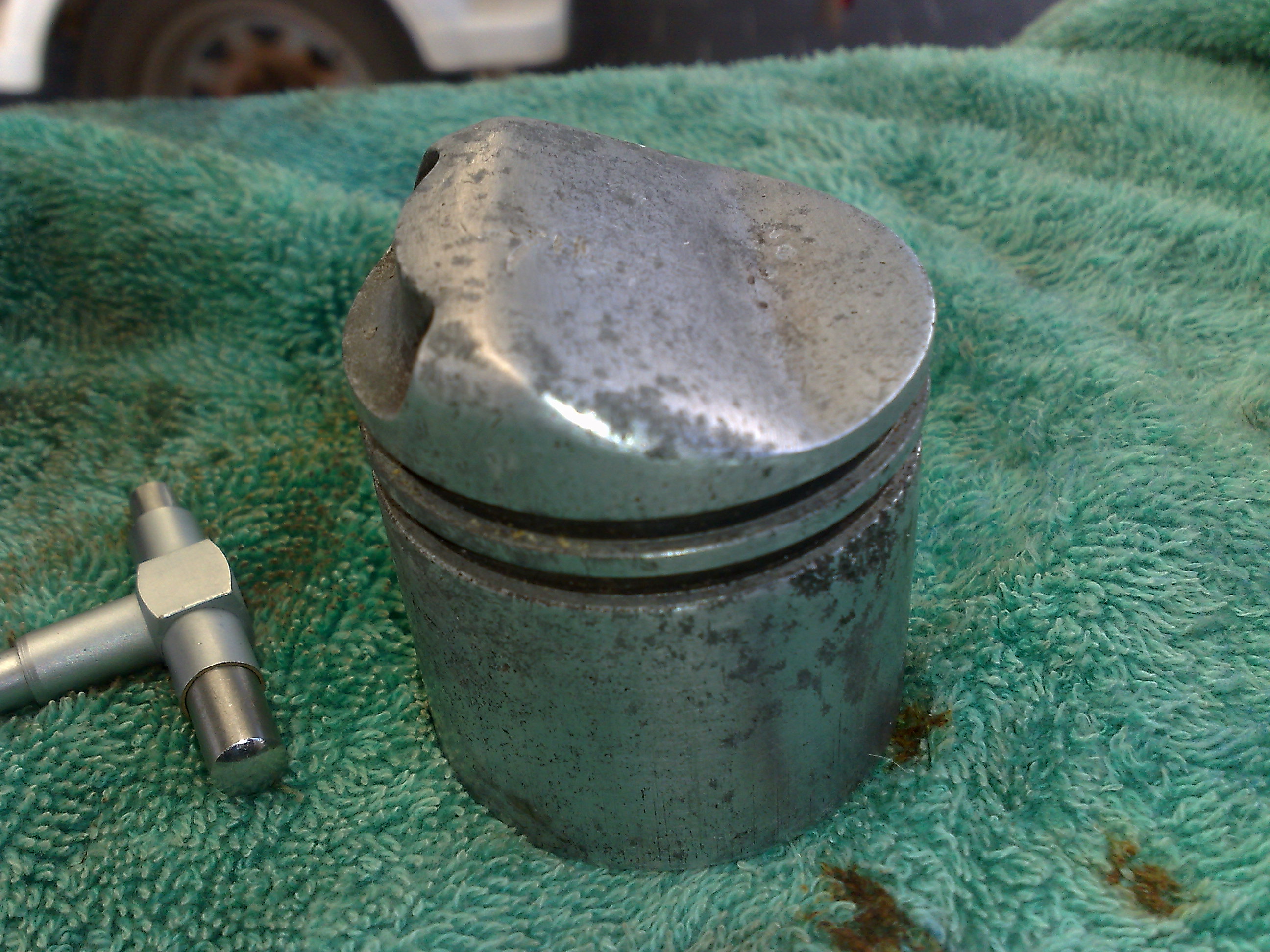

Can you post a picture of the crown of your Marston piston & the diameter of the wrist pin, as I've never heard mention of over size pistons & cylinders.
I've worked on more than 25 Marstons of all flavours & provided tech support for many of owners on the register & just wonder if someones tried fitting a piston from something else when reassembling .

Re: OA Parts
Yes I can Charles.
Piston is 49.70mm diameter
Pin is well worn 9.49mm to 9.47mm
I feel more than happy now the old dear may get sorted in this regard.

Re: OA Parts
Well that's a standard early OA Piston.
I've lent my bore micrometer to a mate, I'll get it back & measure the bore.

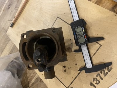

Thank you Charles
My bore is 50.66mm by the way.
Remember back so many years ago we had a chat about there being a crankcase gasket between halves?
This is the reason for that.
Diameter to big.
Thank you for the help in this.
Diameter to big.

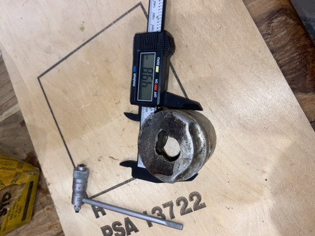

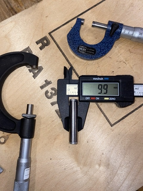

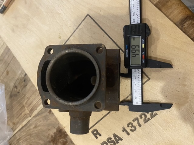

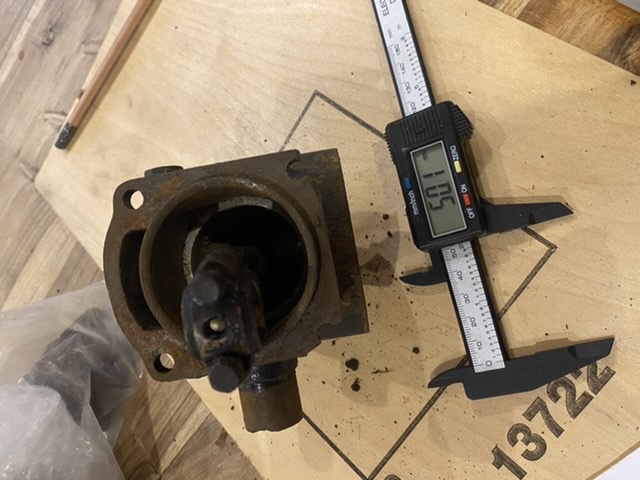

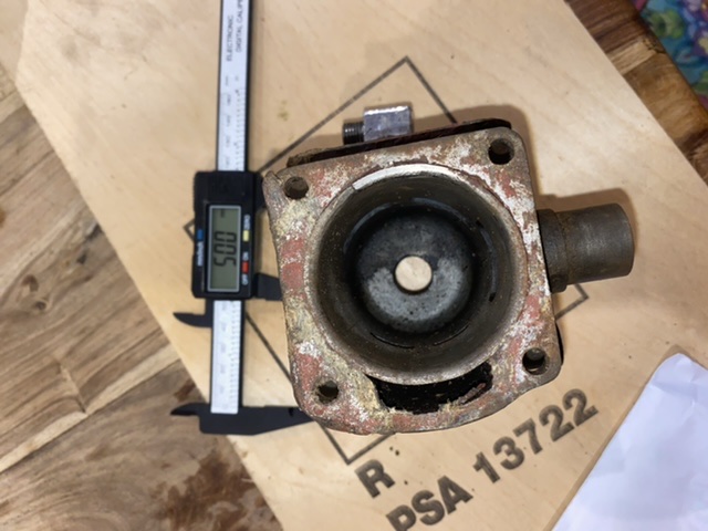

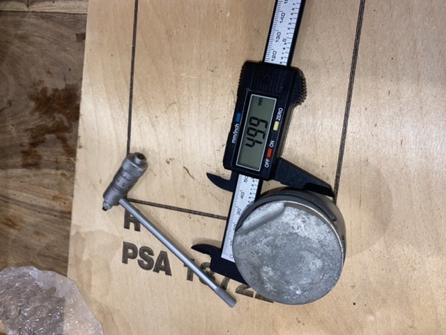

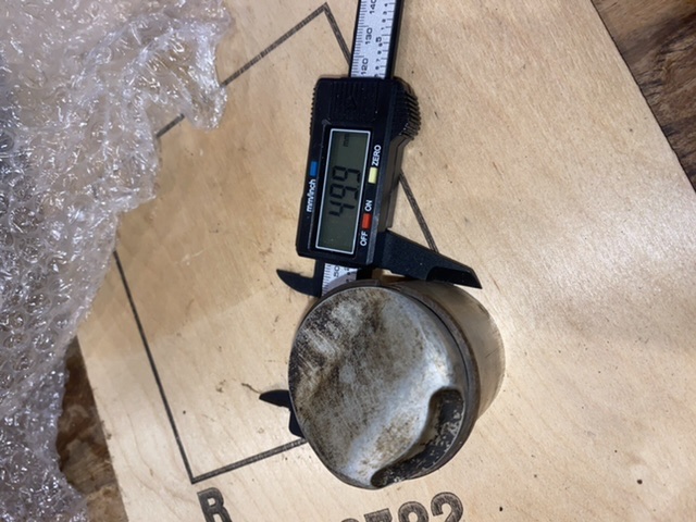

Re: OA Parts
I’ll have a look, I’ve got a couple of spare pistons, slightly different from each other, I’ll measure them up. I’ve also got several cracked barrels which I’ll measure out of interest as I’ve never really taken any notice, when I strip an OA I tent to clean up the bore and piston, pop the rings in the bore, if worn I replace the rings, get the ring gap correct then reassemble. It’s never occurred to me to measure everything up if all looks well.
I’ll get back to you with the piston measurements.
Re: OA Parts
Here are some sizes it pretty much any piston will fit any barrel

Re: OA Parts
Thanks for this.
Pics and details not often seen like this which is extremely helpful for everybody.
My barrel 50.65mm is obviously the problem.
Hepolite 14465!
Nice to know that my friend.
Very
Hepolite 14465!
Very
