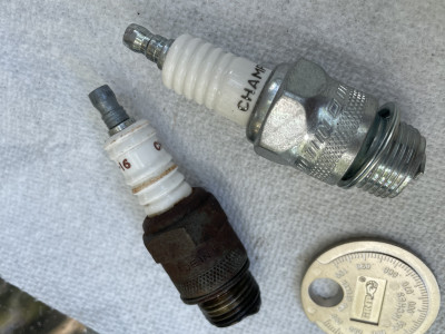

I was able to clean some of the grunge off the engine today, and managed to find a D16 spark plug.

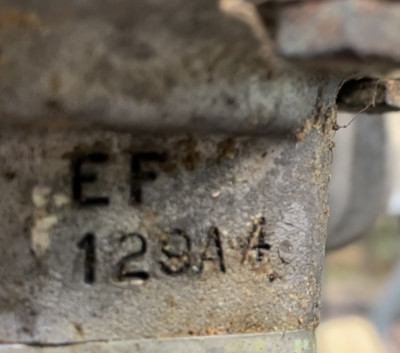

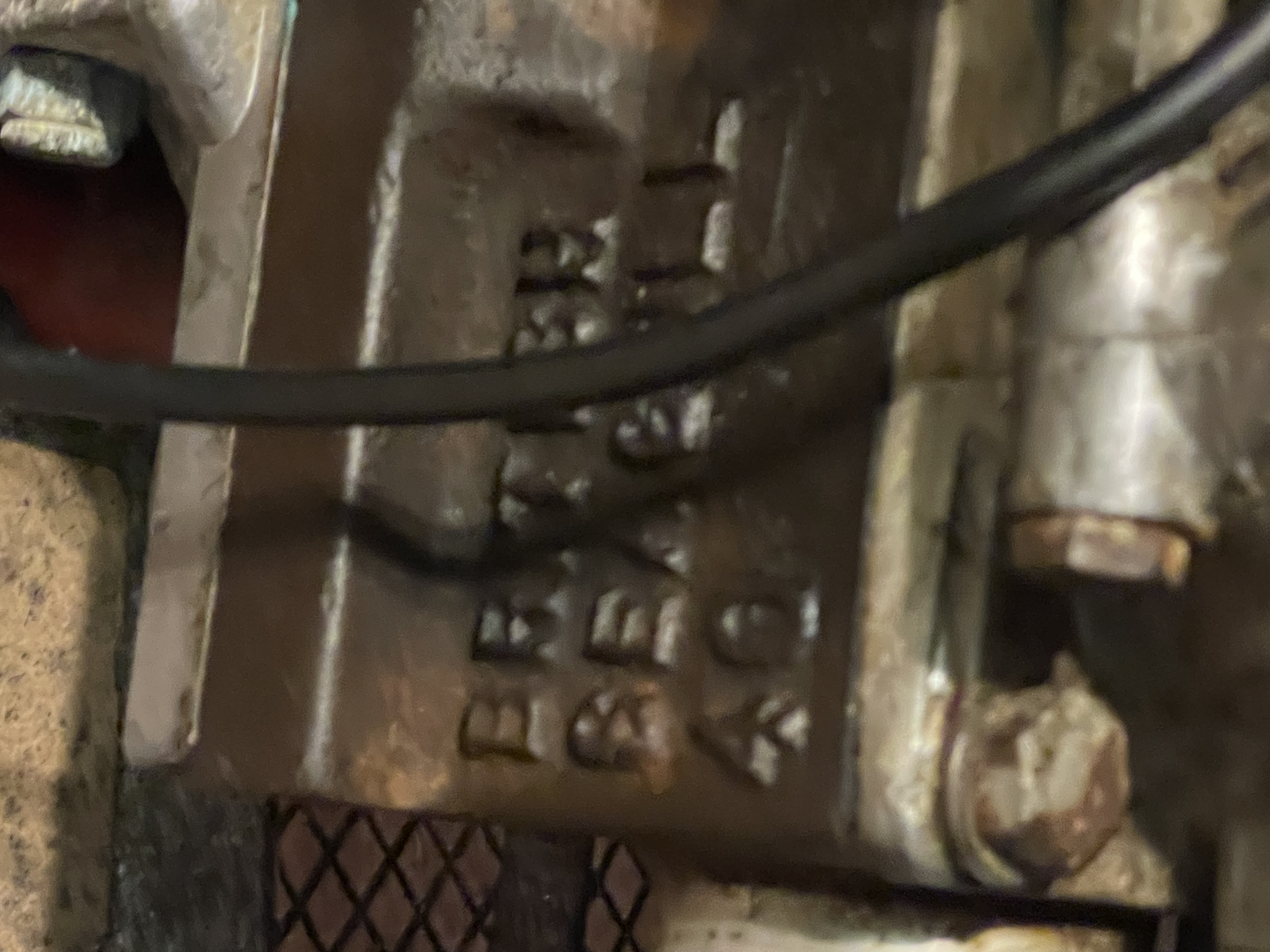

Bill can you post the serial number serial number from your 40 as that looks like a CDI ignition, can you also post a picture of the gearbox end cap, so we can count the screws, that Andrew was talking about.

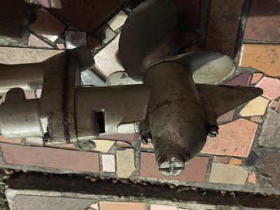

Hopefully I’ve photographed the correct bits!
The serial number is finicky … in just the right light it’s
EF 129A 4
This unit has a plastic cap on the top with a pull cord storage spot… I haven’t seen that in any other photos of Seagulls.
Let me know if you’d like more images!
EF 129A 4

Looks like EF129A4 to me!
Interestingly the SOS engine identifier struggles with that serial number, date code (A4) suggests Jan ‘84 but EF model range indicated at 1985-1989. Sometimes the serial number stamps aren’t exact, they were done by hand I believe. Perhaps Charles or another member can chime in on this. My best guess is that it was a Jan ‘85 motor misstamped as A4 instead of A5, ’A’=Jan and ‘4’=‘84. It was first month of the year and perhaps the stamper still had the 4 on the bench.

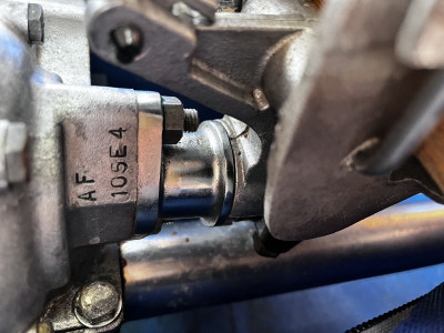

I have AF105E4 which is same featherweight model and very close in vintage to yours, May 1984 according to SOS engine identifier, mine with with the Amal 416 carb and steel tank. Bought from a guy in Tampa area who got it new in Florida in the 80s. Also have the plastic cap on top of the flywheel, that was used when the recoil starter was not fitted. I’ve fitted and removed recoil many times, mostly for vanity as it always works just fine with a pull on the regular cord.

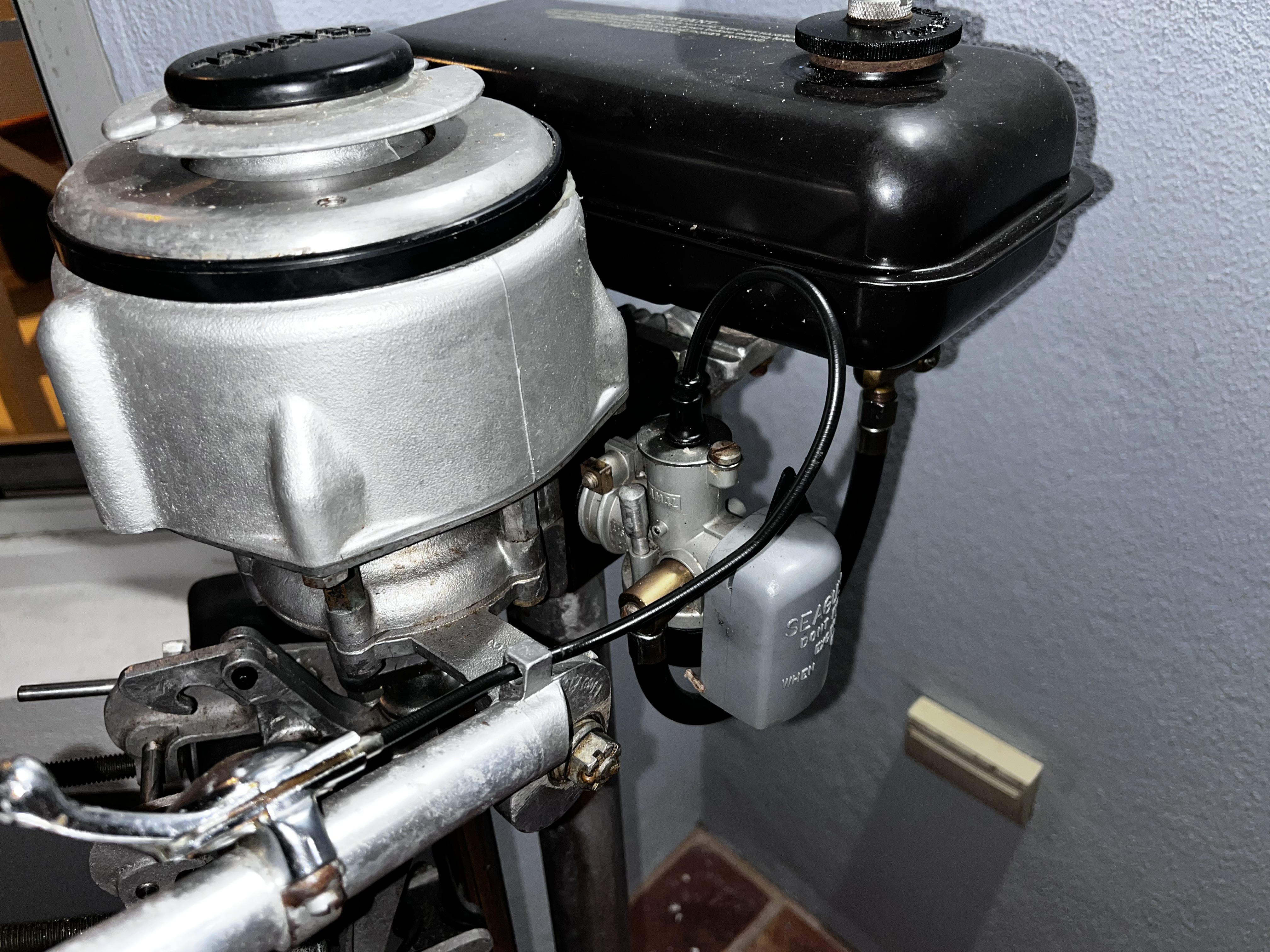

PS bonus points to anyone who can spot one misconfiguration and two unusual parts fitted on mine.

Now… for your challenge… I did spot something that is either misconfigured on yours or on mine… your throttle cable feeds through a hole at the end of the tiller.
Also, is the steel tank unusual on yours? I’ve a bronze tank.

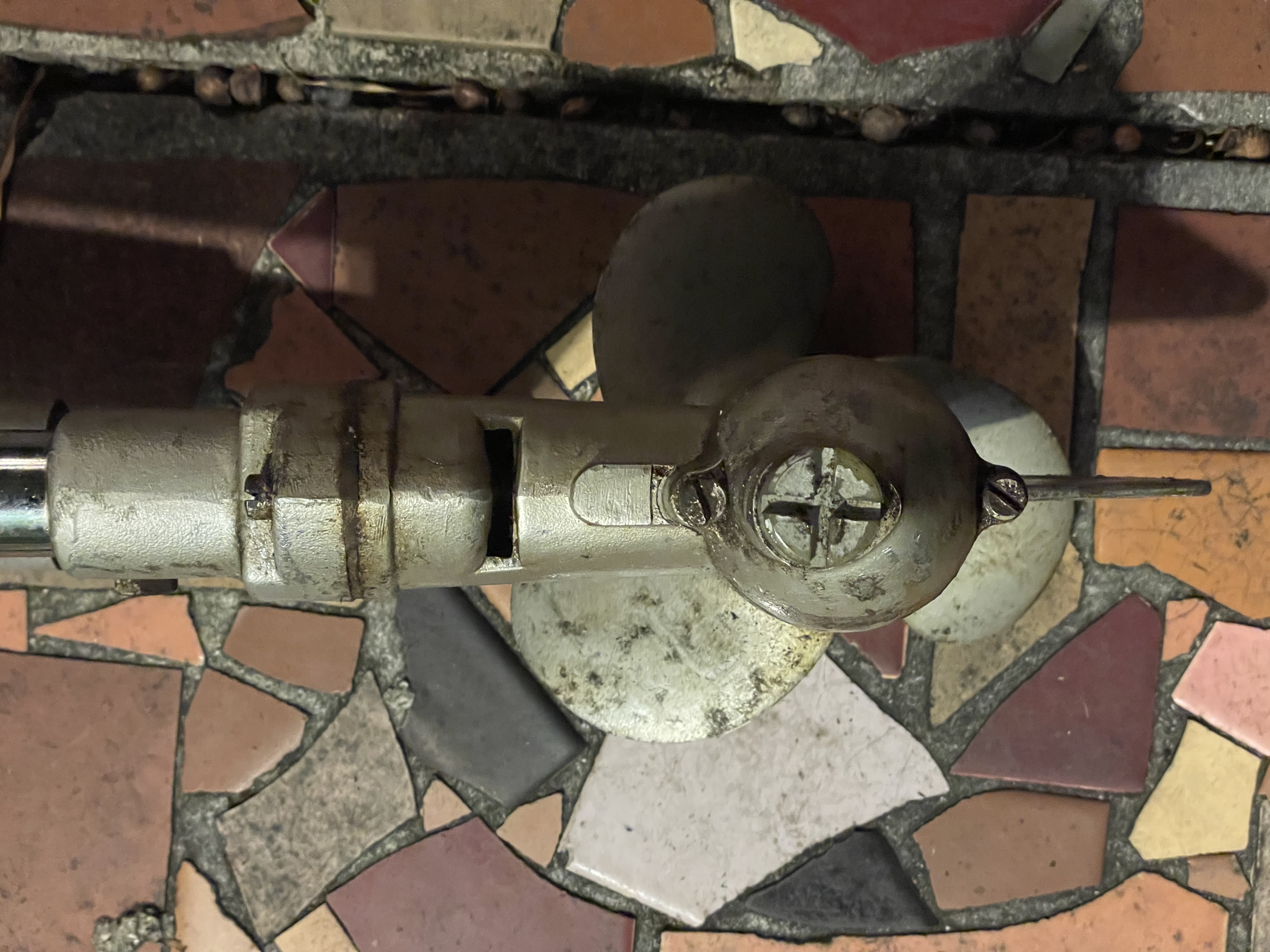

Andrew does your throttle cable have a kink where it's wrongly threaded through the cable wrecking hole?
Bill the fact that your gearbox the pinion locating screw just above the end cap retaining screw means as Andrew said, it's a SAE 140 box.

Indeed I noticed in my picture that the throttle cable is (incorrectly) threaded through the handle. No idea why I would have done that, probably rushing to put it back together after I used the carb to test another motor.
As Charles points out this will kink the cable over time, and it also somewhat messes with the idle.
Additionally my carb is missing the top piece and instead it has a stainless flat washer on there instead, held on with what I believe is silicone. It came to me this way years ago and surprisingly it works just fine. Never got around to replacing it. I also forked out $$ for the brass banjo fitting that connects the fuel line to the carb. After replacing so many of the plastic ones over the years I decided to buy a few of those online as a permanent solution. I tend to swap them between motors as needed.
I believe mine came with the steel tank. Many of those have not stood the test of time, however mine was very lightly used and stored properly for the years before I bought it, so it remains in good condition. My tank paint is still very good which really does help with the rust situation.

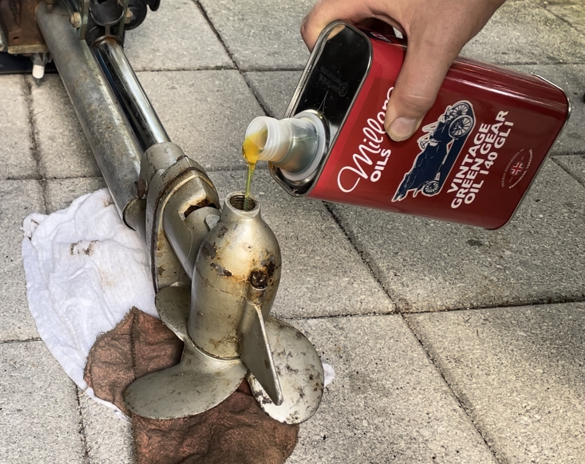

I believe I found a good gear oil - Miller Oils Green Gear Oil 140 GL1 - available from a distributor “Performance Racing” in the US- they sell on Amazon.
I’ll be changing the oil tomorrow!
I’m attaching a picture of the oil tin and a pamphlet that came with it.

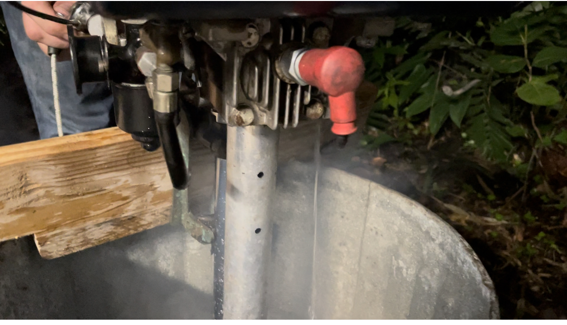

It’s running!

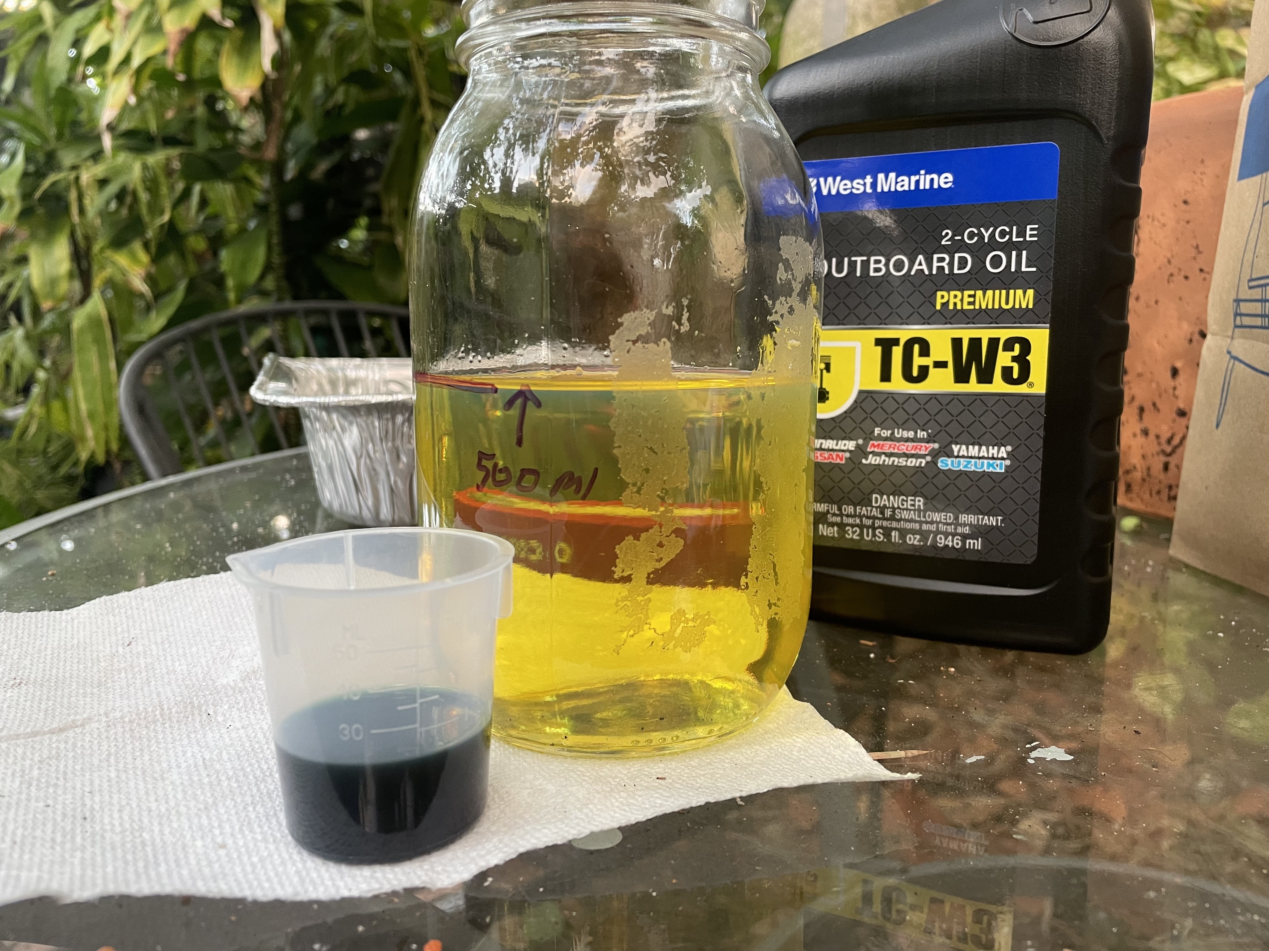

Re: About to start 45 Featherweight after 35 years —gear oil question
Andrew,
The fuel tap cork was a bit stuck, as you warned. But, knowing what was in there definitely helped. I loosened it by prying a bit from behind with the tip of a small straight screwdriver. It came free without any apparent issues, and it’s moving more-or-less normally now!

How much oil did you fill gear box with.
Charles, I was very careful to follow the service manual… I filled to the top while set on the ground, spun the mechanism several times, then poured some more in. After that I mounted on a stand and let drain to the bottom lip and sealed it up. Advice if this wasn’t correct?
