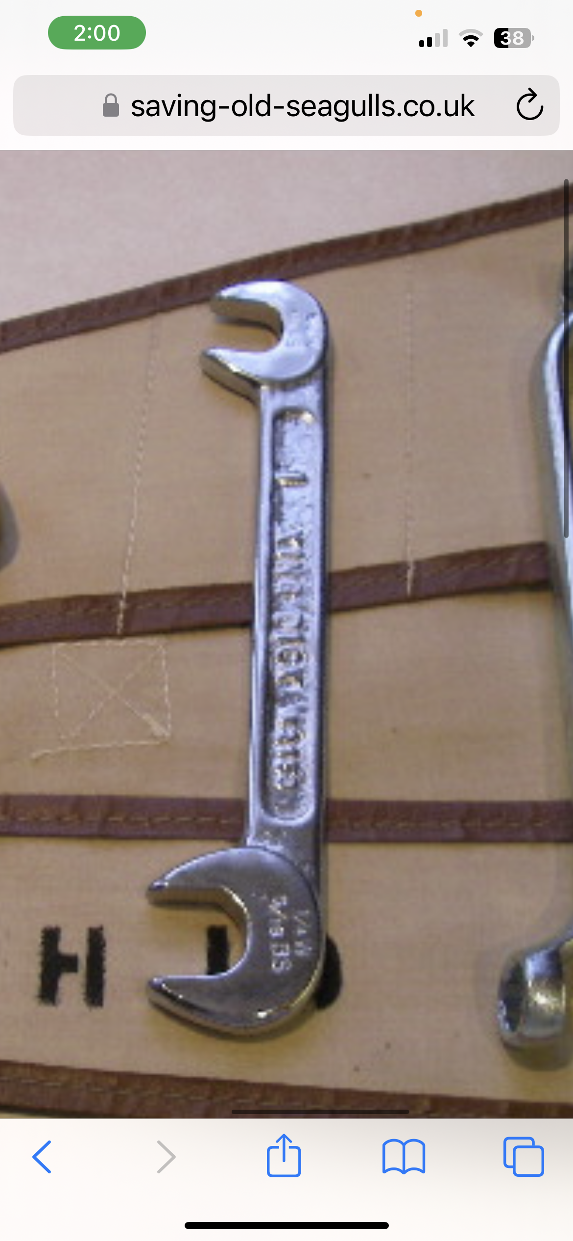

Has anyone found the best spanner to remove the top leg nut on the exhaust side? It is impossible to get a normal spanner or socket in there as the nut is so close to the leg on one side, and not much further from the exhaust on the other side.

you need a "1/4" BSF x 5/16 BSF OFFSET spanner", that's what Seagull used during assembly!

Not that hard....go to ebay and search 1/4" BSF x 5/16 BSF OFFSET spanner.dartmoor wrote: Fri Jul 19, 2024 2:25 pm Has anyone found the best spanner to remove the top leg nut on the exhaust side? It is impossible to get a normal spanner or socket in there as the nut is so close to the leg on one side, and not much further from the exhaust on the other side.

Thanks Bruce I forgot too say, go to ebay and search 1/4" BSF x 5/16 BSF OPEN ENDED OFFSET spanner.
