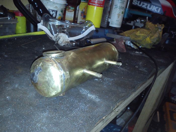

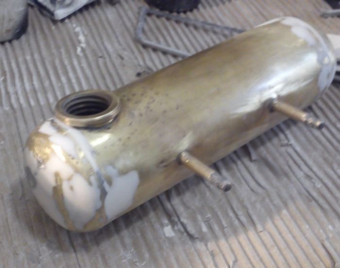

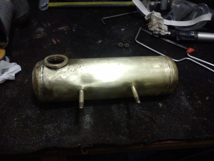

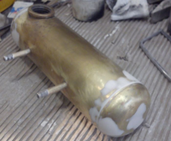

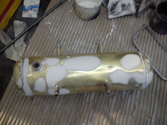

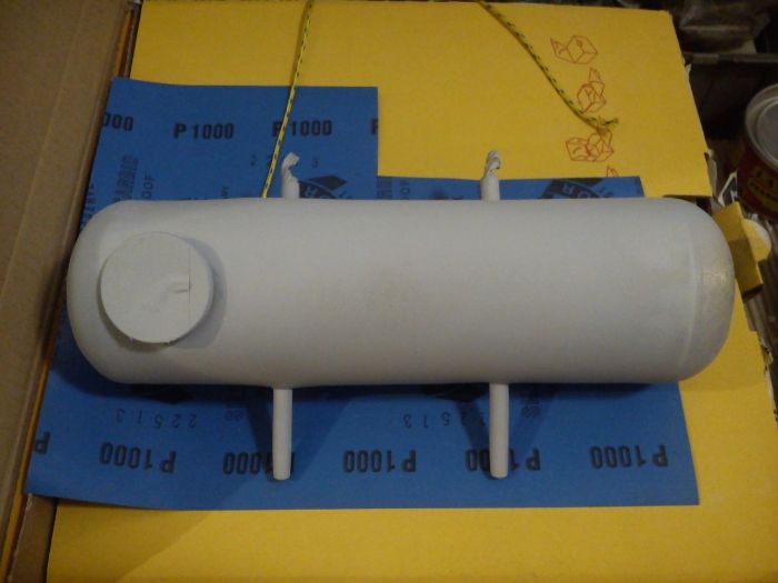

Thanks Oyster! Wait to see the tank...
I managed to take off the end next to the fuel cap. The way I did it was a little bit tricky as my torch is not big enough. To build up and maintain sufficient temperature I filled the tank with some sand mixed with small pebble. The trick worked but the pebble shouldn't be there. One of them was in touch with the tank's end and build up so much temperature to melt and create a hole to the brass
Thus the solder on the end. Of course I managed to retain the shape of the tank to a point. Thanks to Manos we closed the tank. Now it remembers a lot more a tank than before. It will need a lot of car body filler to be ready for paint.
Now I am putting solder on those silly threads that used to hold the handle.

the lesson I have learnt with tanks, is to be patient, be more patient and then be very patient
Apply filler and rub most of it off, apply more and repeat until you get the shape, use fine wet and dry to smooth it more. I then put a couple of coats of etch primer, then at least 3 coats of filler primer, leaving overnight between coats and rubbing back with 1000 wet and dry between coats. The same with the black, paint, rub down well between coats and build up the finish.
Leave the black paint for at least a week to harden then finally flat with 1200 or even 2000 wet and dry, clean and apply the decal, leave overnight for the decal to dry. buy 2 decals in case you are not happy with the first one.
finally apply the lacquer, not too thick..leave for several weeks to harden, then a very light T cut or similar rubbing compound. a neat trick is to then not use wax polish, I find it gives an almost old looking! but new patina.
Did I mention to be patient?
It thanks me perhaps 2 weeks to do a tank, and then several more leaving the paint to harden.

Fuel tank has come up well". A few good coats of paint and a decent clear coat will make it last. Decals from john are easy to fit as well, so don't panic to much about them.

Spray on plenty of soapy water and you have ages to slide to decal into position.

What I do to fit the decals is to dip them in a bowl full of water for a second. Then I have to fit them on the correct point. After a minute the cardboard can be removed. No soap of course, I would be afraid to use it, don't know the result when combining it with the varnish later.

Give the decals plenty of time to try, I did one and I think maybe the lacquer get underneath the decal and the decal started to go darker and disappear, it did look good for a time.

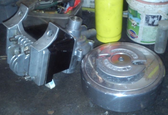

Some progress!
Any tip to clean the difficult points of the head around the spark plug hole? Thanks in advance.
I love the 10600/145 turns!!!

Re: FVP10021
Plug will hide it S
Getting serious with that aye?
All good, keep that up!
You do good work!
You do good work!
