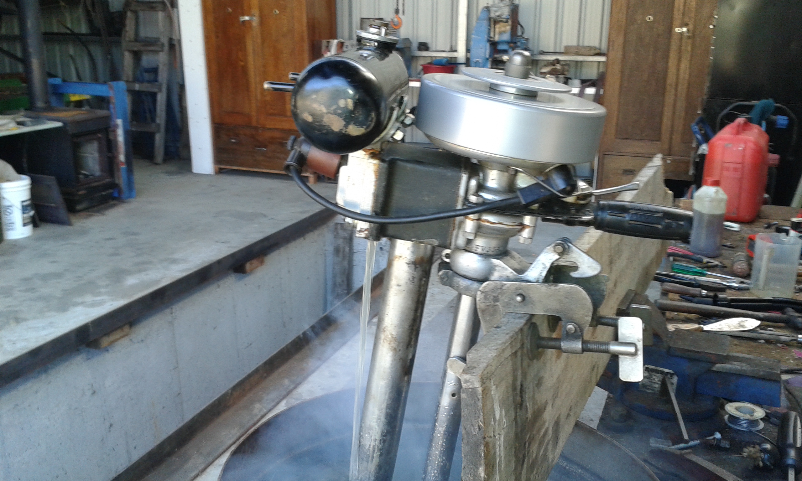

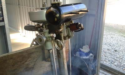

Couple of shots of FV3364 now running especially for jeremy!1
Still need to sort out the Tiller. That will need a strip down unfortunately.

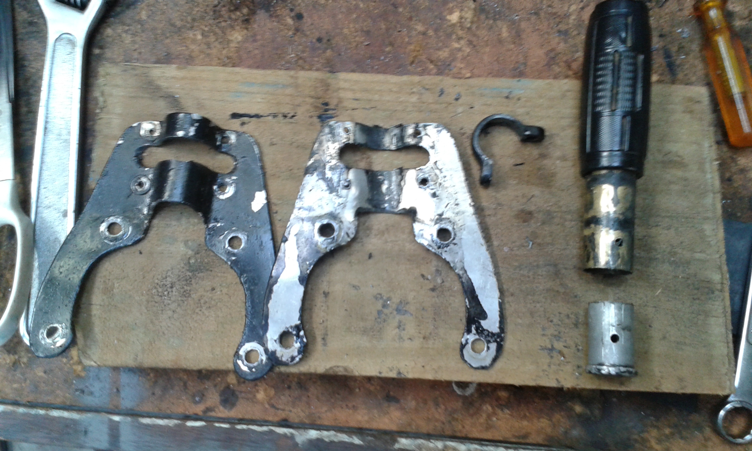

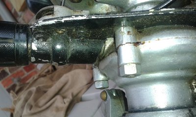

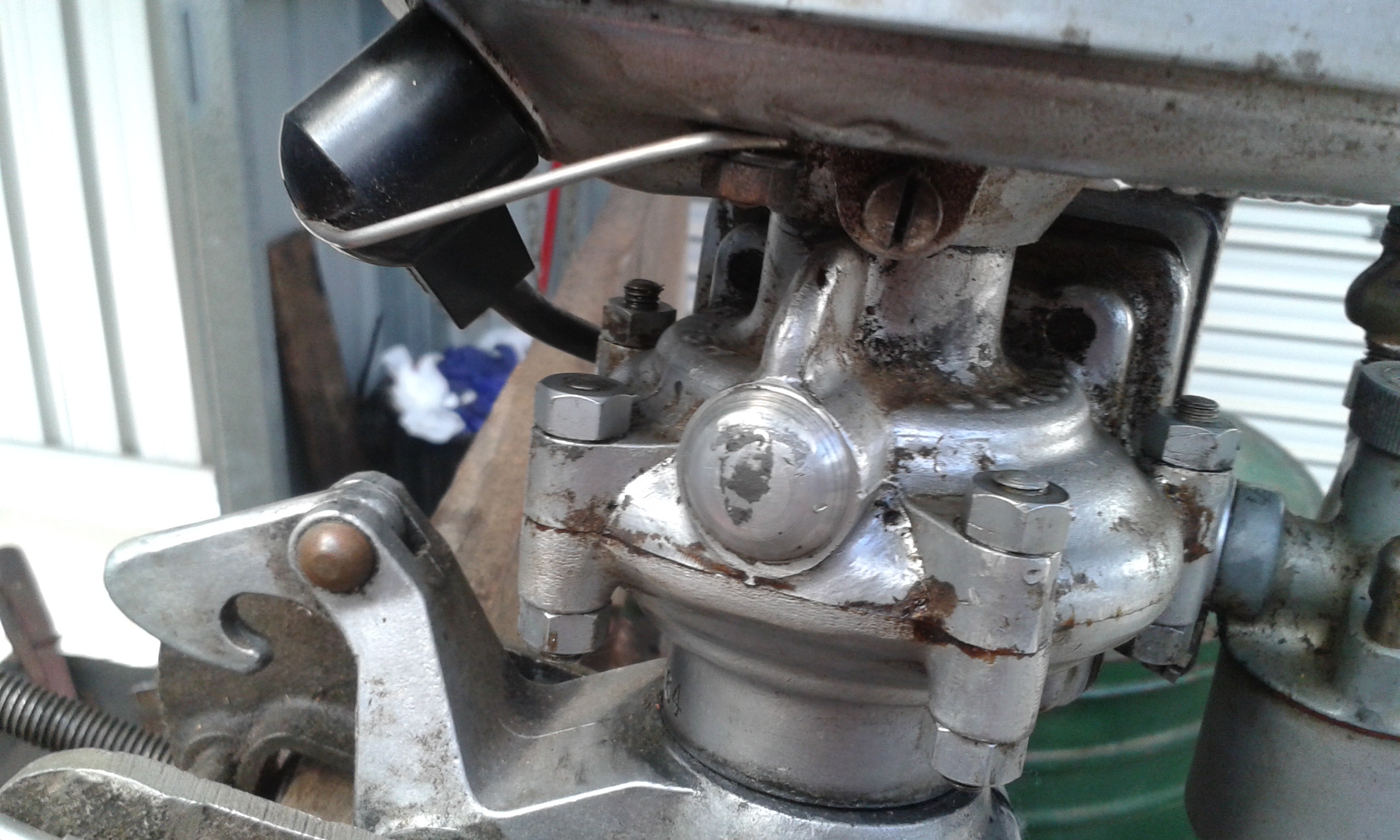

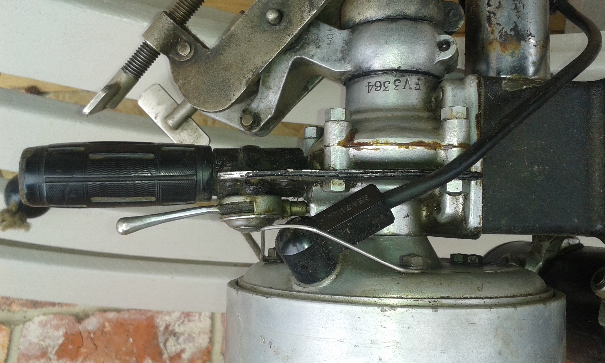

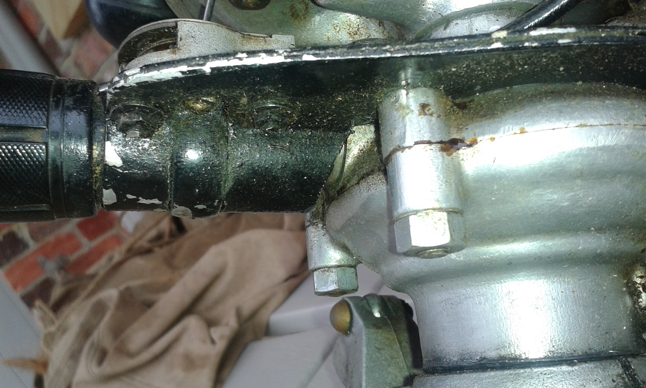

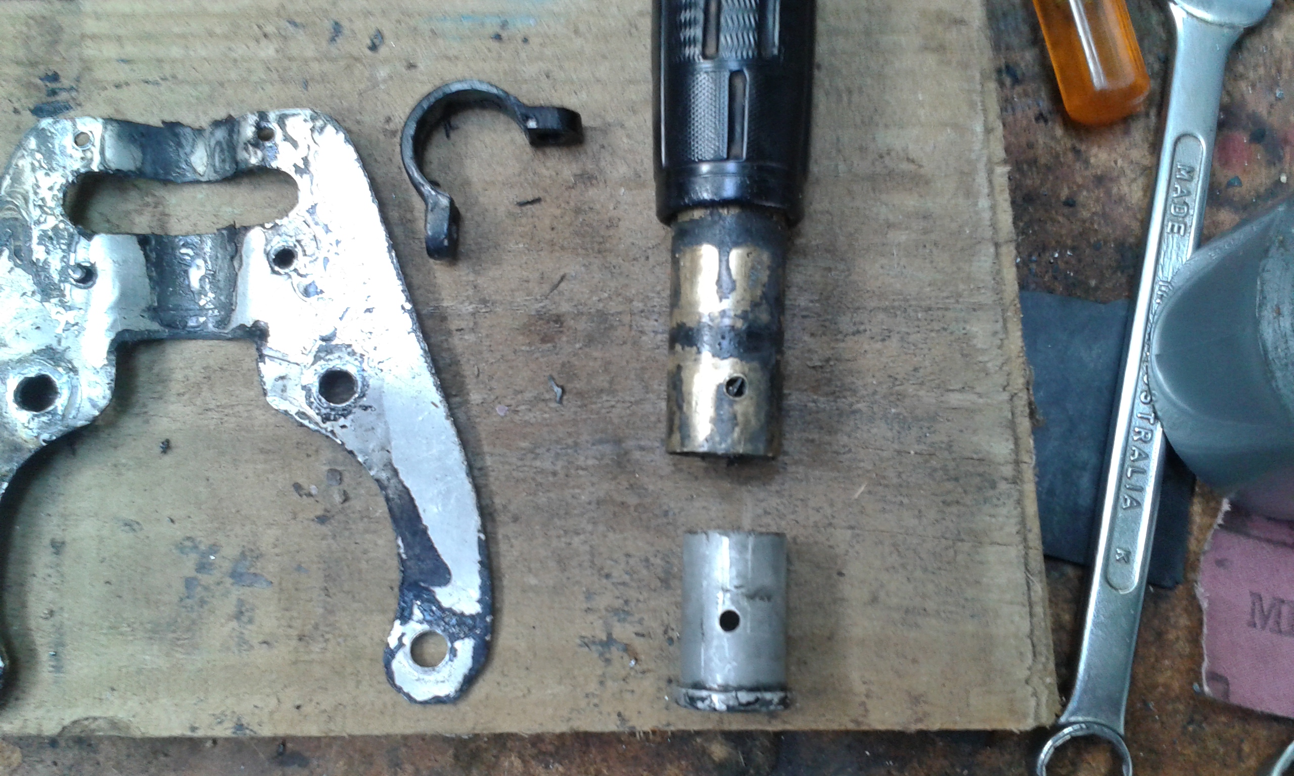

Need some insight on FV3364.
I had assumed that the upper crankcase half had been broken at the tiller stub and that a tiller clamp had been fashioned to secure the tiller to the motor. I had expected to find clear evidence of the break from fractures and or cracking of the crankcase and at the very least signs of clean-up by filing marks and fettling.
Today I removed the clamp to check on the damage. To my surprise the stub had not been broken off the crankcase but rather machined in an identical manner to the optional tiller arrangement fitted to the FV around this time and identified by the suffix “T” in the serial number.
I cannot believe that BS would have supplied just a top half of the crankcase to replace the damaged part. BS note in several maintenance manuals that the crankcases are matched pairs and supplied as such.
So one question is how did this purposely machined crankcase get on to FV3364?. I have not seen FV’s with broken tiller stubs but understand that it was quite common and that most breakages, in the process of breaking, also damaged the crankcase thus the additional fin for strength.
Nether have I seen the machining for the stub on the optional tiller arrangement. I think Keith posted photo of one but it seems to have gone.
I have posted some photos of the parts used in the “repair” and also of the machined stub for reference.
I have also contacted the previous owner who received some notes of repairs carried out by the original owner. None of these mention a tiller repair. (Bare in mind that this motor had laid on a shelf in a garage for at least 40 years before being found as part of an estate clearance)
The short answer is that the stub was broken and the splint fitted but this is such a carefully throughout and manufactured fix that it is unlikely it was carried out in some ones shed in the 50’s The repair needed a lathe fitted with a four jaw chuck, the skill to use it and repairer needed tools and the skills for very careful and intricate sheet metal work.
This still does not answer the question of how the stub was machined so precisely after a fractured break.
Keen for your views gentlemen

Very interesting, Adrian.
I don't know if you are right in saying that breakages of the stub tiller were 'quite common'. I am not aware of this being a problem. But of course, a broken stub would probably have resulted in the engine being scrapped.
Yes, the bracket doesn't look like somebody knocked it up in their shed. It looks, as you say, well thought out and manufactured.
My only suggestion is that somebody wanted to convert a tilting tiller version to a stub tiller version. In theory the serial number should then have a T suffix, but perhaps this was omitted in error. My FV2821 has a tilting tiller but it does not have a T suffix.
I cannot quite work out what the short sleeve or stub is in your 3rd and 4th photo. Is this an aluminium stub? If it is an aluminium stub, then my suggestion above is probably not valid. But what would be the point of including the stub, so perhaps it is a sleeve between the tiller and the bracket?
BS seem to machine the stub off leaving a reasonable tidy large radius end on the end. very much like your photo.
Anyway, it is very good news, as you haven't got to carry out a complex repair.

It looks like the stub has been broken off at one point in its life and may have damaged the top crank case in the process, then replaced the top crank case with a slightly later case, as they are not easy to find with the stub on, one reason for the original stub still inside the tiller tube and the owner wishing to keep the motor looking original as you have pretty much nowhere else to fit a tiller has made this holder up instead.
Re: FV 3364
I've seen a couple over the years that have been on ebay that have the fixed tiller broken. And is there not this seller fearful of this very breakage happening? http://www.ebay.com.au/itm/171734768721 ... 26_rdc%3D1
The long version fixed tiller would be highly susceptible to breakage in fact I wonder how many survived.
Just another theory: Could it not be that BS had these bracket made up as a common quick fix for a broken stub tiller mount? The plug looks like a BS infill to. The bracket looks a designed production rather than a one of. Fascinating.
As part of seagulls charm I enjoy seeing the ingenuity of different repairs, it is all part of their colourful history.
Re: FV 3364
I gave that idea some thought to Hugo, & came to the conclusion that if Seagull were doing it they would have made it as simple/cheap as possible.
So instead of 2 layers of 1/8" ally plate that require pressing, shaping & drilling, 1 identical piece of 1/4" plate with 2" of 3/4" bar welded to it to hold the fixed tiller, slightly stronger, half the pressing, shaping & drilling opps but with the additional cost of 2" x 3/4" bar & 2 minutes welding.
It also could have extended only 3/4 of the way around the crankcase, with only 3 holes saving on the material/labour costs & using 1 less extra length crankcase studs.
I'd guess homemade, but a real good fix, that top crankcase half looks exactly like all the others I've seen without the central tiller support.

I think this modification, as good as it is, is over engineered for an house seagull part.
Re: FV 3364
The FVP I had with a bracket and tilting tiller looked very much like the parts were original. The stub on the crankcase looked like it was cast minus the stump with a nice radius very similar to the machined one shown on this FV we are discussing. Jeremy now has this FVP so I'm sure he can post pictures. It is fairly important as it will show the BS original arrangement.
Looking at this FV with the one-off bracket, it looks to me like the top crank case has had the studs removed and been mounted on a face plate on the face the block mounts on to, and the stub machined off. I think those brackets are a good job, but any decent sheetmetal worker would have been able to make those at a bench using hand tools, and perhaps a press.

I still believe that is a lot of work to make this bracket for one motor. Sure it is possible but having to make a pattern for the press etc.... I wonder if there wasn't a company that made it as an aftermarket repair kit? The heavy transom bracket that allowed a gull to spin 360 degrees to give reverse was an example of an external aftermarket accessory. Was it called the rotor-gull?? I can't remember.
The Australian Seagull, the Olympic, also used the crankcase bolts to mount a carry handle so maybe this bracket is an Australian initiative.
