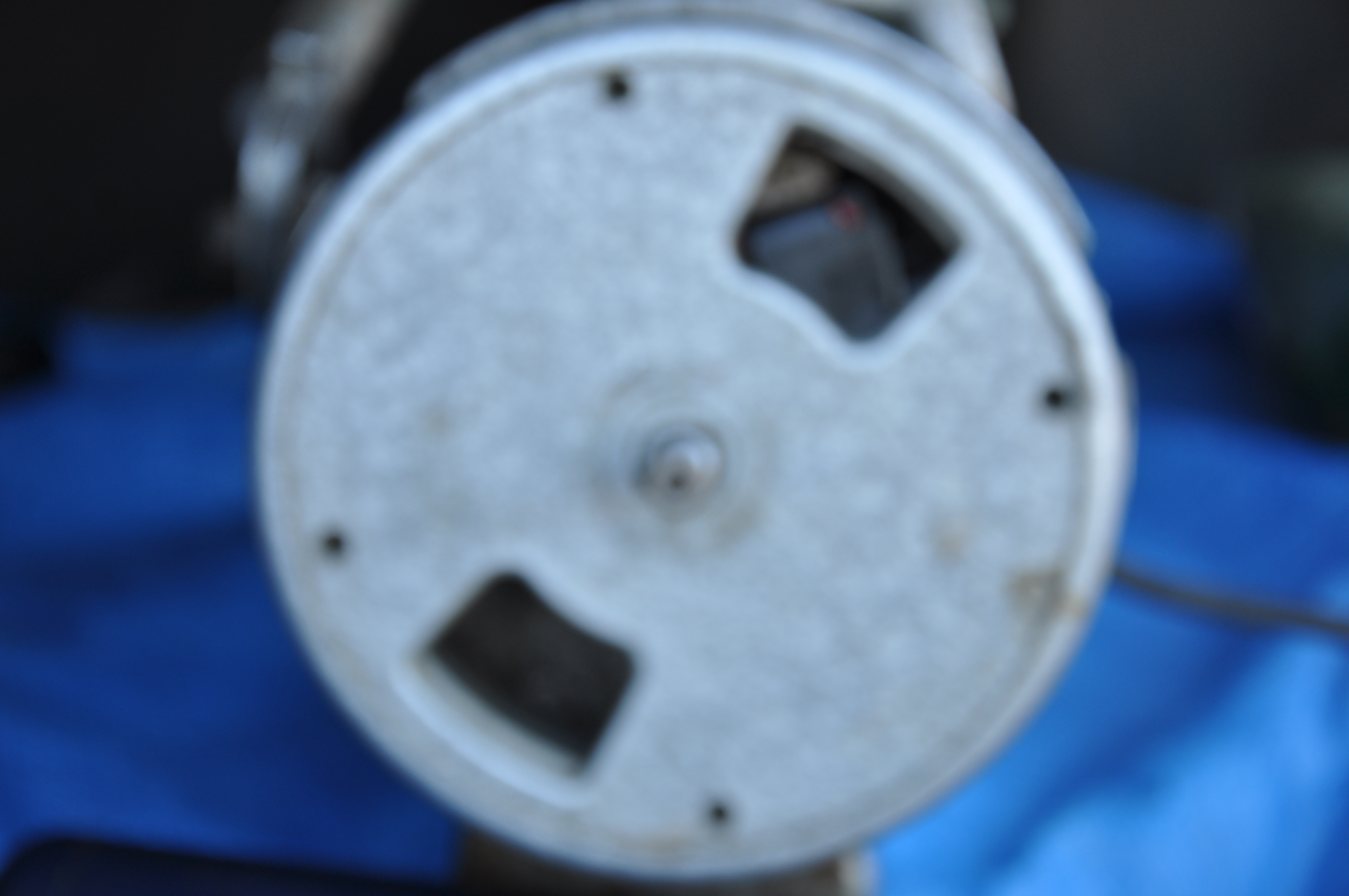

Over the weekend I tried unsuccessfully to pry off the outer casing that holds the points and coil, please see a hazy photograph. Do I require bearings extractor to complete this task.
Malachy

Set piston as down as far possible,put dome nut on,get help to lift  engine by flywheel,if no help available,I lift engine with two fingers in the opening,strike dome nut sharply with rubber mallet,if doing it yourself,refrain from striking your second finger as it is rather painful.DO NOT use a bearing puller.

Thanks for the advice which I have tried doing with the assistance of a fellow worker but without success. Despite several hammerings, with a rubber hammer, it does not seem to want to move. Will try again later.
Malachy

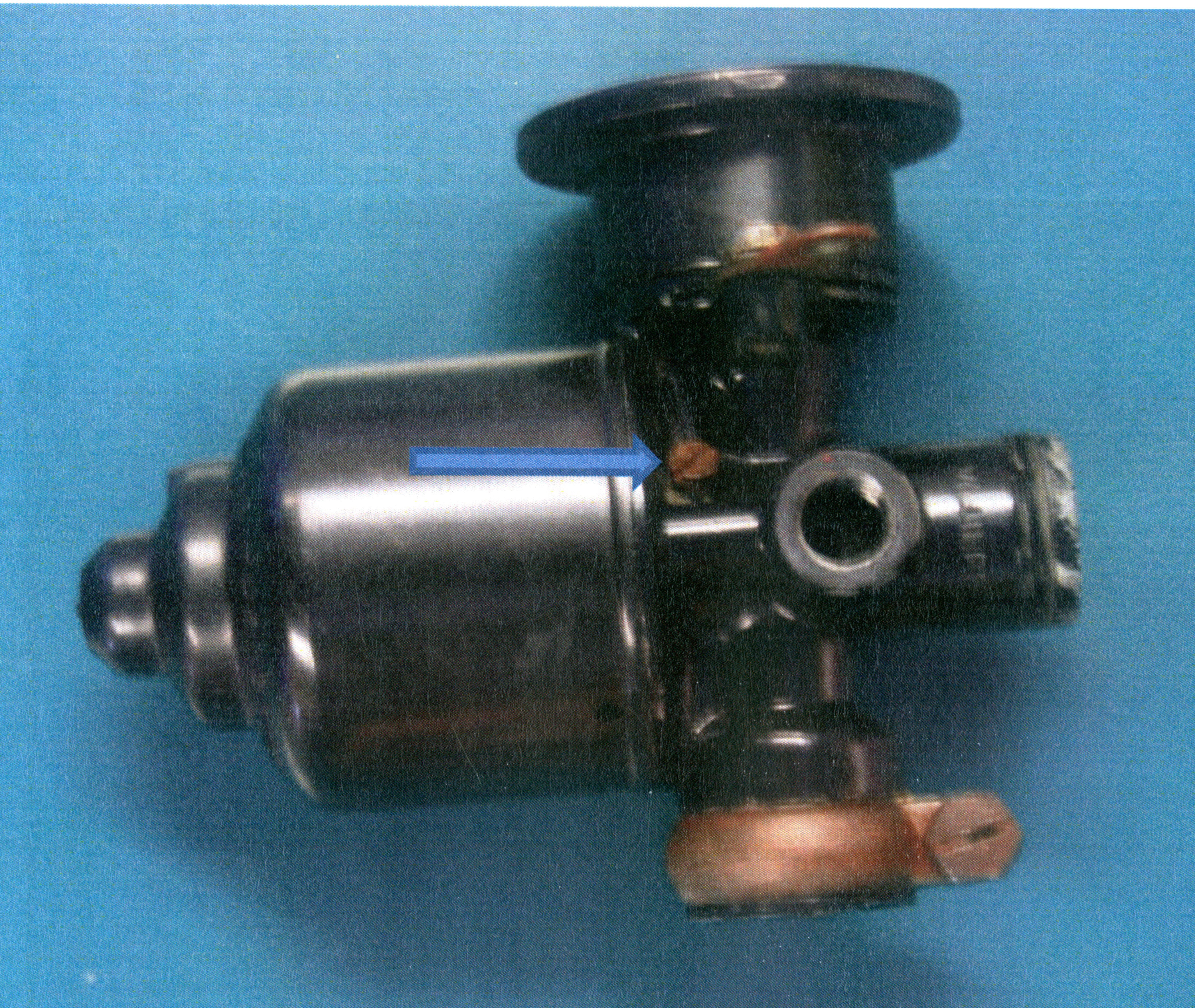

Does anyone know to dismantle a carburettor on model  FPC1723AAP (Forty). When I remove the screw A as shown on the Seagull Carb webpage the float chamber just turns without coming loose.
Malachy
						Malachy
Re: No spark
I don't know what screw you have removed, if its the one on the side of the carb body, that one is holding the main jet in place, if so replace the screw, but it will have to line it up with the slot again, by turning the bottom nut.
Side screw in the picture. Yes playing 3D pictures again.

How do you dismantle the plastic carb so I can clean it? I have loosed the screw in the picture shown but all that does is to allow the float chamber to turn but it does not come off.
Malachy
