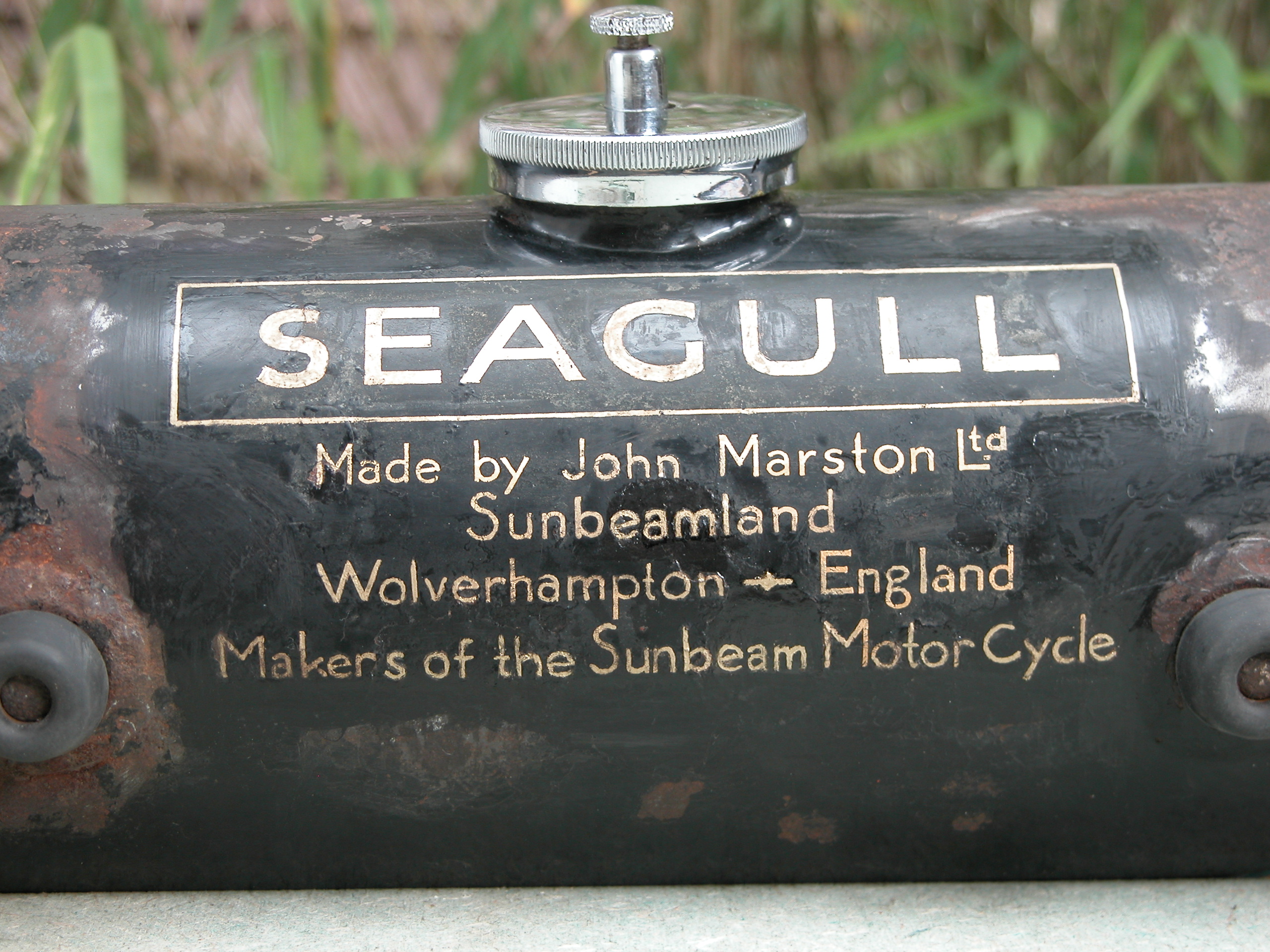

I would use paint stripper on a test area of the tank, perhaps 1 inch square to see if the top layer comes off. Leave it for 30 seconds first to see what happens and wash it off. Keep repeating to learn the effect.
I managed to do this on my ON tank and eventually could see the outline of an old transfer below that looked like it had been wet and dryed. Very rewarding to see "Marston Seagull" appear when held to the light 8)
Patience is the key!
I have found that nitromors will not strip baked on enamel or old fashioned red oxide primer very well. Modern paints seem to strip easily so you may well find that the original paint finish below may be exposed easily.

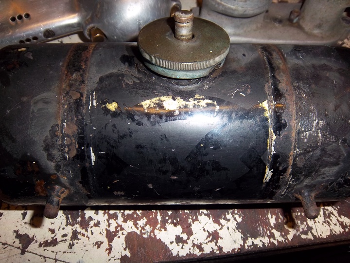

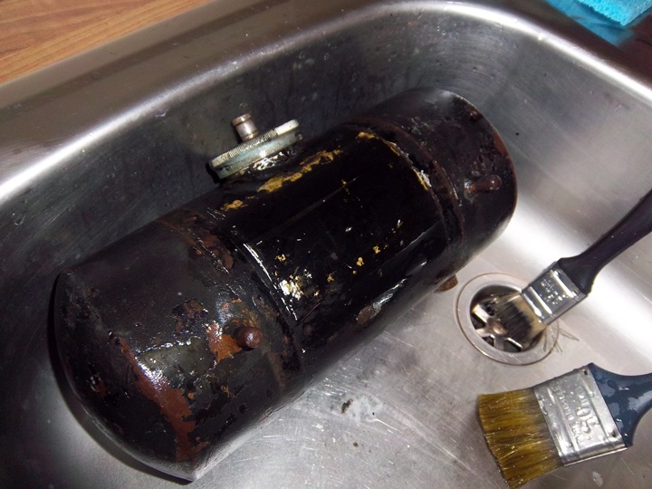

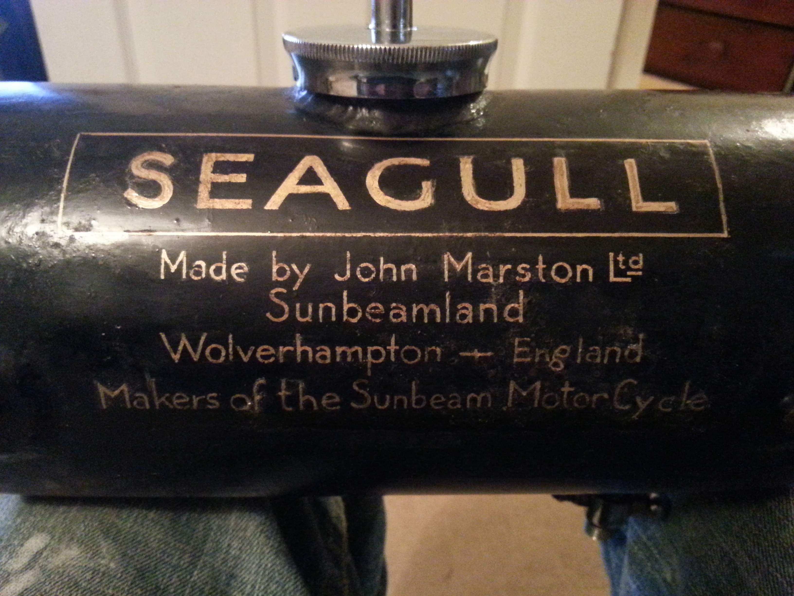

Here are some photos of my ON tank. It had been rubbed down and brush painted at some point in the past. I carefully applied paint stripper for 10 seconds at a time, and after repeating this a few times I was able to take the layer of brush painted paint off, leaving the rubbed down remains behind. I used a brush that had had the hairs cut back to make it more like a stippling brush, this pursueded the softened paint to come away, without damaging what lay below.
As you can see the remains of the decal could then be viewed, and you can just pick out "Marston Seagull" when viewed in the right light.
This worked fine for me, and this tank will be completely refurbished when I get around to it.

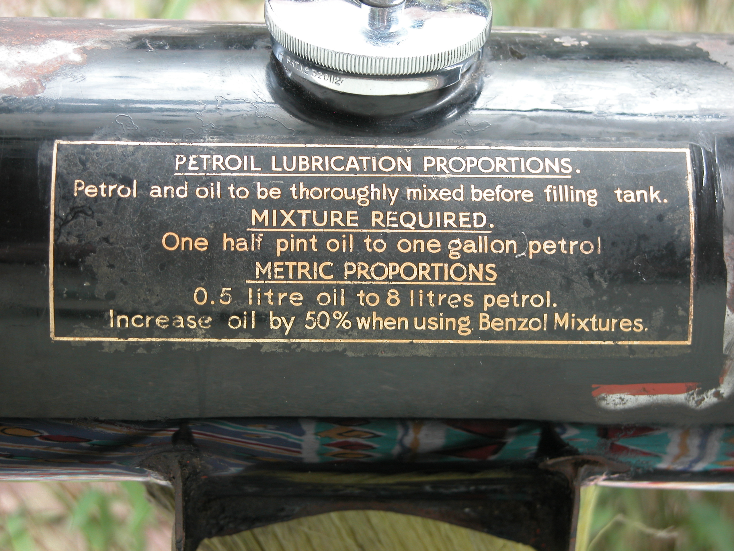

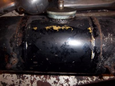

To remove the newer paint I would try some strong detergent, such as truck cleaner.
This may soften the paint enough that you will be able to scrape it off with a finger nail.
Use a cotton bud and try is carefully, the decal is very fragile has no backing or coating over it.
The original paint is very tough, but the decal can be rubbed off, that is why so few survived.

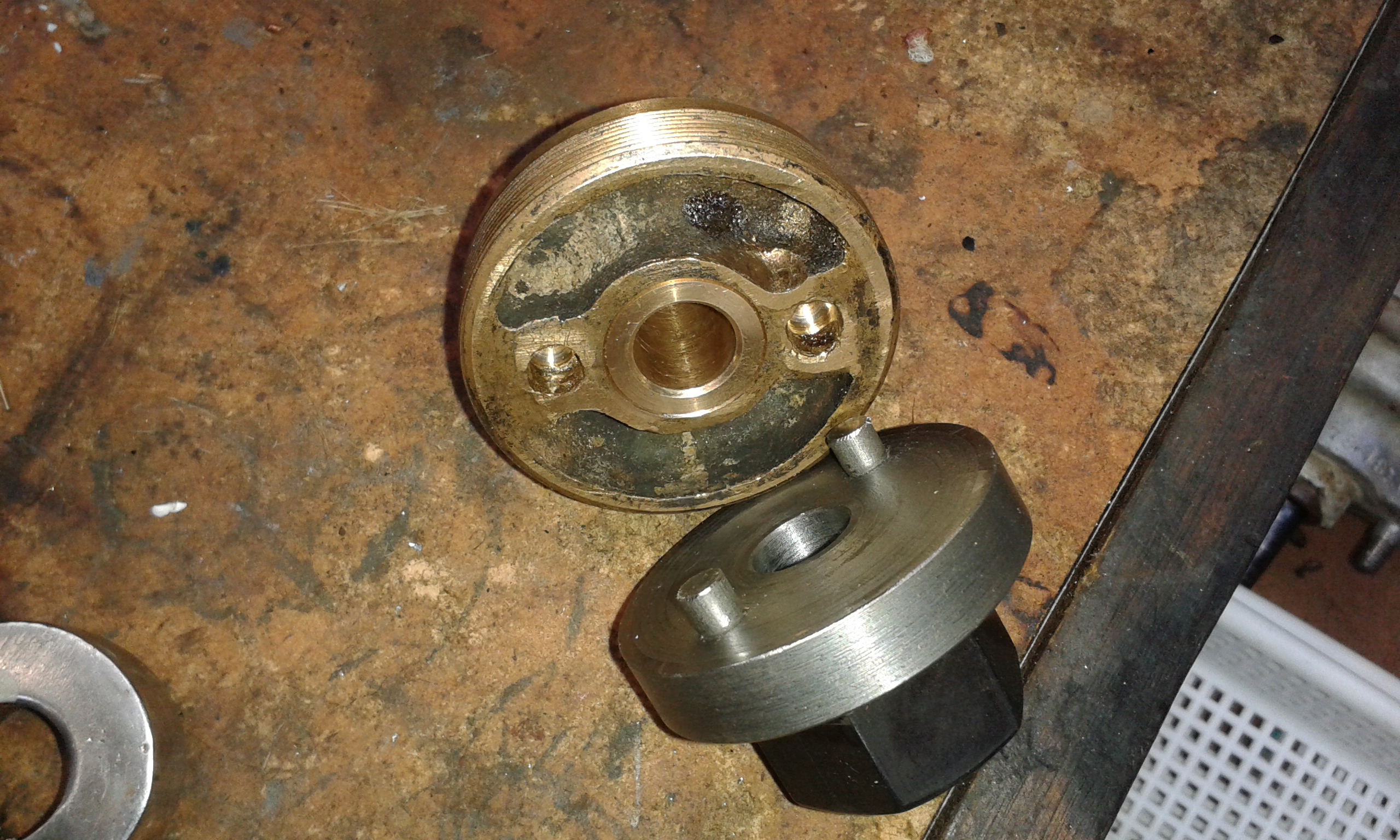

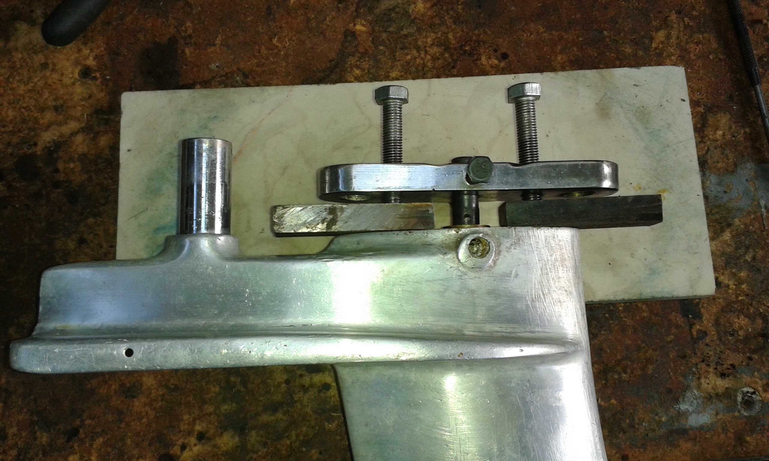

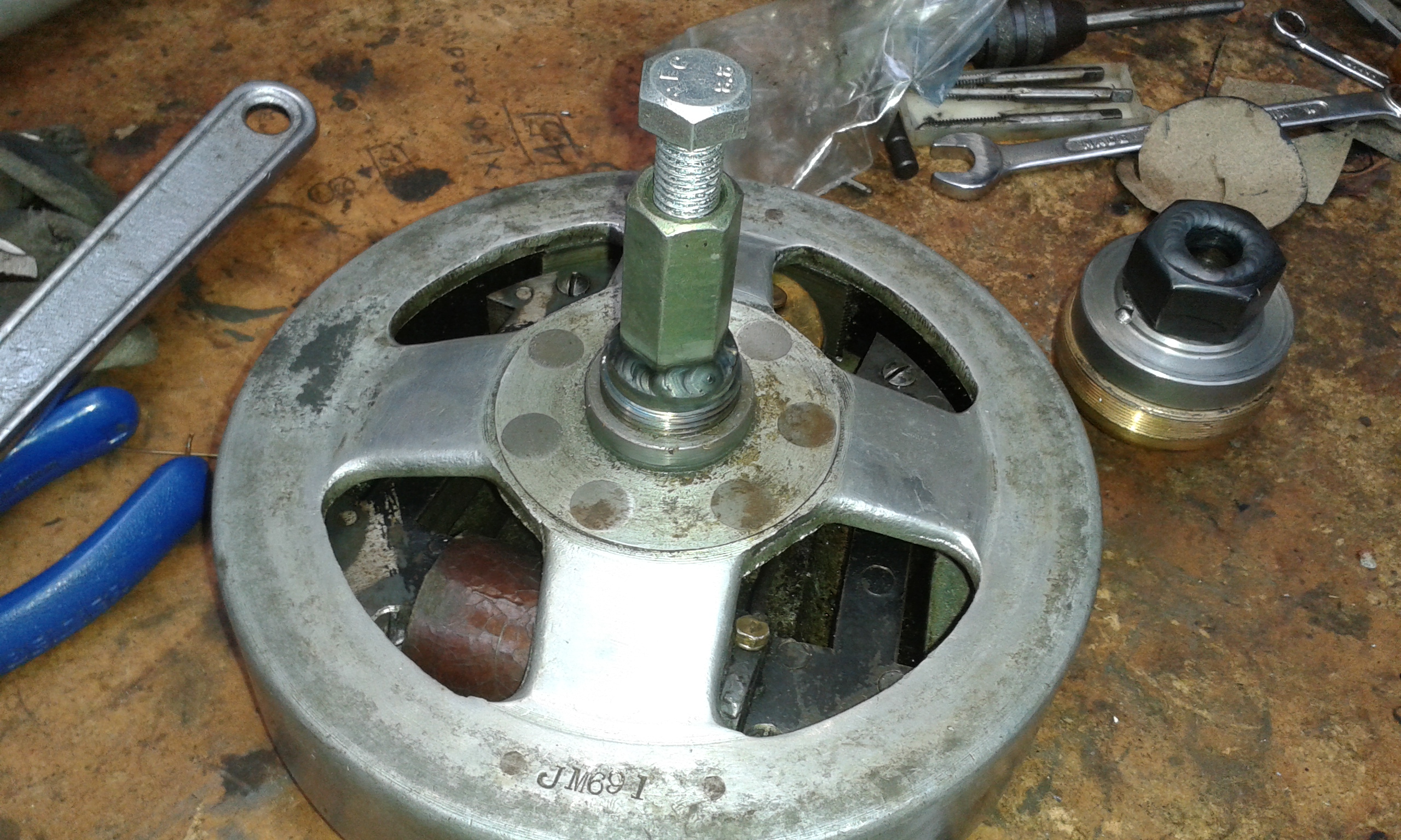

Attached are photos of the set of tools that I had fabricated at Dynamic Welding, Hobart to disassemble the AO
Flywheel puller
Flywheel puller
Pinion extractor
Pinion extractor
bearing carrier and extraction tool

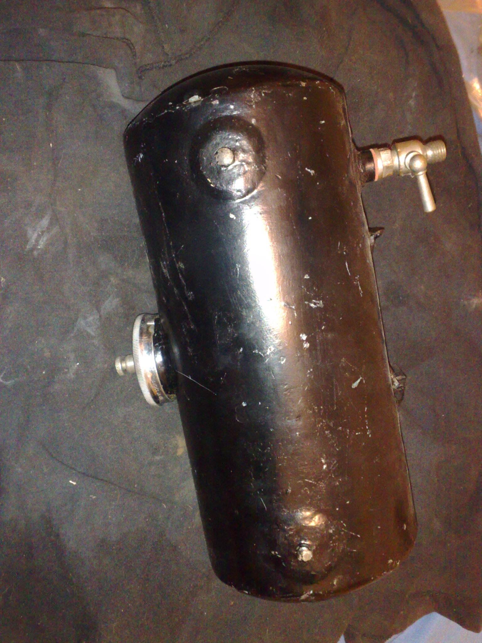

I will do a new post since the Great Loss Of Images last S.O.S. server upgrade for AO 262 but in the mean time I have selected a nice tank out of boxes for it.
There are no decals remaining......or I do not care to look as the tank is sound and will clean up nicely.
I have repro decals for it so back to metal and start again from scratch.
