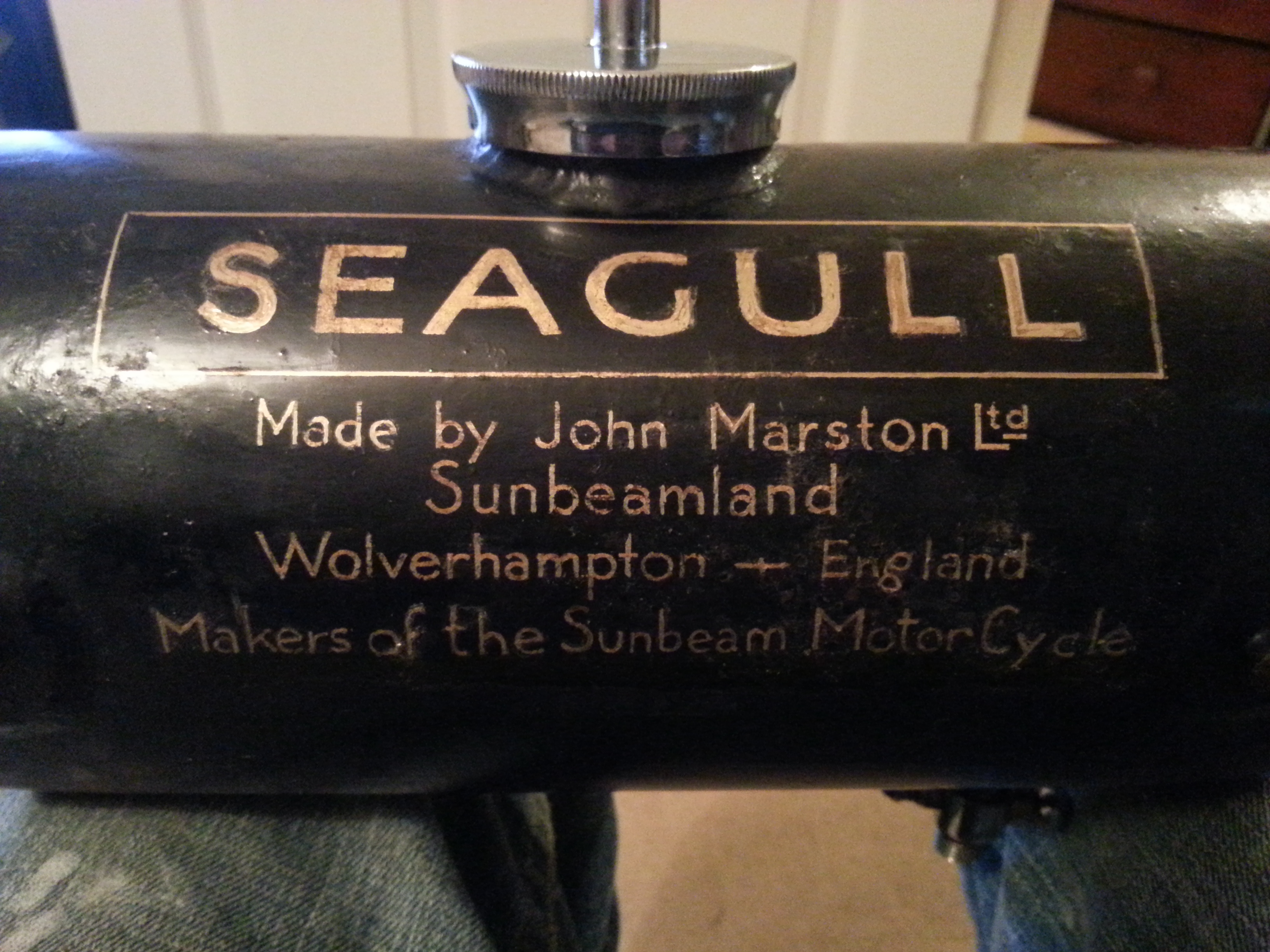

I have been overhauling/repairing an OA and am pleased to report that the power head is now completed and has been bench tested after a complete strip down and rebuild. Gear box is a nightmare but that's another story.
However in a rare sunny day in Tasmania I noticed, in the bright light, that the decals on the tank were still just visible through a top layer of roughly applied matt paint; not only are they visible in the correct light but also appear to be complete.
Now the question: how to remove the pain with out damaging the decals? A small test section, well away for the decals, using paint stripper has revealed that the original black paint remains on what looks like 80% of the tank. But I loath to tackle the section covering the decals.

no shortage of advice then. Using paint stripper on a small section well away from the transfer the top coat came off and under it is what appears to be a very hard black enamel that was unaffected. but I will ponder a bit more; Maybe try the hot water first. I have a feeling that as the top coat comes off the transfer will disappear.
Of the two the side with the fuel instructions is completely readable in the correct light just as H-A photo.. really don't want to lose it.
