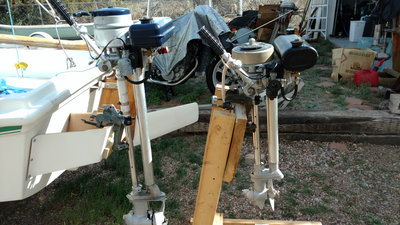

Re: EFPCL Lives!
Well, I put the right tanks on the right motors (well, the recoil starter and tank should be black on the EFPCL, I think (1985 vintage). That starter came off the EFNR, which you can see in the background. The tank was a steel spare the PO had for the FW 40 (has the narrow 40 bolt spacing).
The EFPCL runs great. I can't wait to get it into the water. The Featherweight 40 doesn't seem to have the same oomph that the newer motor does. I may need to check the points again. Also, I tried the quick and dirty water jacket cleaning. It didn't improve very much. The EFPCL puts out a nice stream all the way down to almost idle. The Featherweight 40 stops flowing at about 1/3 throttle.
I guess I really will have to pull the head and clean the jacket.
I'm waiting on some parts from various sources.
One question. From the photo, you can see the clamped spacer I made to raise the long-shaft prop to the correct point just below the waterline on my Potter. Do I need to worry about the extra torque on the drive shaft tube? It can't be as strong as it was when the pivot is up by the crankcase sleeve.
Just asking.
