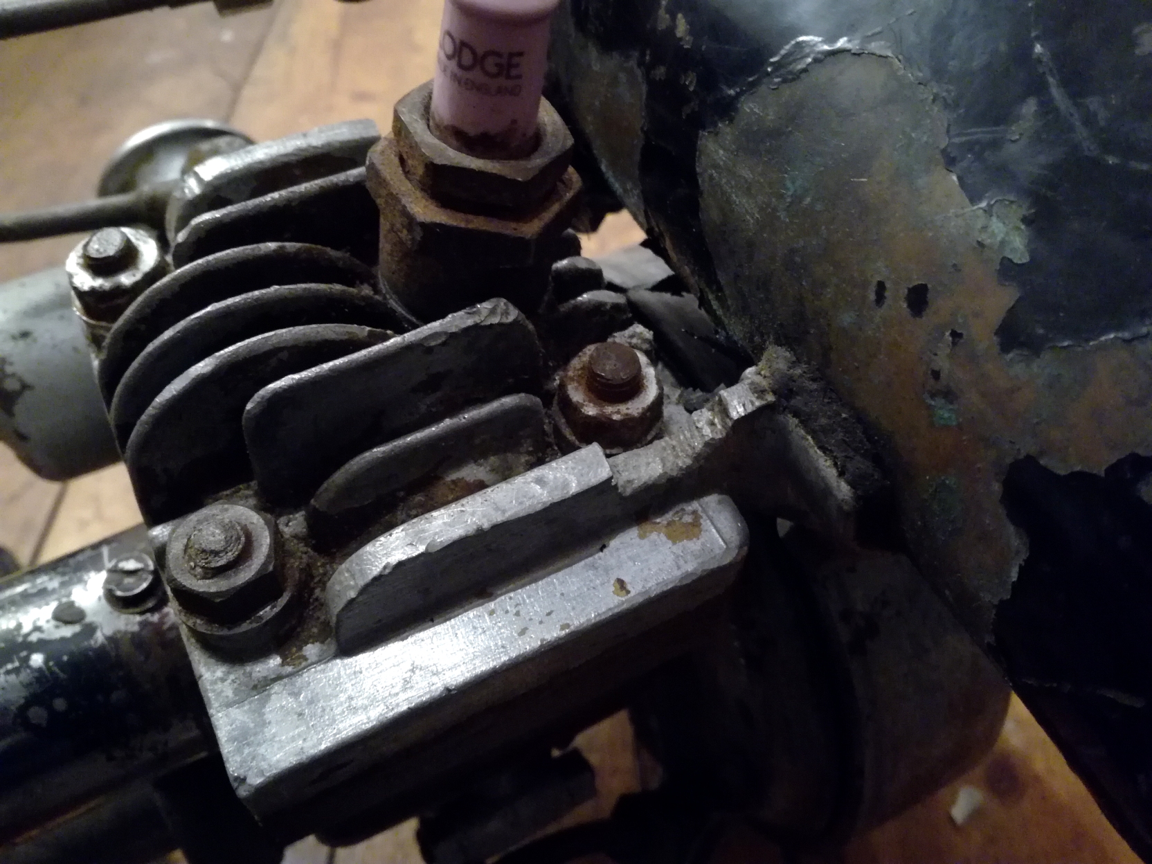

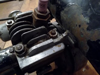

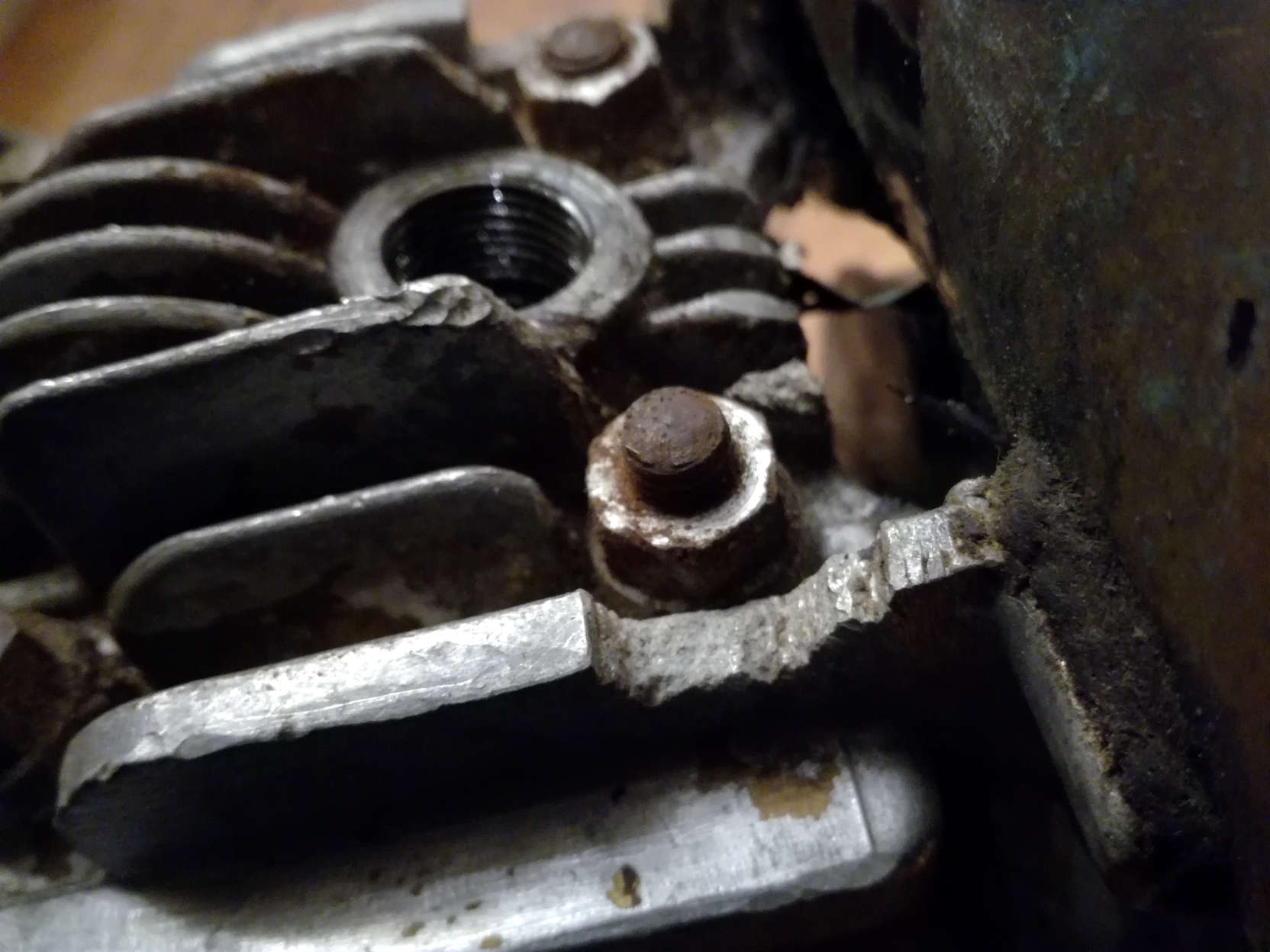

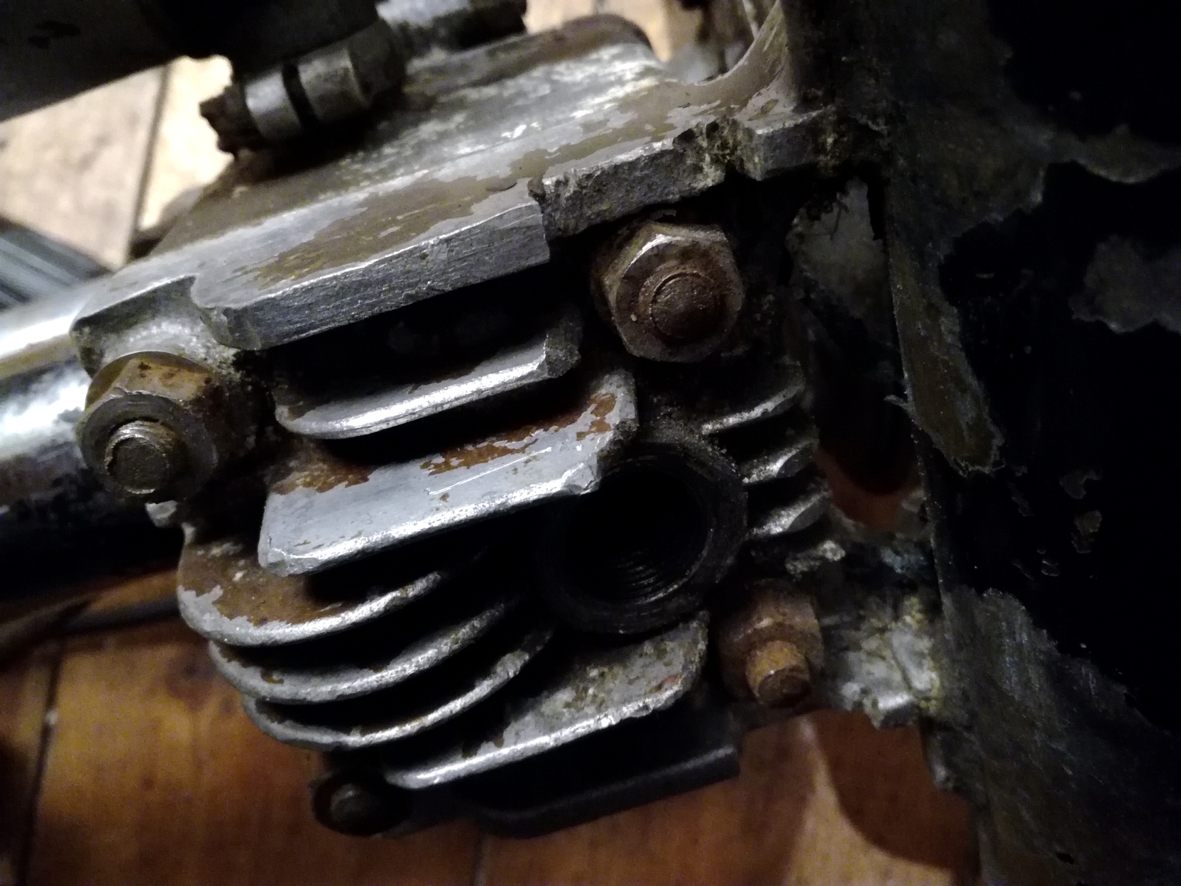

I got this nice Little Forty.. all original, untouched and in good order, the tank is almost dent free.. but the head! It looks like somebody has taken a hacksaw a chopped off pieces of cooling fins to get access with a socket. Really? Poor little thing. I've been looking around for a new head, and don't see any quite the same. Perhaps I will file those fins down, and neatly round them. Is that the original spark plug?

That is nasty!
Could you get them welded up?

I think the damaged was done because not of a socket but rather to get a ring spanner or open ended spanner onto the nuts.
Re: My poor Head!
Yes, the head does look as if it has been treated very badly.
What is the rest of the engine like?

Maybe it was a spanner, although I don't know if there would be clearance for anything much with those fins intact. Is that a known difficulty with this model? If I don't replace the head, I guess I will round the broken bits off and file them smooth, don't know how practical welding or brazing would be.

I have come across this type of damage before, I think its down to only having a single ended ring spanner that fits the nuts.

For my 2 cents worth I would clean up the fins by using a file and a bit of patience. Obviously welding can be done but the fillet can be a bit wider than the fin so will be noticeable unless you know someone who really knows what to do, how to do it and have the full understanding of what a quality restoration should look like. Other choice is to put it back together and continue to look for an undamaged head.

Re: My poor Head!
whigum wrote:I got this nice Little Forty.. all original, untouched and in good order, the tank is almost dent free.. but the head! It looks like somebody has taken a hacksaw a chopped off pieces of cooling fins to get access with a socket. Really? Poor little thing. I've been looking around for a new head, and don't see any quite the same. Perhaps I will file those fins down, and neatly round them. Is that the original spark plug?
You'd be surprised with what can be done with that head I'd even build Finns up with plastic metal then a skoot of silver paint ...

From my point of view, correct fitting tools are absolutely ESSENTIAL otherwise you run the risk of this type of damage again.
As for a good replacement head, i think you'll end up looking for a "parts motor" for the required parts. There's precious few spare parts for these,(cylinder heads being one of those scarce parts) however a fairly complete engine coming up for sale in the future is a better bet. Patience is what you need and a keen eye.
Tam's right, it's surprising what can be done by a competent welder. The quality of the restoration will depend on the individual carrying out that work. (remember the 6 p's)

I may just have a go at repairing the head myself. I do have some experience in restorations, mostly on furniture, but we shall see. I have a vague idea of taking a cast aluminum saucepan, snapping bits off in a similar fashion to the head, then attempting to repair it by brazing. If the pan goes ok, I will try my hand at the head. Otherwise, careful patient filing to disguise the damage it shall be.

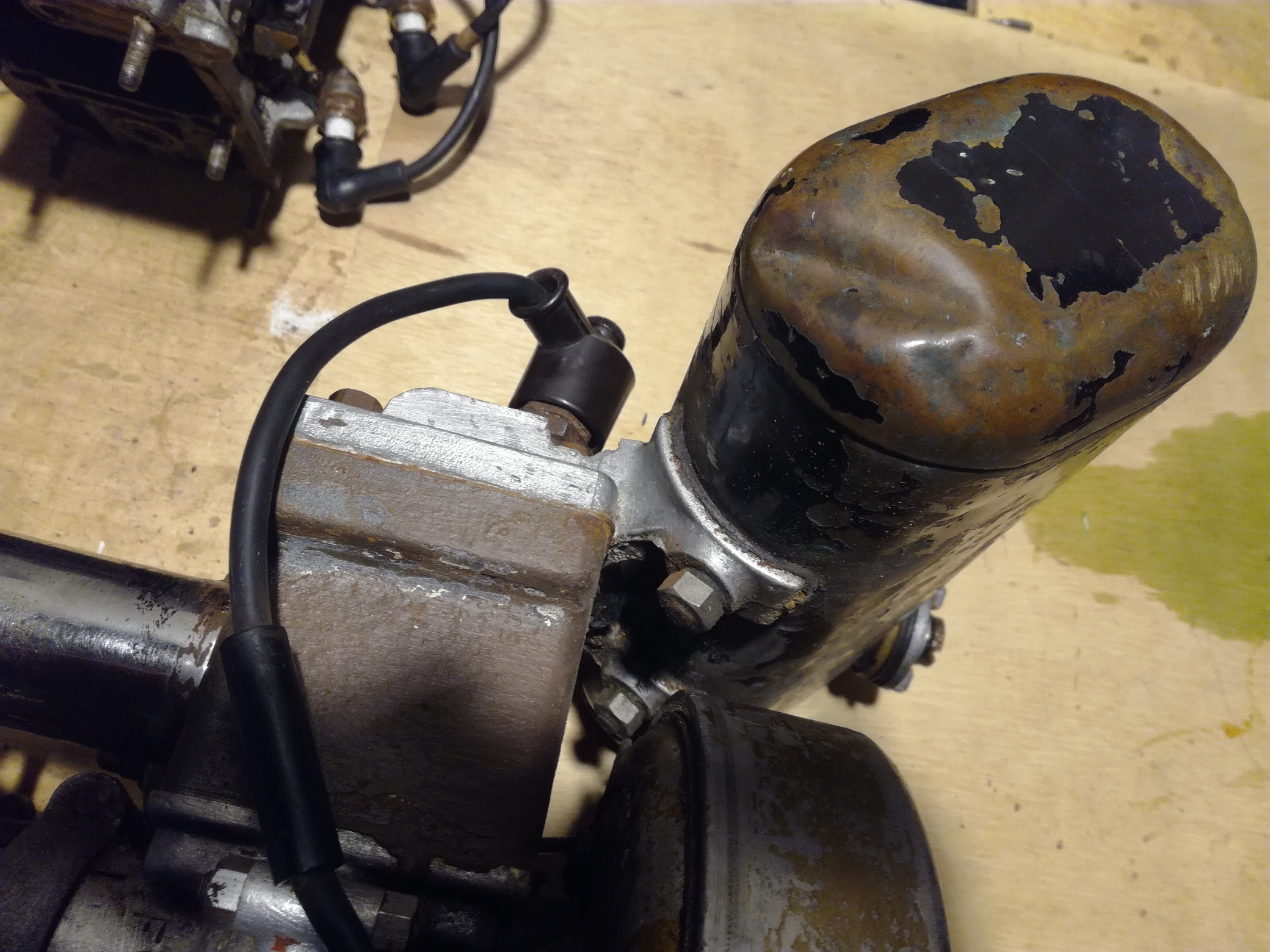

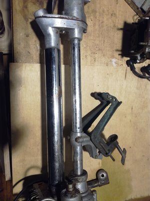

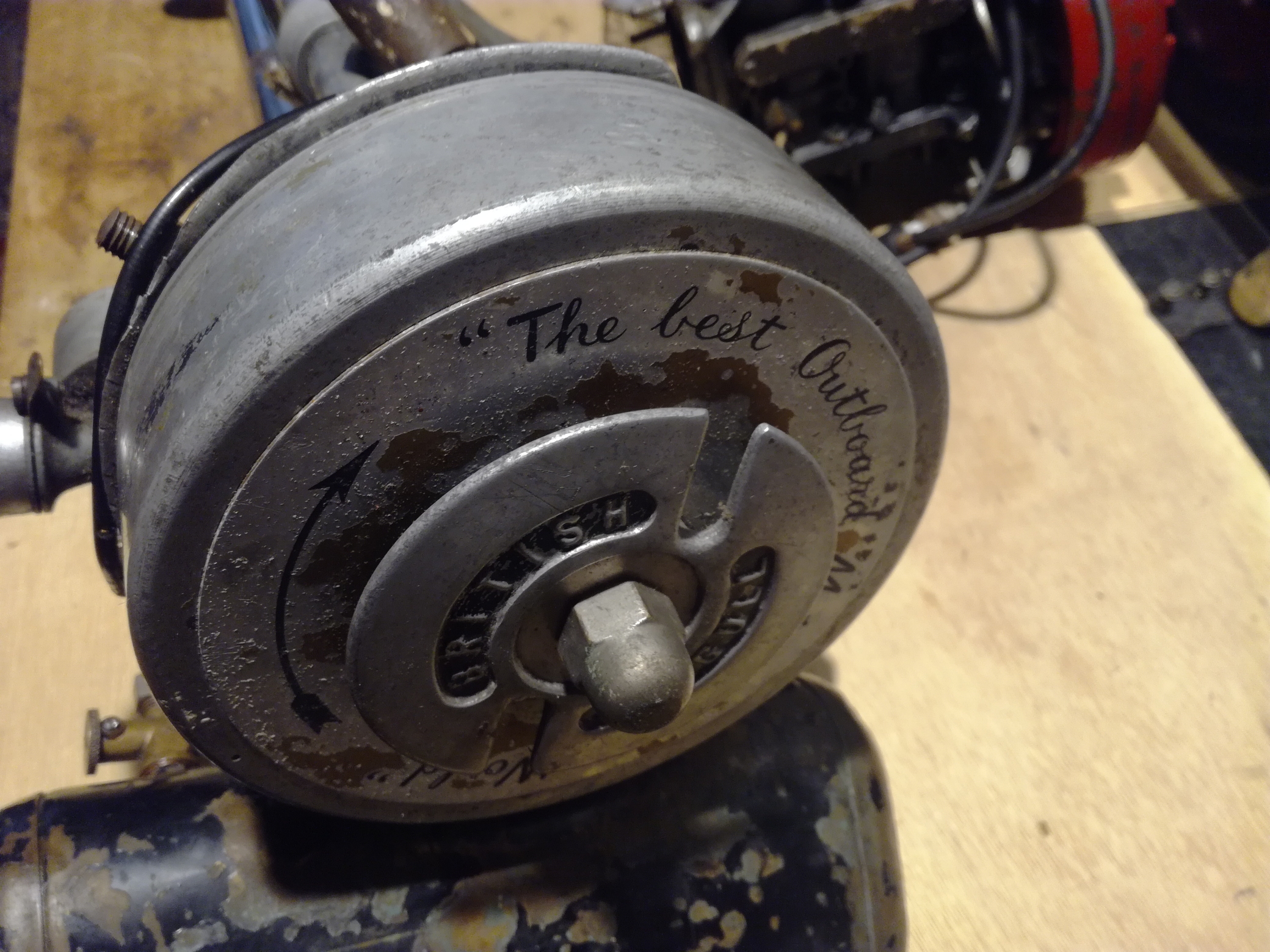

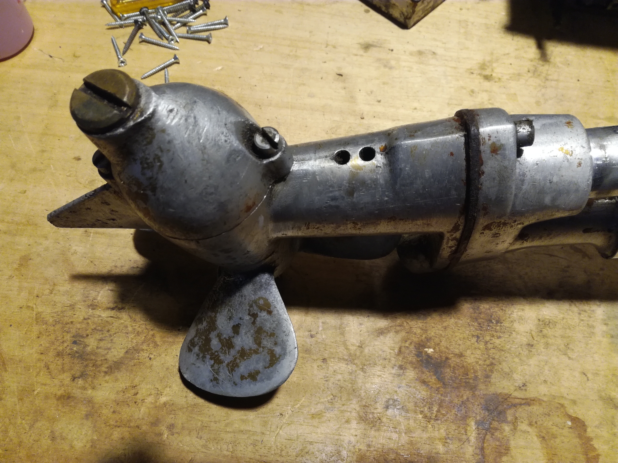

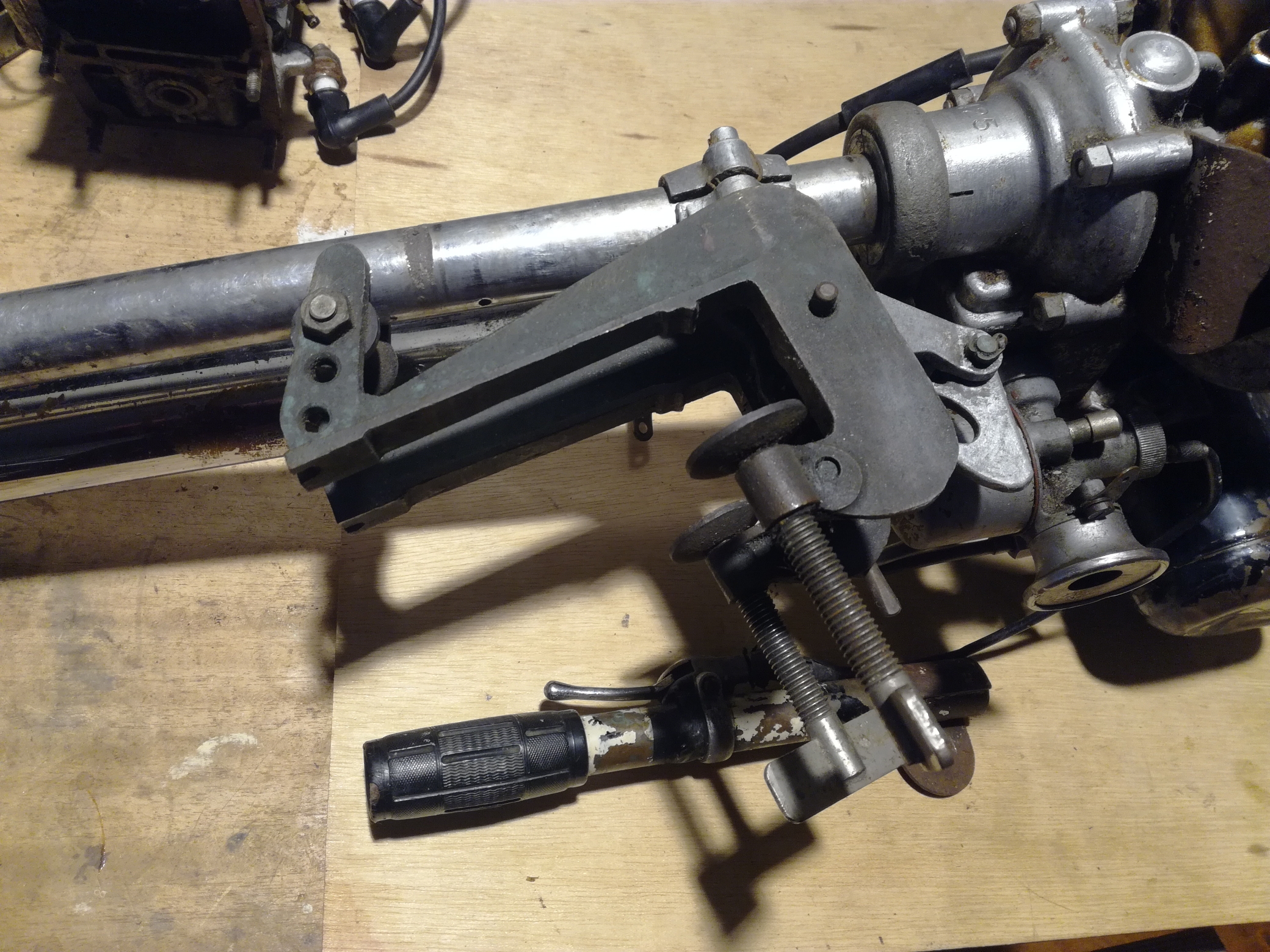

And here are a few of photos for you all, if anyone is interested to see more, I have others:
I bought this engine (along with a 60s Yamaha) from a man who told me they belonged to his father. Apparently his father had a sail boat that he never sailed, just motored about for fun. I think the Yamaha was his main engine, and the Seagull as backup.
The Yamaha had been very messed with, appeared to have been taken apart needlessly.. screwdriver pry marks under the flywheel, severely chewed screws etc etc. I'm guessing the previous owner was one of those people who likes to 'work' on things without any skill, patience or necessity
As far as the FV goes, it doesn't seem to have been dismantled much, other than the head. I have looked over the nuts and bolts etc, and don't see any chewing present. Lower unit looks to have had the screws removed, but not destroyed. Also, tarting up with a wire wheel prior to sale appears evident.

These heads are very difficult to find as replacements (ask Gannet).
Damage yours, & all you'll have is a load of spares for your next little model 40.
Try brazing aluminium by all means, & try cleaning up the joint afterwards with a dremel, then leave the finished job outside in the weather for a couple of days.
A good aluminium TIG welder will do a much better job in 10 minutes, that will be far easier to clean up afterwards & won't look like a bodged up repair on the hardest to find component of your motor.

John Williams has a tool kit for sale with a 3/8" socket that will fit these head nuts & not damage the cylinder head fins.

Wear marks on the drive tube with a little worn chrome. Have a look at the small "cotton reel" mounts within the transom mount for signs of FLAT SPOTS. If they're mostly round then chances are that they're from a low hours motor. BUT if they've got noticeable "flat spots" it's a sure sign the motor has had a bit more of a chequered life than you first imagined.
ALSO (with my keen little eye) a quick glance over the flywheel cover shows some pitting.

Weld the head i think is the general consensus with this.
