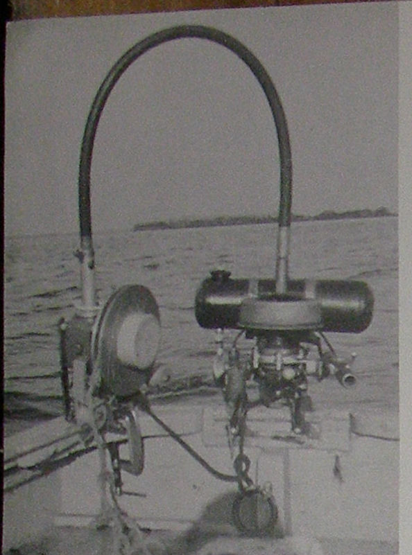

Anyone ever seen one of these?
An ingenious device from the Emerald Isle:
Using the power of a Seagull to haul lobster and crab pots from the bottom is a truly wonderful idea!

I like the safety lanyard idea, if you get a really full pot it would stop the Seagull & hauler joining it on the seabed!

I'm particularly full of admiration for the G Cramp that seems to secure the thing to the boat!
In the past I have wondered if a similar device might be contrived for hauling in an anchor, an activity which leaves me breathless and trembling!

If the drive is being taken from the crankshaft threads, wouldn't there be a tendency for it to come unscrewed? Or have I misunderstood something?

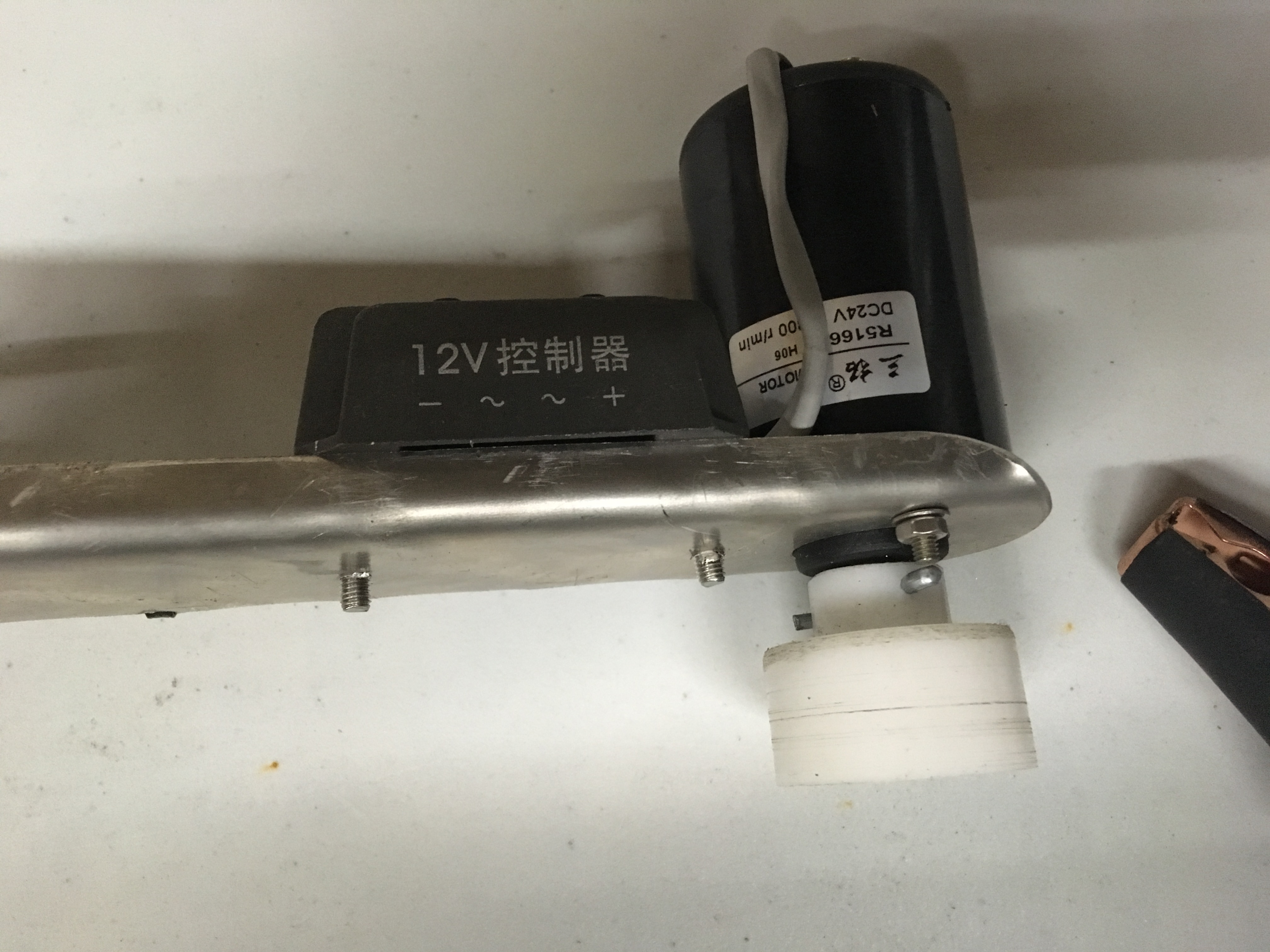

I was thinking of something along those lines to run a permanent magnet motor and rectifier out of a wind turbine to charge my battery and run my 12v coolbox. I will mock it up later and post a pic.

Liam I have no technical information such as gear reduction. The photo is from a brochure that merely suggests that it's a good thing!
Re: Pothauler
Good point Jeremy!
Probably a fancy flywheel nut with an inner & outer on the flexy drive, put the hauler in gear when the Seagull's out of gear, complicated!

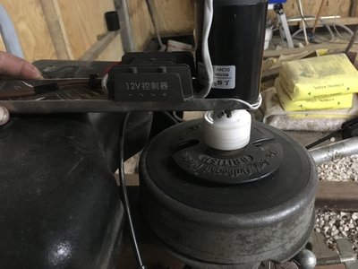

Pto Generator idea. Just need some sort of hinge bracket so that i can lift up the generator to start the engine.

charlesp wrote:Anyone ever seen one of these?
I can not see this as a reality.......

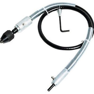

Everyone has one of these hanging on a nail for porting and polishing I would think. I have many different lengths and diams depending on what load Is applied. I use my post drill as a power source.
So looking at this attachment onna Gull all I can see is the nut wanting to unscrew when reactive load of hauler is applied.
Makes no sense to me at all at all.
Maybe the nut holds an adapter plate thingywhatnamedoodaddy that drives the flex shaft.
Also the engineer in me screams "WHERE IS THE CLUTCH" and "THE FREEKIN BRAKE" as once the rope is bedded to the winch sheave it is digital.
I can only see so much to go wrong with this design. Concept is novel though.

Liam2k3 wrote:Generator
That is thinking out of the square Mate.
Love it!
