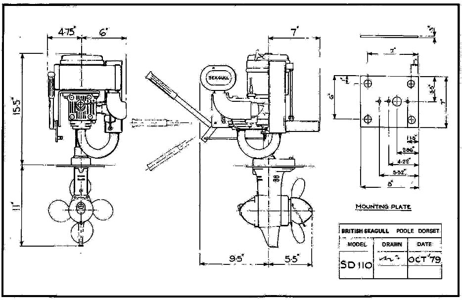

Technical Spec. - Click to enlarge In situ Picture - Click to enlarge Plan - Click to enlarge

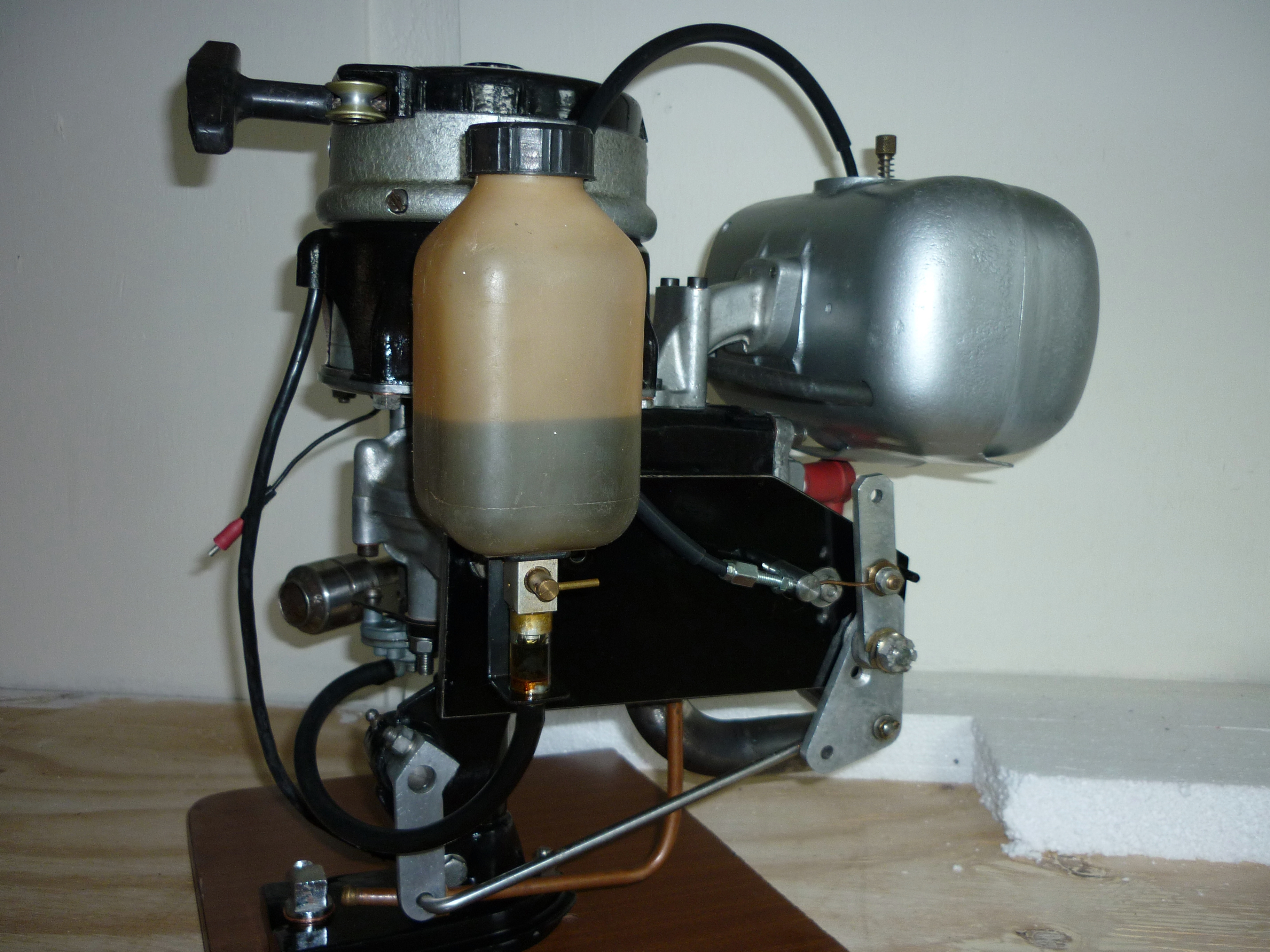

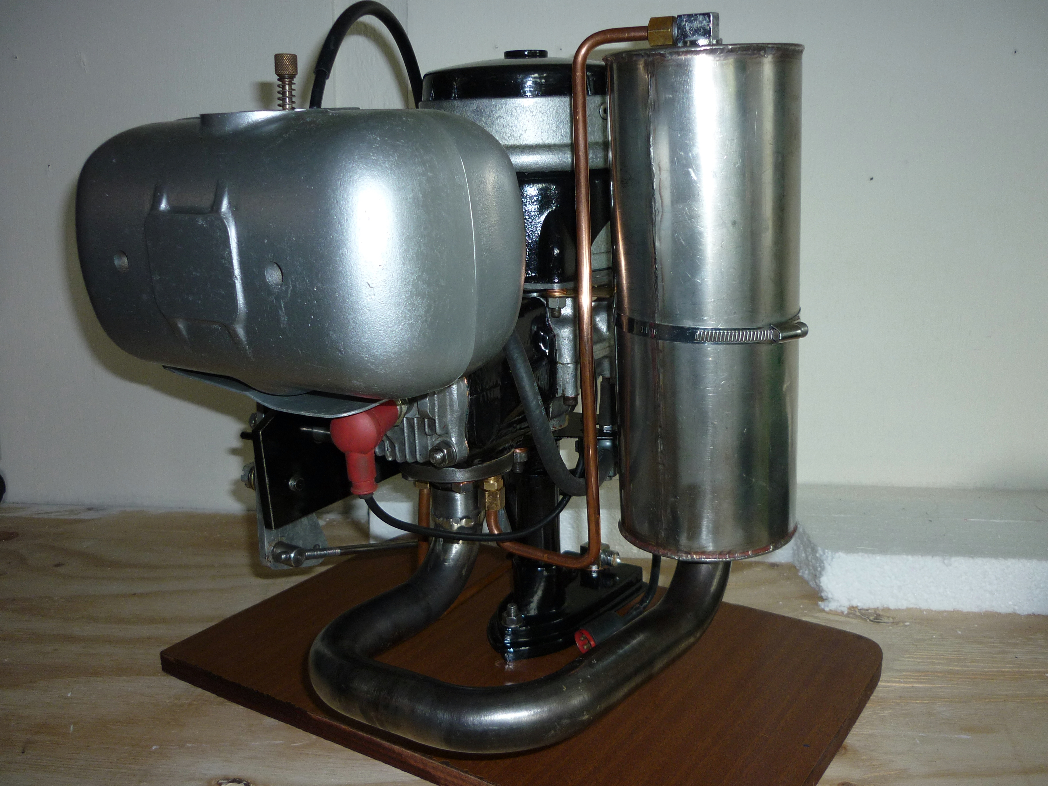

alan adkinsd1601 alan adkin sd1603  These two pics of a 160 inboard restored by Alan Adkin

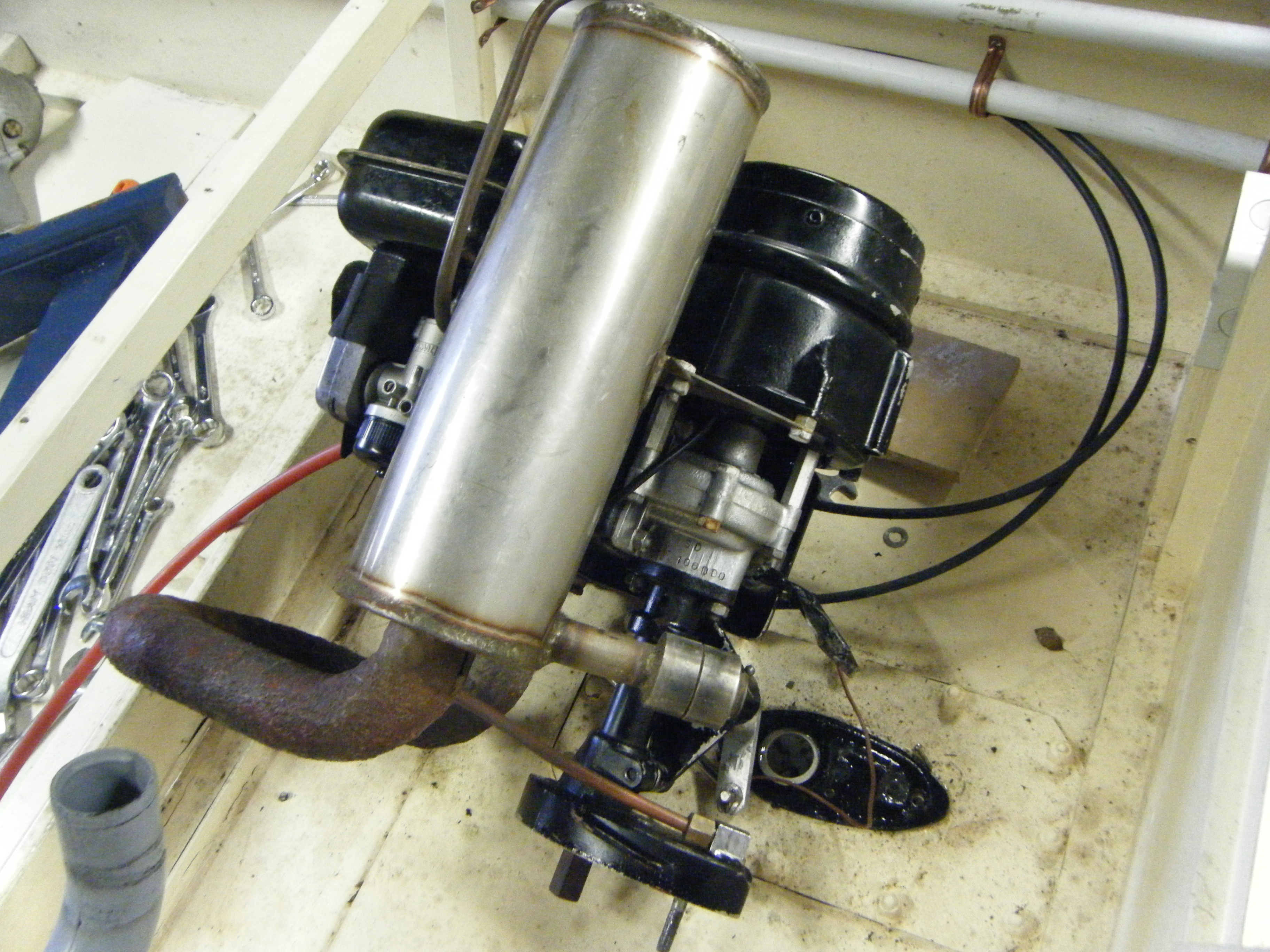

inboard British Seagull dscf1179  Inboard found in a launch in Kent, may be salvageable......
