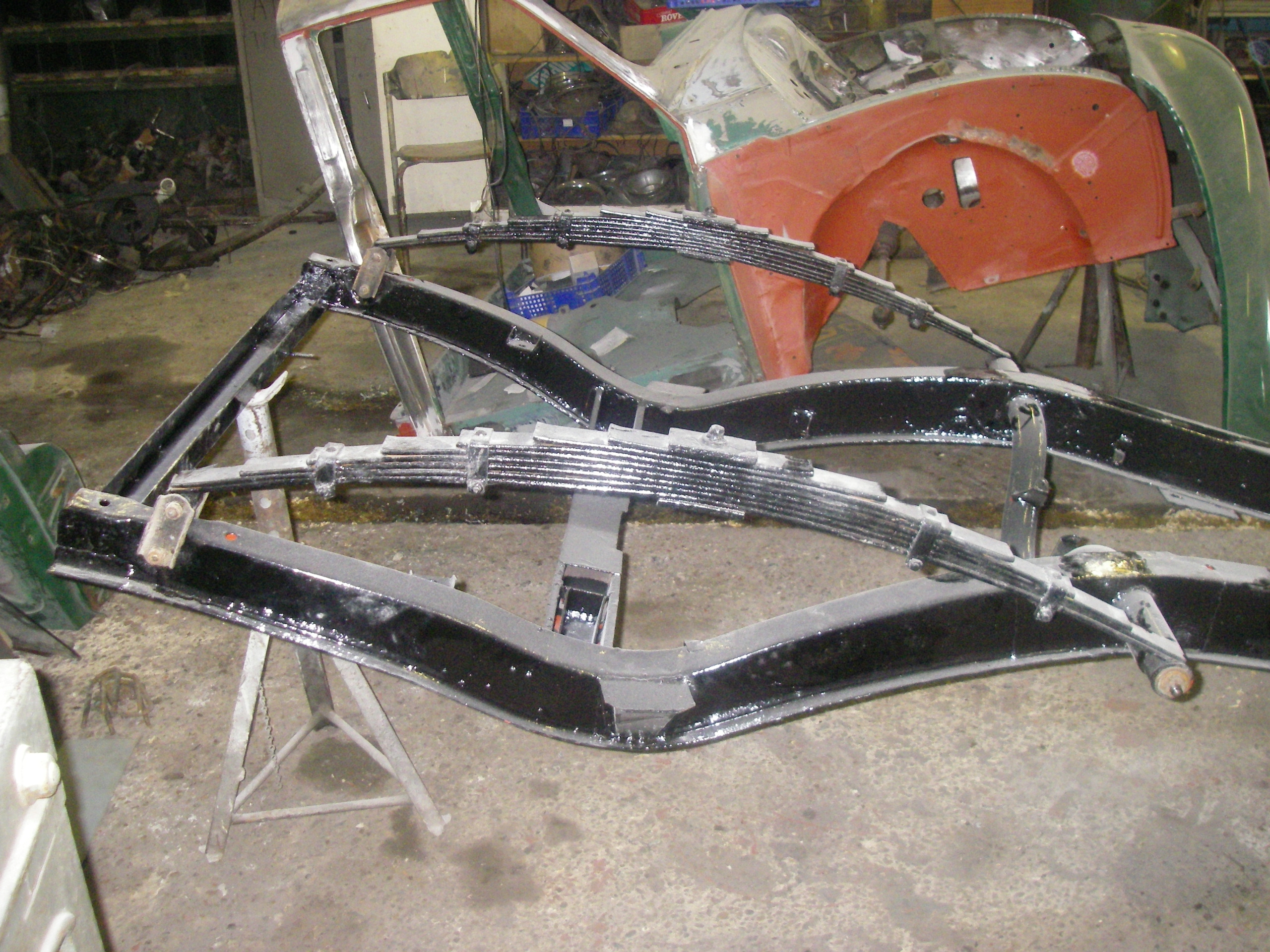

Pete was meticulous. The Moggy was stripped to a bare chassis, which was not in
that bad order. He showed me that it had not been properly spot welded from day
one the panels on the top of the chassis were only attached at the ends, not
every 3"! Must have given a bit of flexibility!
Fully repaired chassis.
A few repairs were made, bump
stops replaced, then it went away for shot blasting, which showed up a weak spot
or two that were cut out and replaced. Peter also blanked off the extra holes
that every chassis has, for left hand drive applications. A copious coating of
primer followed.

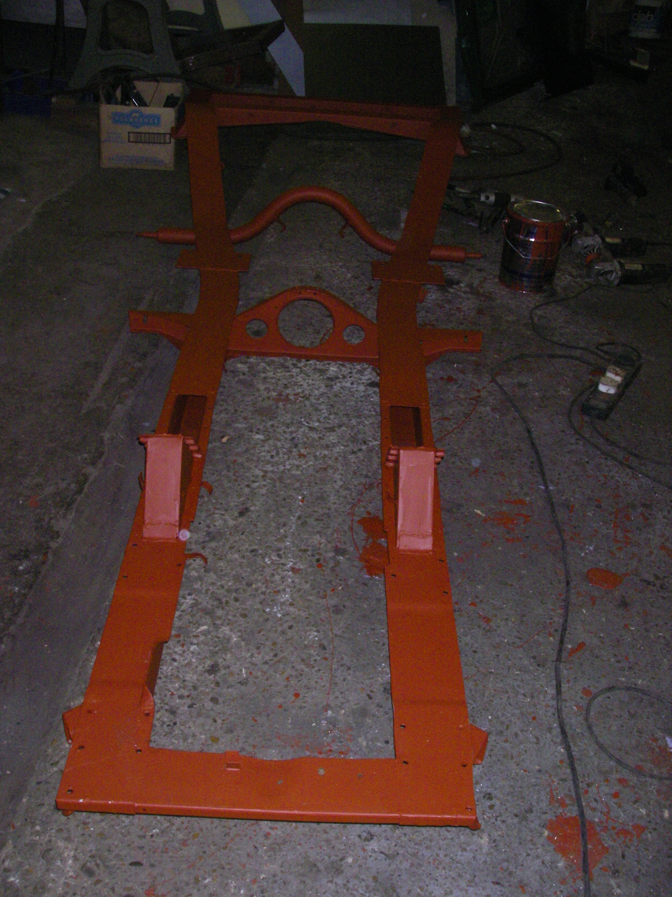

Chassis in primer
Eventually the fully welded chassis was sprayed with super black sticky stuff,
the likes of which the local army Land Rovers get coated in. The box sections
were then filled with gloop and all allowed to set.
Upturned chassis with springs, painted.

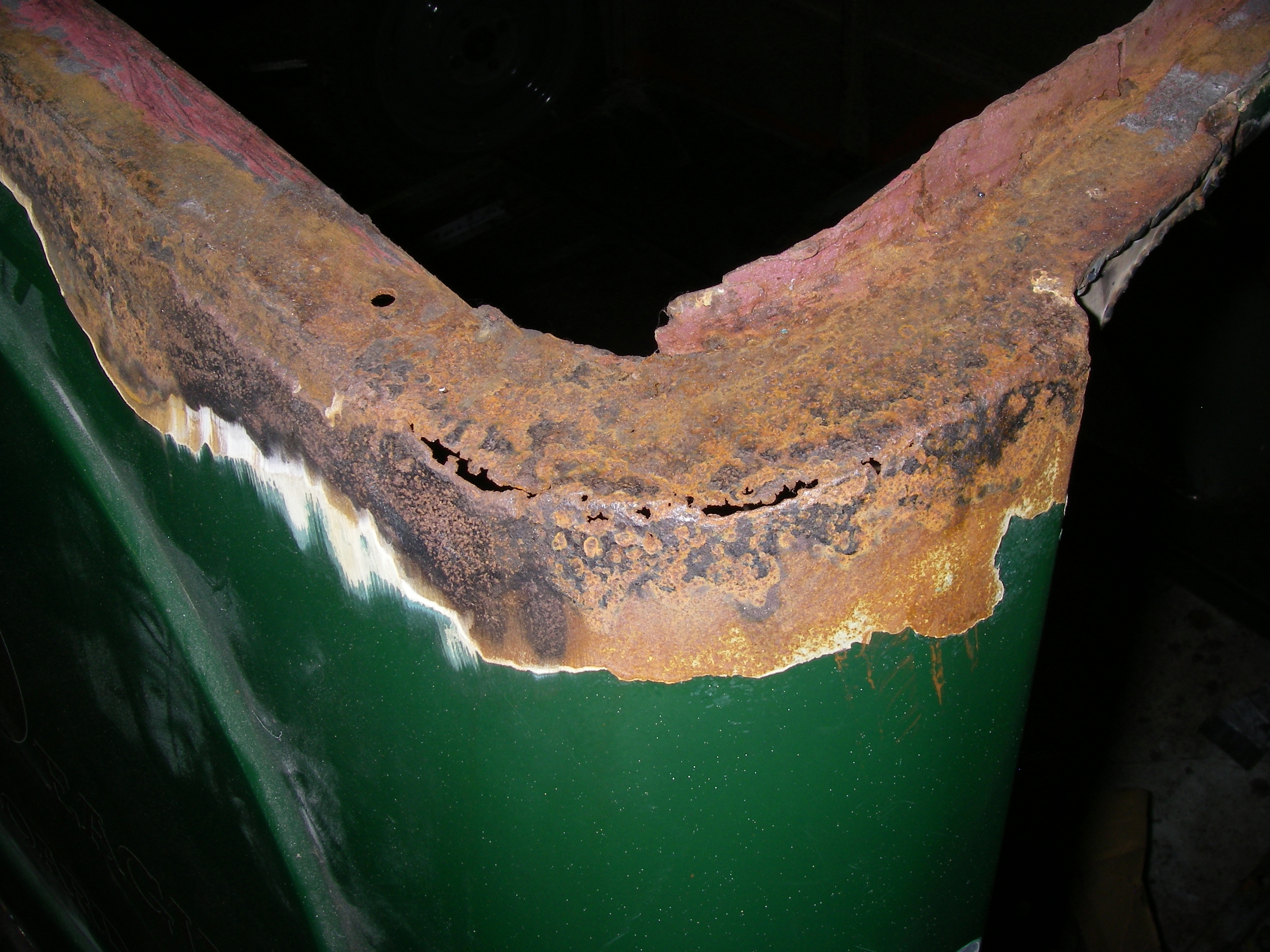

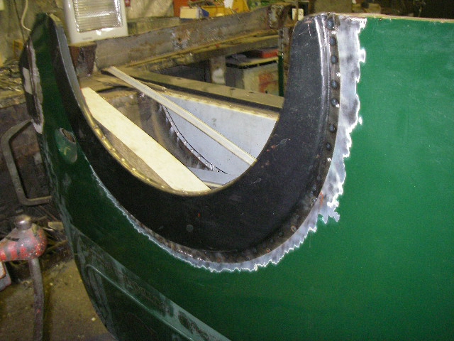

At the same time, the van back was removed and was being rebuilt. I had fitted
one of the first GRP roofs to her 10 years or more ago, this was removed to
reveal that the sealant had corroded the metal, so needing another repair.
The badly corroded metal flange supporting the roof

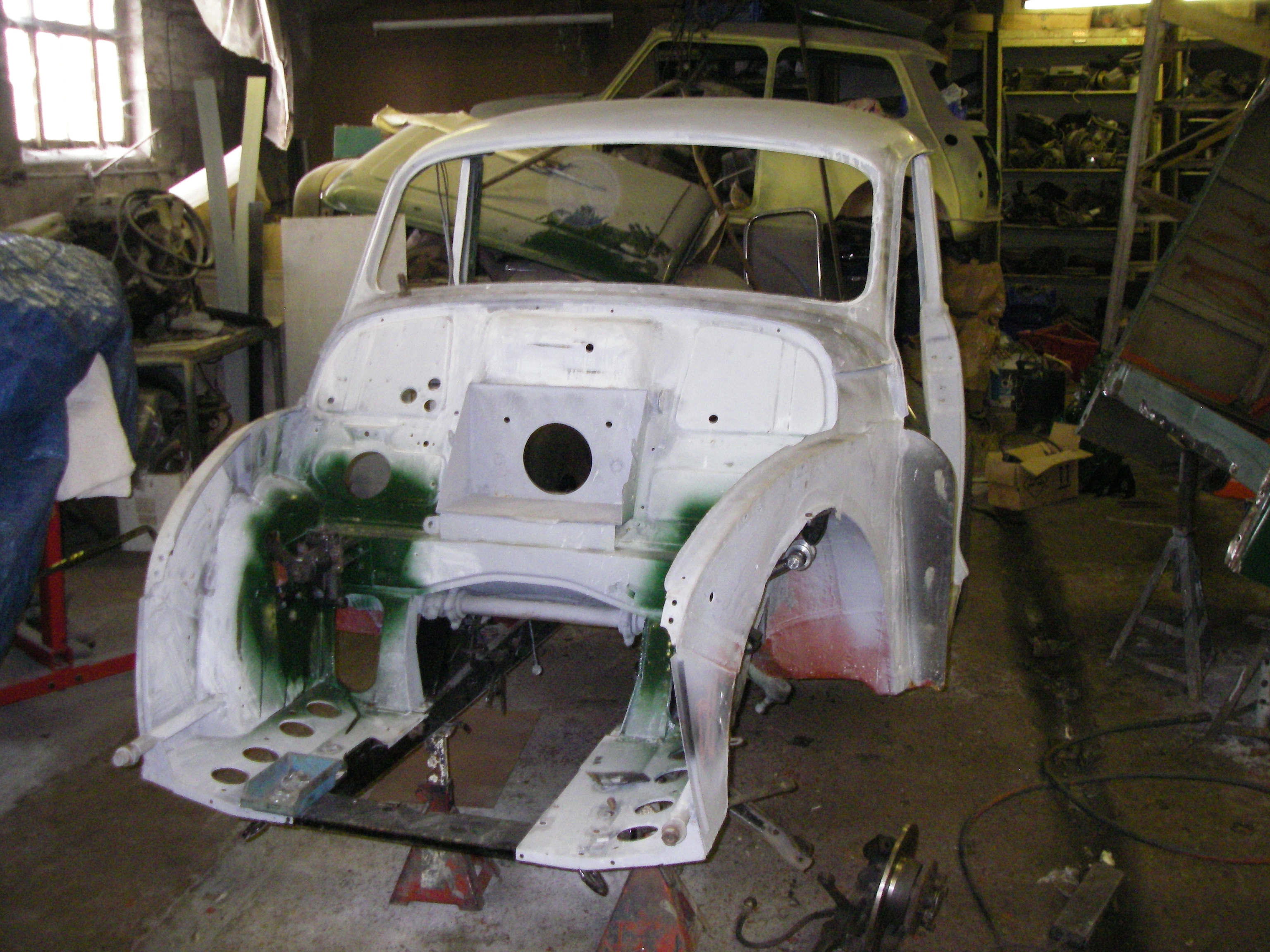

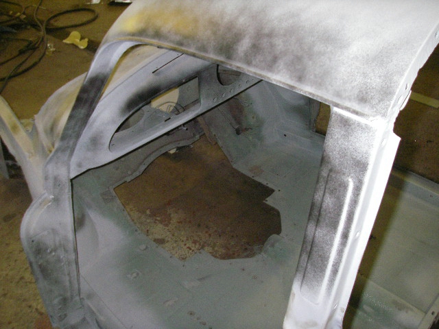

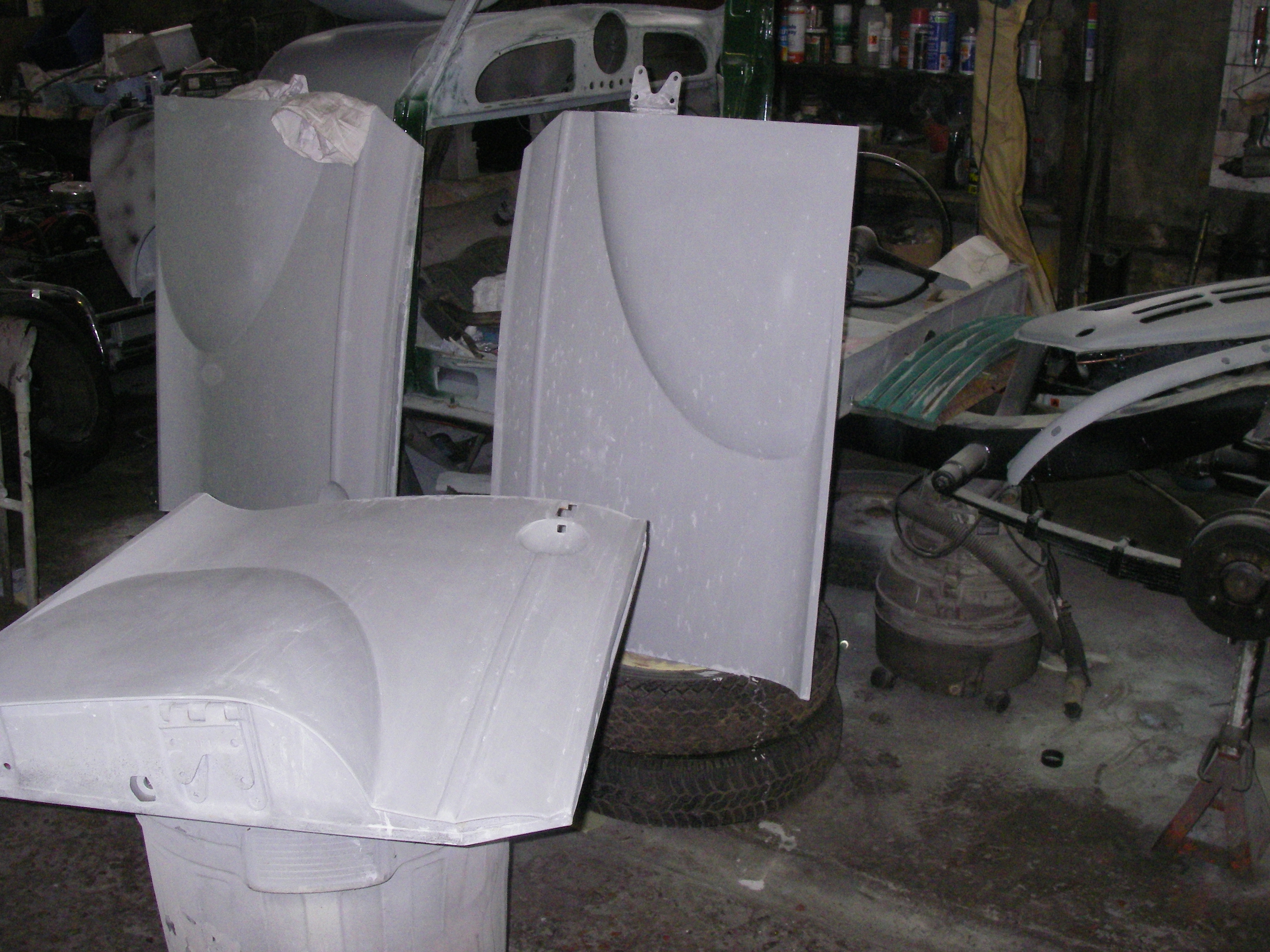

Inside the cab, repaired and in primer
New panels fitted to rear wheel flares
At the front end some panels were fine, others swopped for better ones Peter had
in store, and others for new. There was a certain amount of trepidation as the
back was very floppy at this stage, so temporary struts had to be fitted and
frequent checks to ensure square. All new fixings were used, including some
specially made in stainless for the rear doors. Look smart! Peter looked at the
rain gutters on the cab and removed them, making smart new ones to replace them.
New gutters fitted
Here Peter has Maddy nearly 100% in primer.

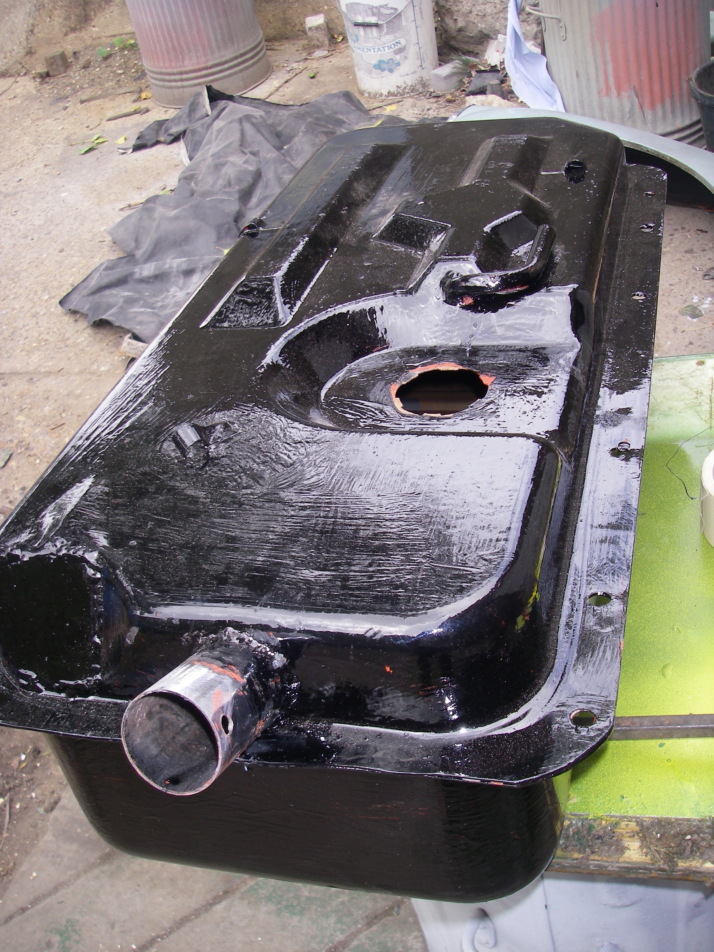

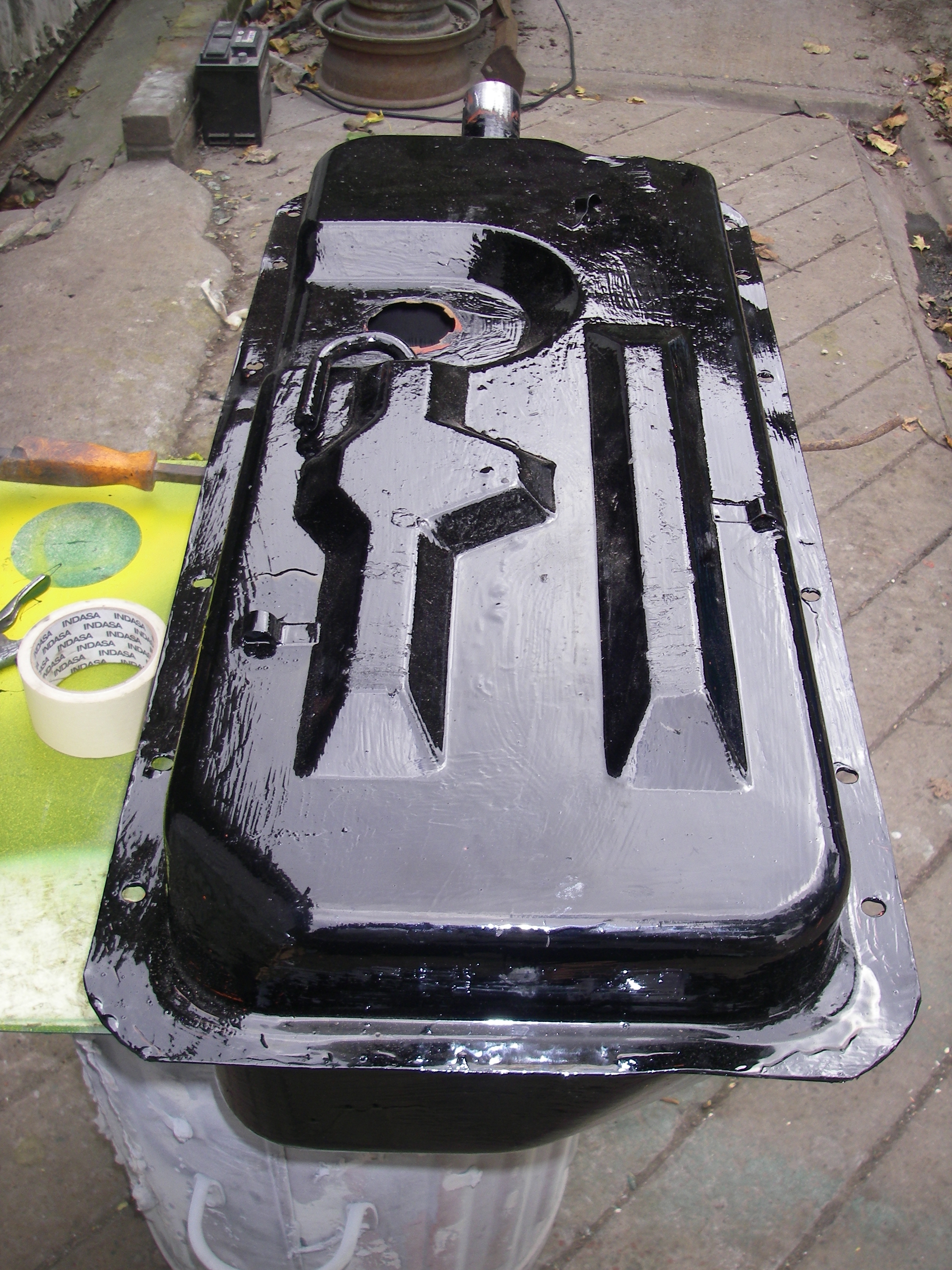

Peter also had a new 9 gallon fuel tank from an Escort, that he modified to fit,
as the old tank was looking just a little too rusty….
Modified Escort tank, now 9 gallons capacity.

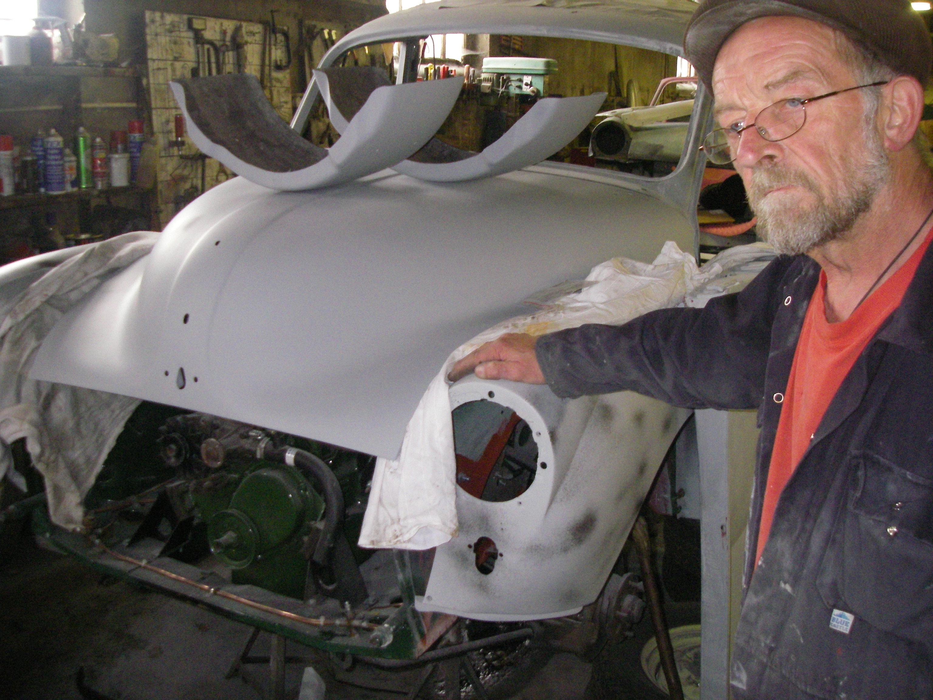

Motor re-sprayed and with porthole fitted.

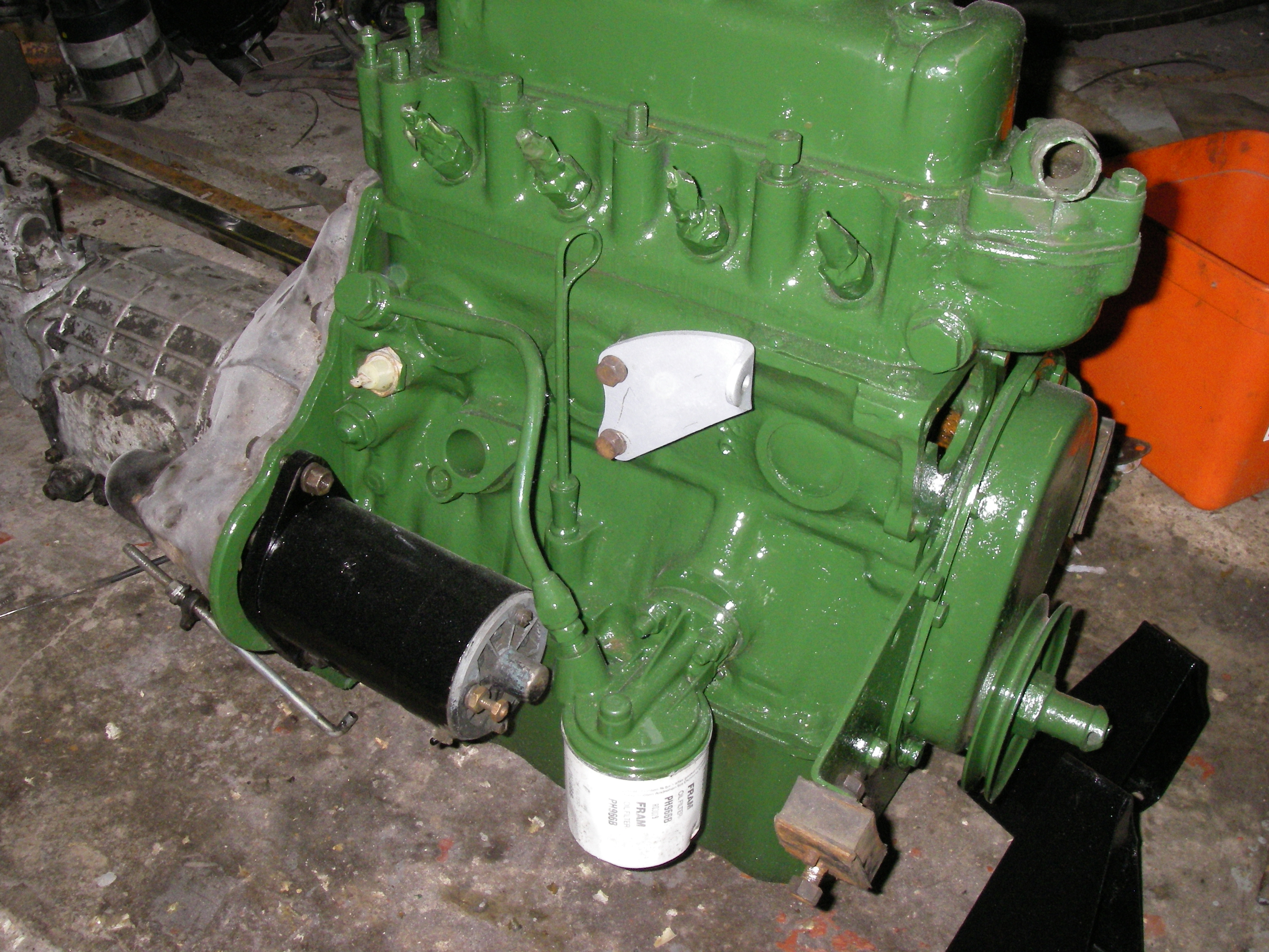

swopped the box. I have saved the motor for later. The old engine was already OK
so it was simply cleaned and sprayed up green again.
The engine has a lead free head of course, stainless exhaust and mini manifold
and carb. Ignition is electronic and the oil filter a spin off mini one, all
modifications tried and tested years ago. They were simply refitted.

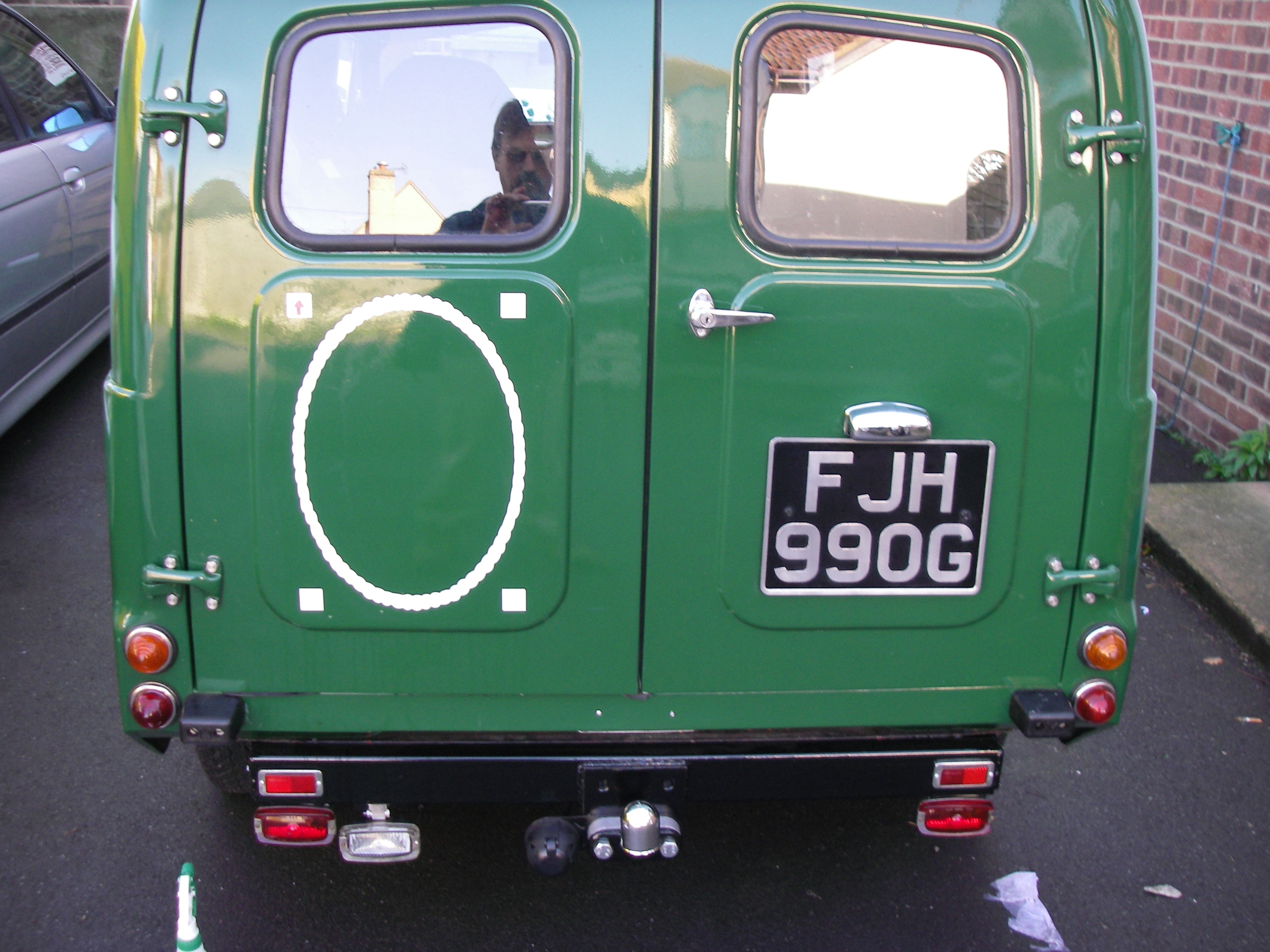

One of the final jobs was to fit a tow bar, so I could pull a very light dinghy
trailer behind her. My mobile British Seagull test bed! Again I was able to
supply all the electrical parts. Peter relocated the new number plate I had
supplied onto the offside rear door, with the new lamp I found. A very smart
job. I now had the 'old' plate as a spare for the trailer too.

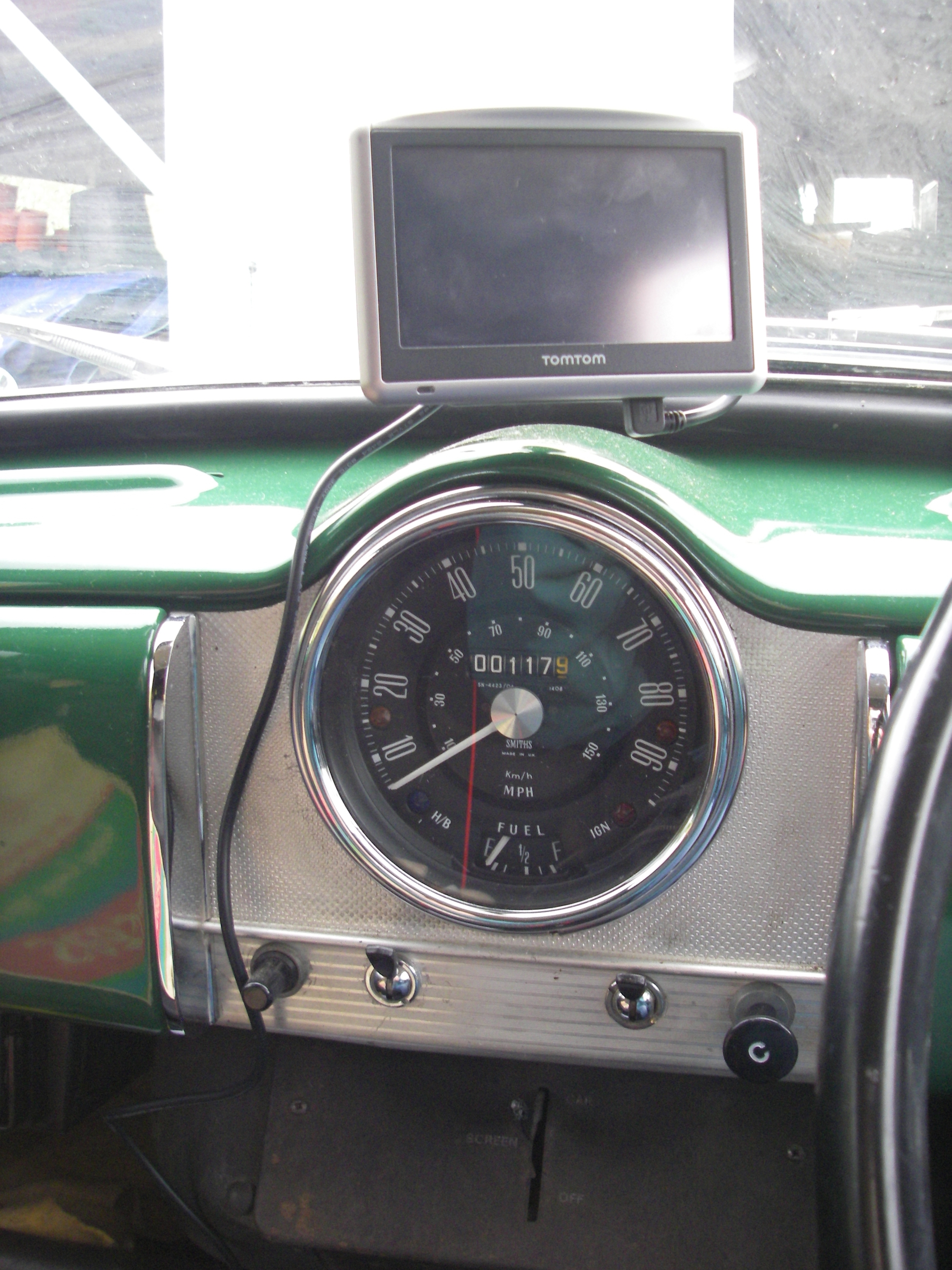

case. Scott fitted it, only to find the milometer did not work. I removed it
later and refitted the old one. Taking courage to remove the back of the new
one, not as simple as it sounds…. I eventually got to the working parts. It took
me 10 seconds to fix! Some clown in the factory had fitted the toothed operating
wheel back to front….. Now, with the new speedo, mileage starts again from zero!
I also have a GPS on board to help me find my way around Essex when I am
collecting or delivering my Seagulls. I also find it has far more accurate
speedo than the mechanical one, which over reads by about 10%!
Scott also fitted my radio cassette player, a job I had been putting off for
years, so I can once again listen to my music, if I turn it up loud enough… 1968
was a good year for music too!
New speedo and GPS! Ancient and modern.

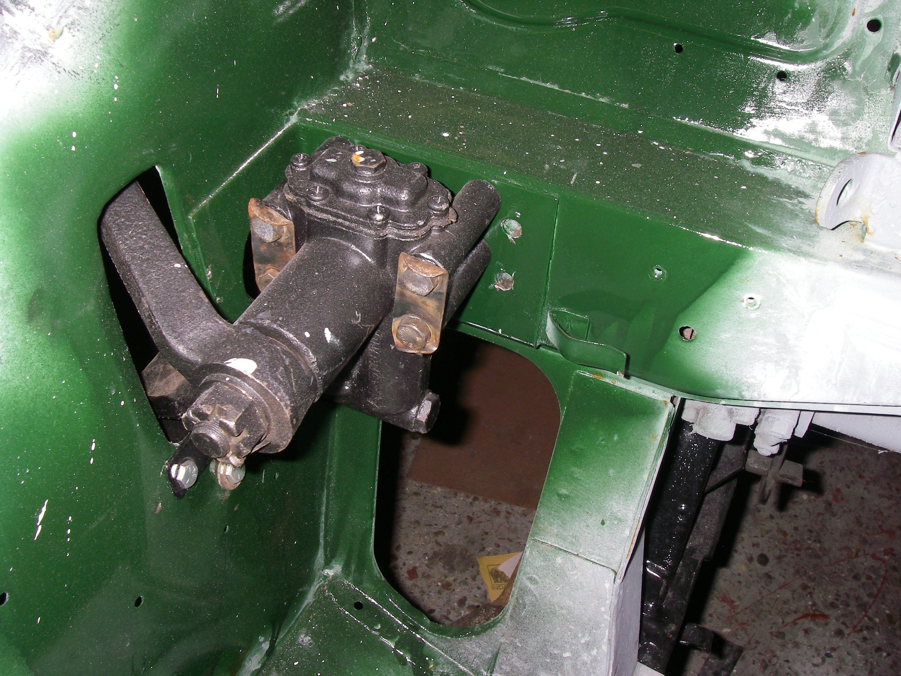

Peter fixed the stiff steering by lowering the torsion bar suspension, it had
looked ridiculously high at the front!. Simply the wrong geometry… The squeak
was still there, but I'm working on it. Bleeding the brakes again cured that
problem. Thankfully no more water leaks either

From the new hub caps on the freshly silvered wheels, to the radio aerial and
the tail lights, my Maddy was now in better order than the day she left the
factory 40 years ago. With discs and servo, anti roll bar and the small engine
modifications, halogen headlamps and tow bar, she was not only an eye catcher,
but useful to boot.

The next week I had the 'sign writing' done again. The same company that had
done it 10 years back still had all the signs saved on file, except this time we
would not need the 'O' in SOS' as Peter had fitted the porthole I had been
saving for 10 years! I was troubled about cutting the hole, but now it is done
it is stunning! Just have to keep polishing the bronze!

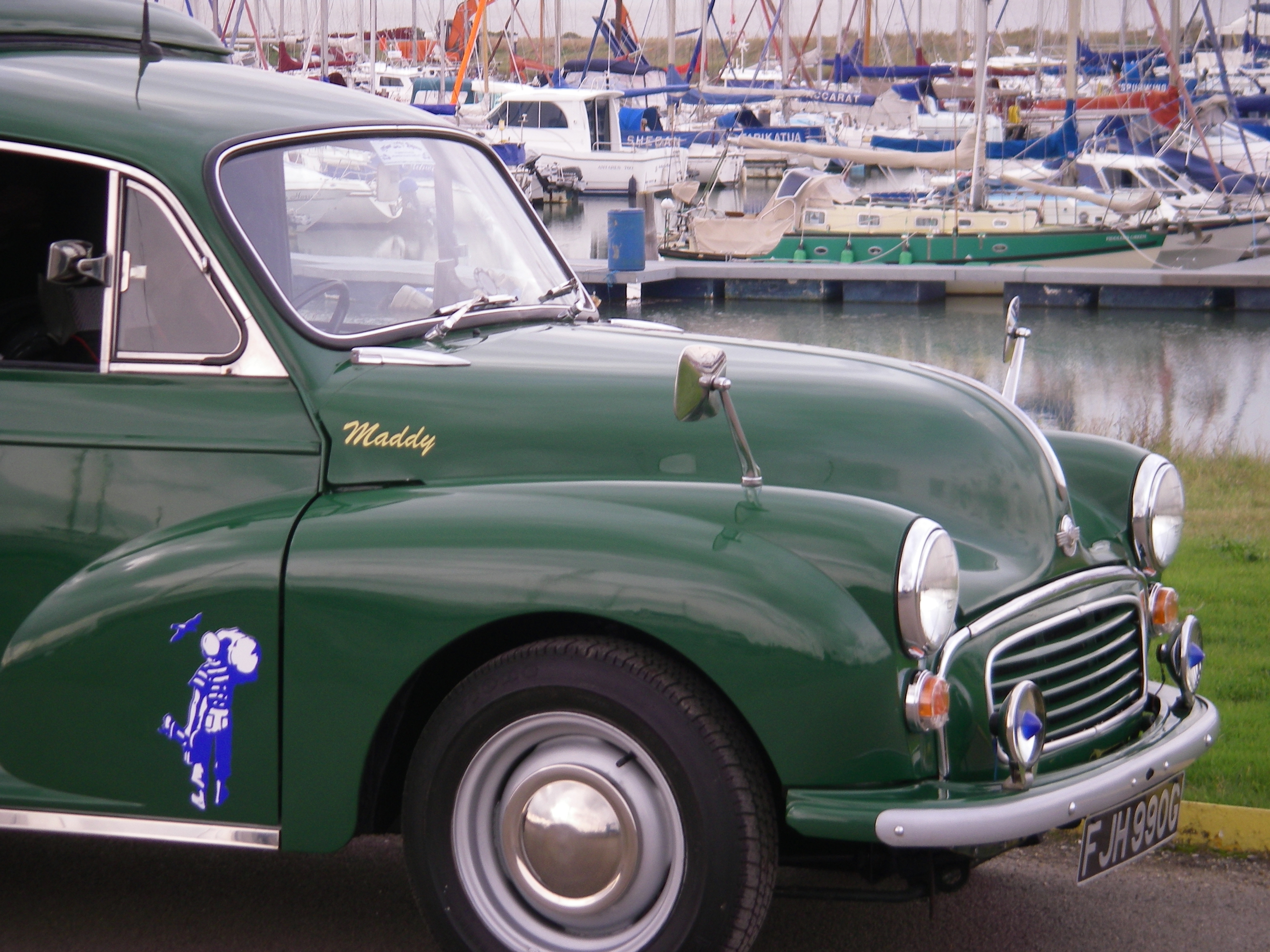

Late October, out of the workshop at last, posing at the marina.
I took her down to the Marina and posed her in front of the boats for a few nice
shots. The marina staff turned out to admire her. See the green boat in the
background, we like green, she is our home built wooden sailing cruiser….
Maddy with 'Fiddler's Green' in the background.

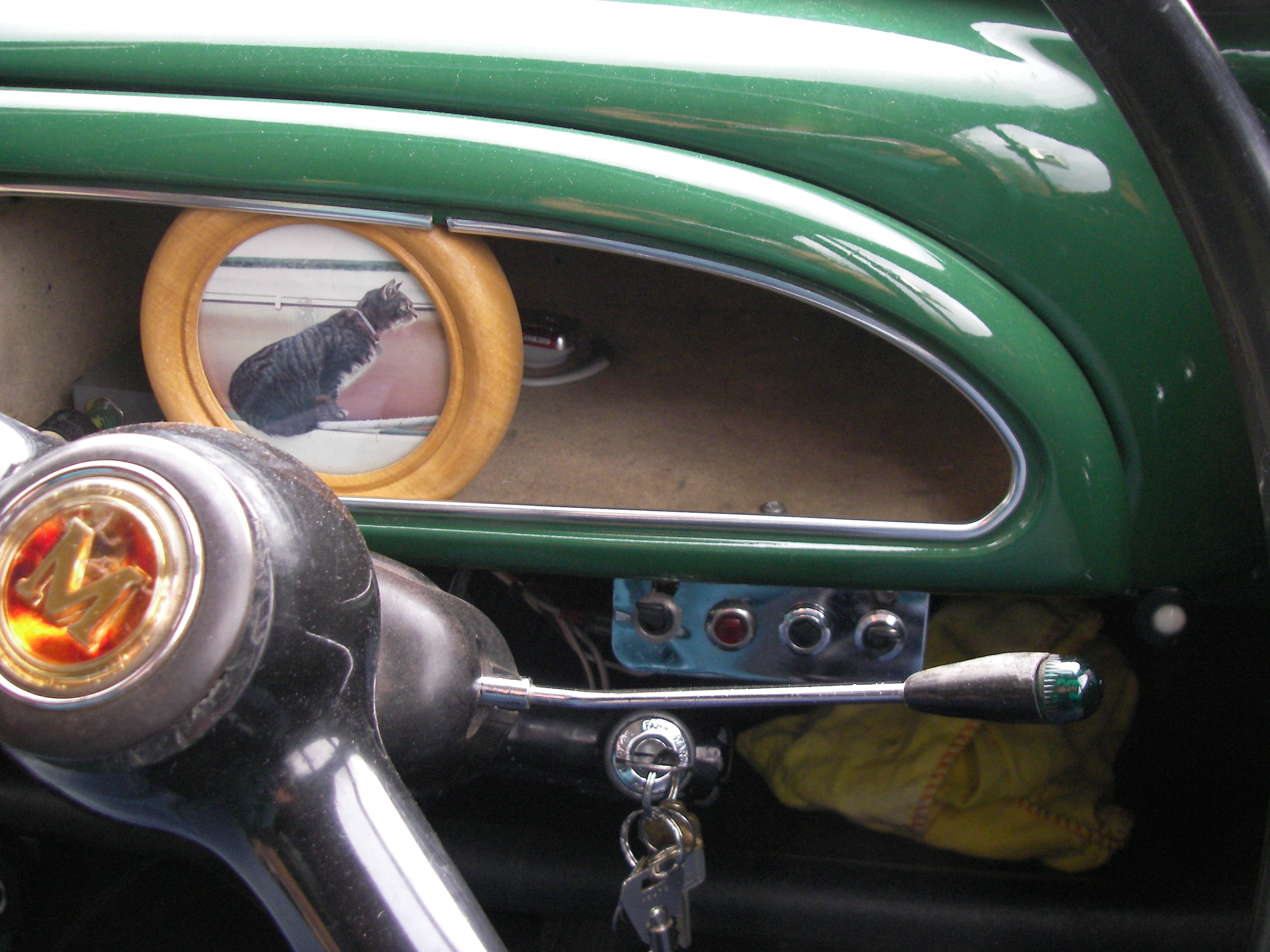

Why Maddy? Well she is named after a favourite moggy of mine, and her pic is
always in the cubby hole, sentimental old fool.
Maddy the real moggy
